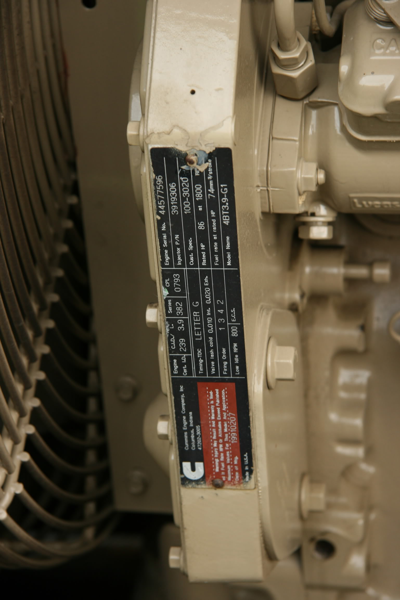

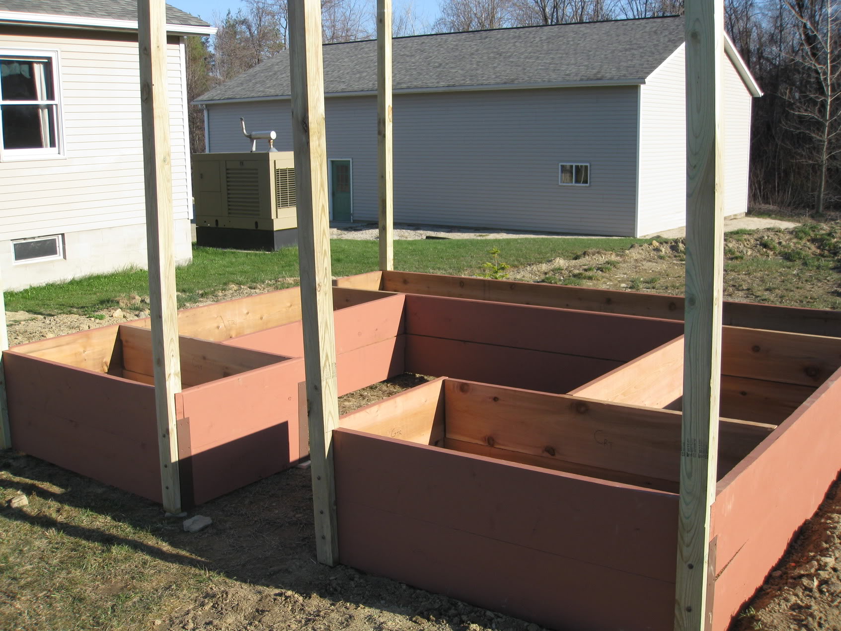

    I'm a new member, been lurking for several months. After introducing myself in the new members area, it was suggested I come here and ask if anyone has suggestions how to quiet my 50KVA diesel generator during a SHTF scenario. I've inet pics below:
    Generator is seen behind the garden bed (left) with my barn in the background:
    Here are the details:
    It has a 100 gallon tank, good for about 4 days of continous operation. It runs 20 minutes a week to keep everything running.
    Any ideas or suggestions on how to quiet it (it is very loud!)

    You may have to run the exhaust through multiple drums but what is really going to attract attention is the large flat walls of the garage and house that are going to reflect both the engine noise and the exhaust. Look at erecting some privacy fencing that has looks like below plus overlapping slats will help out too.
    or any shape that does not have smooth flat reflecting surfaces.

    Your observations about the house and barn reflecting noise are very astute, it almost magnifies the noise.

    The first thing I would do is to move that thing to another location that is NOT between two buildings. That would reduce the amplification affect of the buildings. Then I would do what BTPost said. But moving it away from the house would be the 1st thing I would do.
