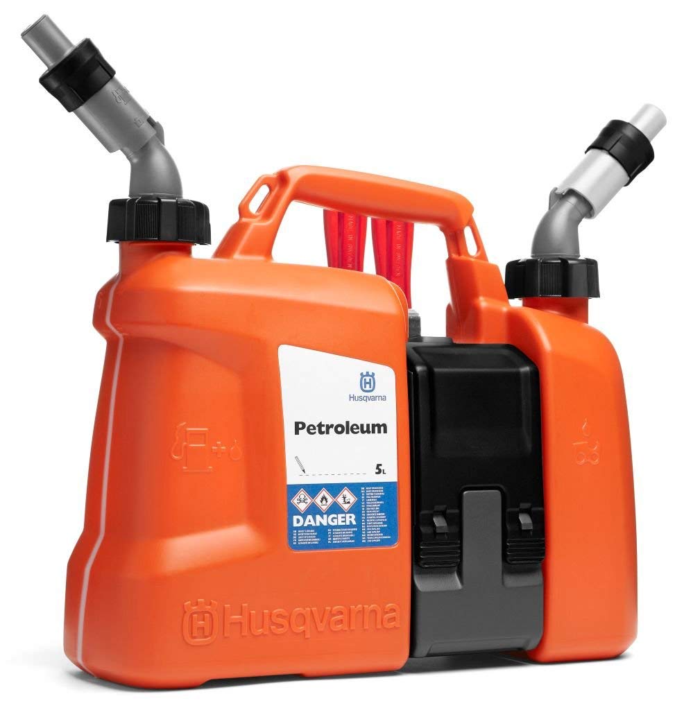

    BTW, if you're hunting a really good gas/bar oil combo can, this Husquavarna one is top notch. Holds 5L of gas, 3L of oil, and has a nifty tool compartment in the center for files, bar wrench, wedges, etc. $30.50 at Amazon.

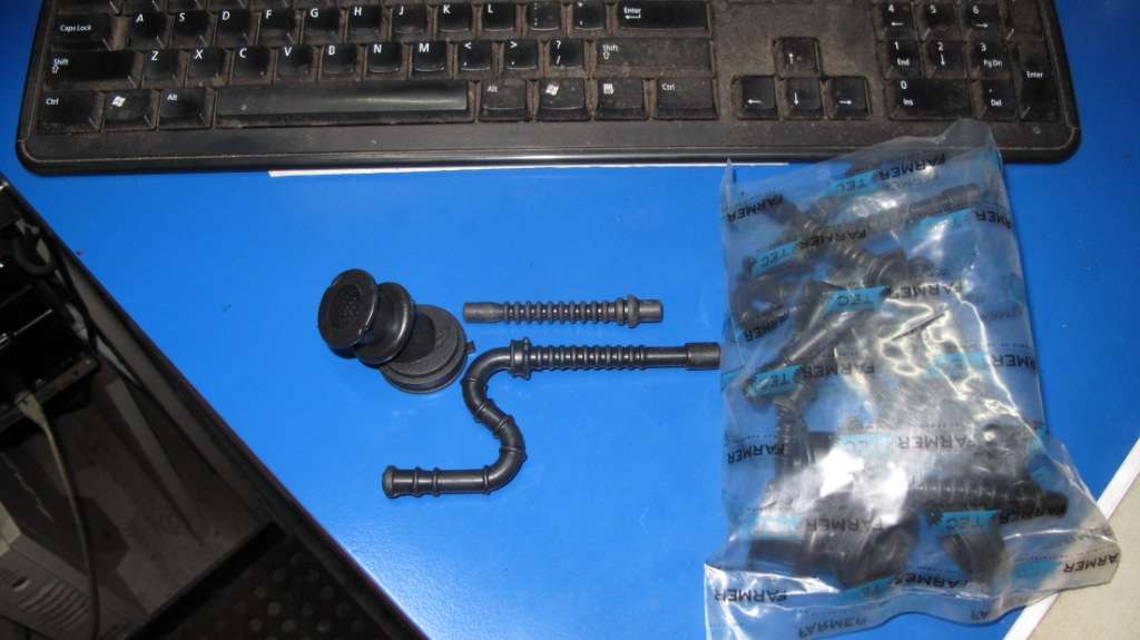

    There is the fuel pump crankcase feed pulsing tube that I replace on those when they start acting goofy while using them .
    It is so hard to see the pin holes , but that is why I pick them up so cheap . IMG_2304.
    PULSE HOSE IS STRAIGHT , s one is fuel pickup , and carb to intake port is the wearing items I replace .
    I have a bag full of them for 026,260s,290 and also for the small one handed trimmer saws . I figure that if SHTF then parts will be hard to get till .
