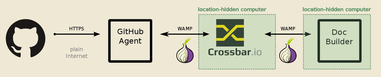

    Ordinarily, accepting such an HTTP request and rebuilding the documentation would be straightforward. However, an onion service is trying to hide its network location – giving GitHub some way to call this directly would reveal its location. Instead, we will run an agent on a public IP that listens for GitHub WebHook requests and forwards them as “publish” events over Tor to the Crossbar.io router. There will be another agent connected to the router that will subscribe to these forwarded GitHub events. This second agent rebuilds the documentation that is served by the txtorcon onion service.
    There are three parts in the above diagram that we will deal with here:

    Crossbar.io is a Twisted application that provides a robust implementation of a “WAMP router”, routing RPC and PubSub messages between various connected clients. It supports many transports (stdin/out, Unix sockets, TCP sockets and WebSockets). For our purposes, we will use WebSockets over Tor, which Crossbar natively supports.
    The complete details of Crossbar.io setup are in the `companion blog post`. The result of this is that the `Crossbar`_ router will use the ADD_ONION Tor Control Protocol command to add a new service to a running Tor instance. It will then be listening as a Tor onion service on a WebSocket URI that looks like ws://m6dazoly4sqnoqrm.onion:5000/.
    The two clients we will write will then use this address to connect. Because onion URIs are self-certifying (see “step two” of Tor’s onion-services description) each client can be sure they’re talking to the correct Crossbar.io router.
    The GitHub (WebHook) Agent
    Although Crossbar.io has native support for turning WebHook-style requests directly into WAMP “publish” events, we don’t want the crossbar router itself on a public IP address. (One reason is because the private-key of our onion service would then be on a public machine). Therefore we have a simple service that listens on 443 for HTTP POSTs from GitHub and connects to Crossbar over Tor to the onion service (“GitHub Agent” in the diagrams).

    The documentation builder will subscribe to these topics and trigger builds when the source code changes. The setup will include a WebSocket connection via Tor onion service (speaking WAMP) and a web server listening for incoming GitHub WebHook POST requests.
    Again, see the `companion blog post` for the full details; we use a Klein web server and txacme to get a (free!) Let’s Encrypt certificate for our server. So we accept TLS connections and verify the GitHub signatures before publishing any valid events as a WAMP “publish” message.
    Building Documents
    So now we have: a Crossbar.io router on a private machine and a WebHook agent on a public machine. The Crossbar.io machine is connected only via Tor, with no incoming connections allowed (all Tor connections are outbound).
    The next step is to add the agent that actually re-builds the documentation on the machine serving the txtorcon documentation. This machine also is connected to the outside world only via Tor. This agent will connect to Crossbar.io via Tor and listen for “publish” events – that is, the GitHub WebHook announcements that are now being turned into WAMP “publish” messages.
