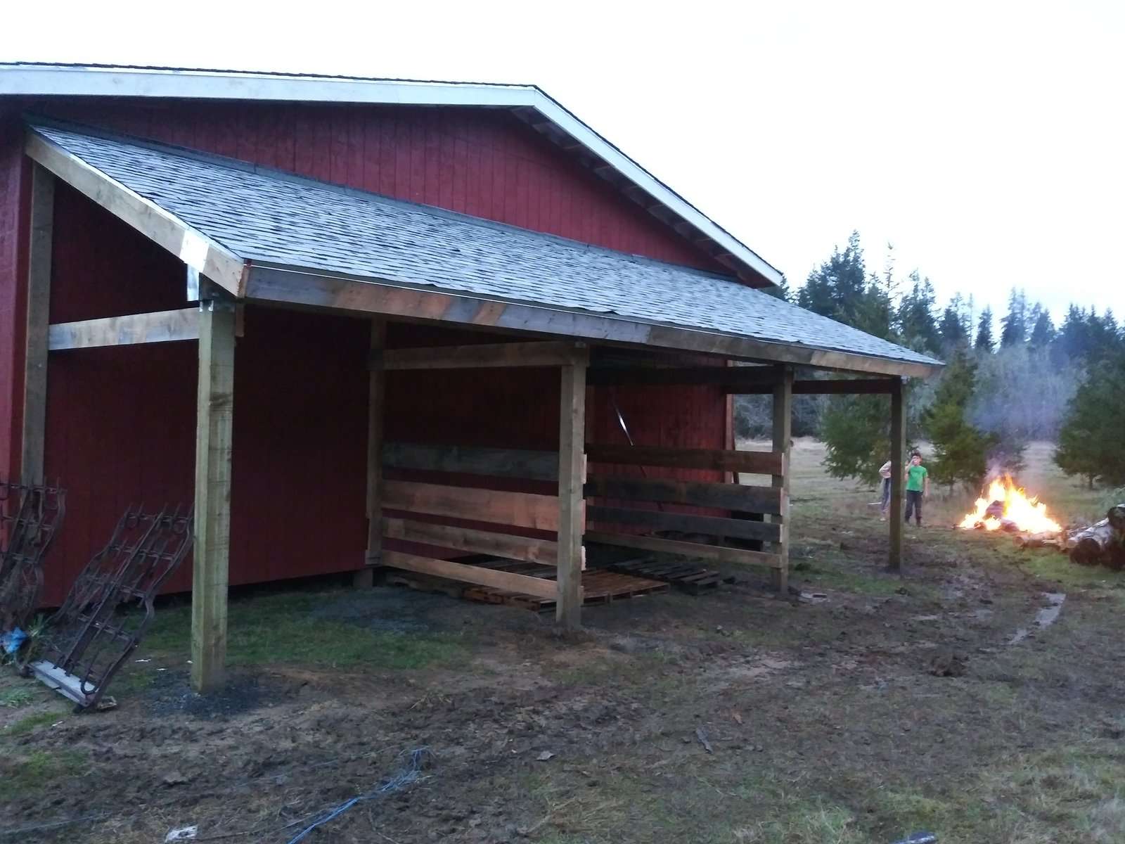

    I am about to put up the first building on my new property. It will be a simple covered hay shed. I am looking for issues to look out for before I start. I figured many minds will have many screw ups to warn me about.

    Ok I am building a hay and equipment shed. One end will be closed on three sides for actual hay storage. the rest will be an open area for equipment storage. It will be outside of the fenced grazing area for live stock. This is southwest Washington so I need to keep stuff out of the rain and a nod to BT I was here for the 2006 storm with 100 mph gusts.

    Been a while but its done, Thanks for all impute
