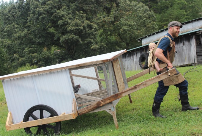

    I saw this neat mobile chicken coop whilst browsing permaculture sites....the picture is linked to a permaculture site with materials lists and illustrated step-by-step instructions for its construction. It's probably a little large for the average suburban block...but it would make tractoring a small acreage a breeze.
    Via: Finally, a Mobile Chicken Coop One Person Can (Easily) Move - Abundant Permaculture

    Meh. too ugly and too heavy.
  3. chelloveck
    I think the guy had functionality in mind rather than aesthetics....It should be reasonably light. I doubt he's using hardwood in the build. The Chinese would probably whip one up in bamboo! ;)

    Most people start off with 2X4s, and wind up with a chicksaw too heavy to move. And they usually crowd the chooks--who need at least four square feet of scratch space to be happy, into two sq. ft. or less.
    When I started keeping chickens again, a few years back, I studied chicken tractors in depth and then designed one from scratch for easy low-cost construction, easy maintenance, and good looks. It housed six hens, had two nest boxes, and could be built in less than a day for about $50.00 (plus paint). It looked good, and it could be moved by a 10-year old.
    And then I designed an truly unique low-cost covered run to use with it (about 120 sq. ft.) because chickens like a little extra space. And the run can be easily moved by one adult or two 10-year-olds. And it only costs about $50.00 to build, too.
    The building time for both (together) is less than a day, which makes setting up for backyard chickens a super-easy weekend project.
