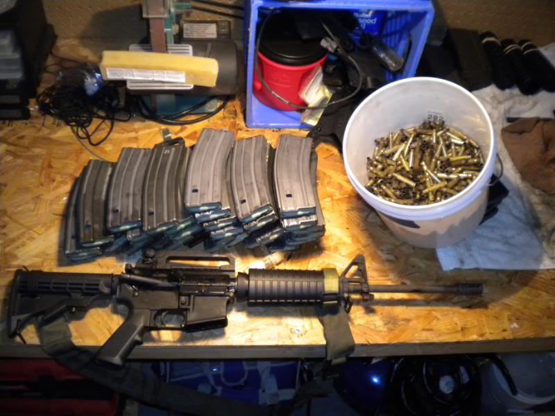

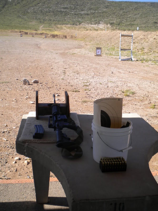

    2 JUL test- First off, the number of rounds available to me for the initial test is 900 rounds. These are old reloads that I made up some 10 years ago. They are hot loaded Winchester 55 grain FMJBT bullets that are closely matched to the velocity of XM193. The conditions are a typical Southern Arizona day. Dusty, dry, windy, and bright.
    Preparation- No cleaning required. I simply oiled the BCG with a good coat of oil, loaded up all the mags (thank God for stripper clips) and headed out.
    The test- I started by confirming zero with a mag of FCXM193. After confirming zero was still on, a testament to an iron sighted carbine, I fired a magazine of the reloads to see if the zero was close. Satisfied that the steel silhouettes wouldn't know the difference, I begin shooting up all the reloads. The SV range here has steel set up to 500 yds. Today's test was out to 250 yds. It was rough getting started since I haven't fired a carbine in about 2 months. After awhile I was ringing em' dead no problem. Total time at the range.. about 2 hours. That's 450 rounds/ hour. Taking into account random cease fires and you can understand how smokin' this little carbine was.
    Malfunction- the only malfunction I had during the duration of the test was a stuck case. It stuck after 20 magazines (600 rounds). Upon opening the receivers I saw a bulged primer. Likely a reload problem (a little hot). One light tap with a cleaning rod and I was back in business. I did drop a capful of CLP on the bolt and work it a couple times to ensure I wasn't drying up. There were no more malfunctions for the rest of the test.
    What I didn't like- This DPMS LPK gives me a bit of trigger slap. After 900 rounds my dang finger hurts. Never had that problem in an <acronym title="AR-15">AR </acronym>before. I think I will go ahead and upgrade to a set 4 lbs combat trigger instead of just changing out the FCG. It would be a good upgrade to have anyways.
    Lessons Learned- Watch your reloads. A bit hotter and I might have been in trouble. No fault of the carbine, though. Even if you factor in the malfunction due to the reload, if you can shoot 2.85 battle loads.... you have the reliability needed in the platform. If you write off the reload, you can shoot at least 4.28 battle loads of ammo without a malfunction and with minimum maintenance.

    3 JUL 2010 Update- Thinking about a Geiselle trigger. They are uber reliable from the reviews and have a great break from my understanding. I'm not sure how I feel about a 2-stage in a standard carbine, but I am willing to give it a try. If I don't like it, I will drop in the original OEM parts and put the Geiselle in a DMR-type carbine I built.
    Geissele AR15 Super Semi-Automatic Trigger

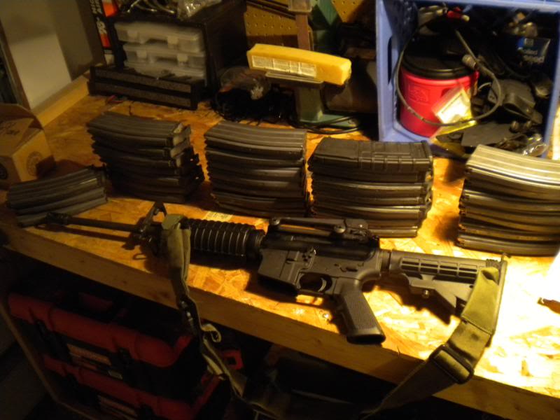

    I have also decided to change the lower receiver out. It wouldn't drop free the P-mags I had. I have another laying around to replace it with, so no biggie. Everything else will remain the same and I will update the specs above. The upper receiver remains uncleaned.
    I added double heat shield handguards.... my hand got a little hot a couple times during that last session.
    ETA: trigger is ordered along with the BCM extractor upgrade... new spec spring with o ring. I will post more about this later when I do the install.
    10 JUL 2010 Update- Completed the install of the Geissele trigger and extractor upgrade. The trigger is awesome. I would say it breaks at a crisp 4 lbs. Maybe a bit less. The quality is obvious in the fit and finish. It's leaps and bounds above a stock trigger. The first stage is short. Not like the M1A two stage triggers. The second stage is light. The lock time feels lightning fast. The best part is simplicity. It keeps the simple original design. No set screws to worry about. No adjustment necessary. I was thinking about getting an adjustable trigger for my "varmint" rifle. Now, I think the Geissele two stage is enough.
    The crane o-ring extractor upgrade is installed. It was a bit of a pain to install the first time. From what I have read, that is normal. I cycled it a few times to ensure it would at least cycle round manual without fail. I need to test fire it at the range to see for sure. I may be able to run a couple hundred round down range this weekend.
    18 JUL Update- I was able to get out and test the BCM extractor upgrade and Geissele trigger. The ammo used was Remington green box .223. Not the most powerful, reliable, or accurate ammo available, but there were zero stoppages. Number of rounds fired- 100 rds. If you are keeping track, that is a total of 1000 rounds fired with zero cleaning. I forgot lube, so I improvised. I keep a quart of oil in the back of my truck. A half a cap full added to the BCG and some manual cycling was the only thing done before shooting. This just goes to show you that as long as you oil it, it doesn't matter what you oil it with. In a SHTF scenario, you could pull out your dip stick and finger off enough oil to coat the BCG. They like to run wet. At 1000 rounds with no problems, the thing that is keeping this little carbine going is the oil.
    The trigger- wonderful. That is all I can say. It takes a little bit to get used to the 2 stage when firing an <acronym title="AR-15">AR </acronym>if your muscles remember a single stage. At the end of the 100 rds, this was no problem. It breaks crisp at what I believe to be a hair less the 4 lbs. I wish I had a trigger scale to be sure. No trigger slap was noticed as with the DPMS FCG. This is the trigger I want in my precision rig.
    The BCM extractor upgrade- There were no malfunctions that warranted the upgrade. It was simply peace of mind. After the installation, there were no issues with extraction. No issues before, no issues after. I guess the peace of mind was achieved. The crane o ring and new USGI extra power spring were all upgrades that originated in SOCOM. The O ring is currently not regular issue. The extra power spring is. These upgrades to the extractor tension are due to the harder extraction that comes from a carbine length gas system. I have used regular extractor springs for years with no issues, but I figured I would give it a try. I guess I am relatively neutral on whether it is needed or not. I say, go with a quality BCG like BCM and you get the "upgrades" as standard. Then you can't go wrong. I have enough kits to equip all my carbines and have a few left over as spares. Total cost was like $30.

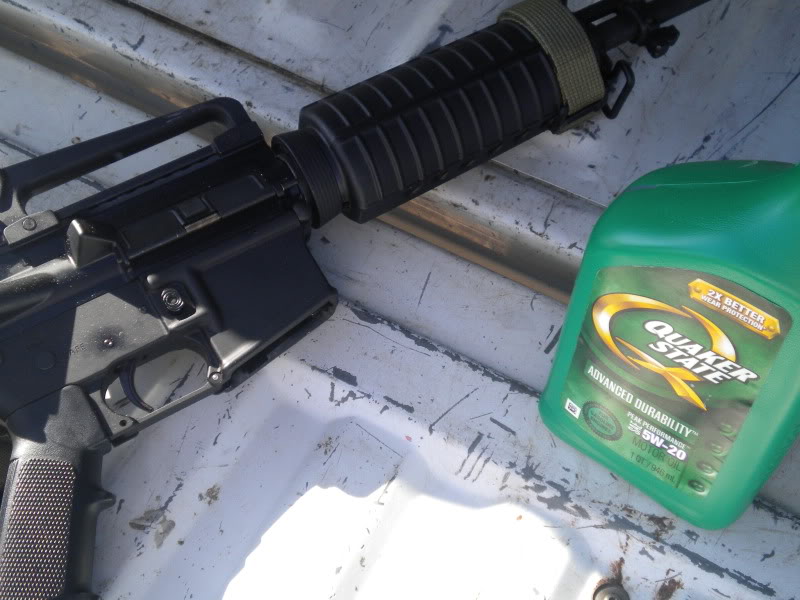

    High-tech lube:
    The SV range.... one of the best ranges ever....
    Test range was 100 yds, off the bench, iron sights....

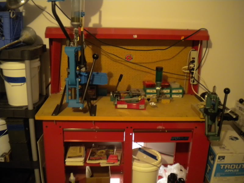

    3 SEP Update- Now that I finally have my reloading presses set back up (3 weeks of fixing broken parts and fighting through resetting everything) I was able to bench test a 55 gn load at 100 yds. At this point, this carbine has sit next to my bed filthy or rode around in the truck bumping over desert roads. No cleaning has been conducted to date. The last time it was fired was 18 JUL. Current round count at the beginning of this small accuracy test was 1000 rds.
    The test load was a 55 gn Win FMJ-BT on top of mostly LC brass behind 27 gns of Win 748. The primers are regular CCI SR primers. The components have been in garage storage since 2004. The purpose of the test load is to validate accuracy for mass loading of the remainder Winchester projectiles. The sights used were standard front and rear M4 sights. The zero was a 25M/300M battlefield zero (which accounts for the high POI at 100 yds). 15 rounds were fired with 15 holes on target. With some optics, I believe the group would have shrank considerably. Still, this group is great for a combat gun with a LW barrel and iron sights. Here are the pics:
    Here is the reloading set up:
    I am now thinking about optics. Given the LW nature of the barrel, I am leaning towards a LW point optic. I am looking at either an Aimpoint Micro or a Trijicon Reflex. The advantage to the Reflex is the Tritium power. The disadvantage I have personal experience with is potential wash out. The Aimpoint Micro has a long battery life, but is dependent on batteries. A little more thought has to go into this purchase.
    TOTAL ROUND COUNT AS OF 3 SEP- 1,015
    TOTAL CLEANINGS AS OF 2 JUL- 0
