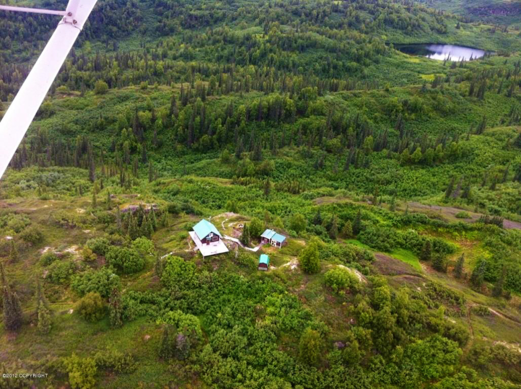

    Here is the layout.
    Ganado, kellory and RightHand like this.
  14. kellory
    Very nice.[winkthumb]
    Thought it was one building. You might check In to evaquated cylinder solar rooftop, water heaters. Your pump would send the water up, cold, it would come back down hot.

    That's one of the small lakes in the photo above. The big lake is this one (photo taken from my front porch looking ESE)
    And to give you an idea of the hill I sit on:
    Not a good cabin to own if your a sleepwalker.
