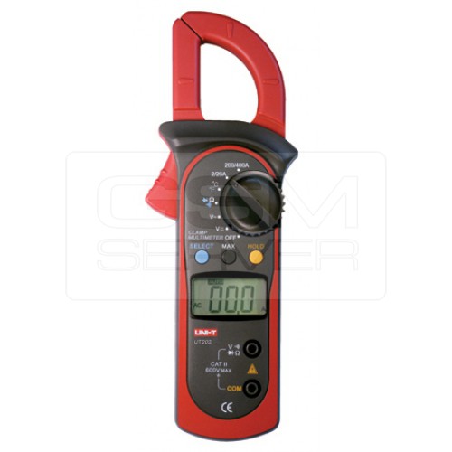

    Short circuit amperage from the panels SHOULD be 7.5 Amps. I am getting, at the panel connections on the back of the panel (as well as at the end of the cable run where it connects to the charge controller) 0.5 Amps. I reinstalled my original solar charge controller (old school indicators, not digital) and I see it reading the 0.5 Amps. What is keeping the panels from generating the proper amperage?

    BTW all readings are done with the UNI-T UT 202a Digital clamp multimeter.

    OK, we're getting closer, short circuit amperage [BOLD]SHOULD BE[/BOLD] 7.5 Amps, which means you haven't really put that meter in-line with the output and measured it? That meter will not read DC Amps with the clamp around jaws. Your controller is only reading .5 Amps because that is all that it is using.

    Forgive me if I'm out of step with this whole thing, but it happens I've blundered trying to read DC amps with both pos and neg wires in the clamp. That should, and does, read close to zero amps. I've not made that mistake since, and mention it only because I've not been following the discussion. I'm sure it's been addressed ---

    Nope @ghrit, it hasn't. I assumed the wires were individual.:rolleyes:

    I would also like to say, that contrary to what seems to be POPULAR belief, I know how to use, and read a Multimeter PROPERLY. I am reading SHORT circuit amperage, which is still just increased to .71 amps, and yes the meter is INLINE. I know HOW to use and read it.
