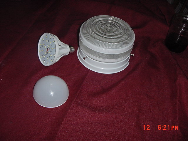

    5 watt? I would like to find 9 to 12 watt bulbs that look like the bulb in the picture above.
    I have 12 watt bulbs now but they are really big compared to the standard bulb.
    Like to find them to fit in a standard size to fit a standard light fixture.
    this is what I'm working with now really bright but just to big
