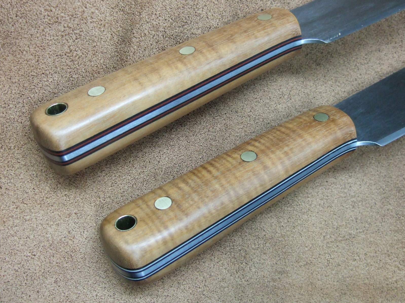

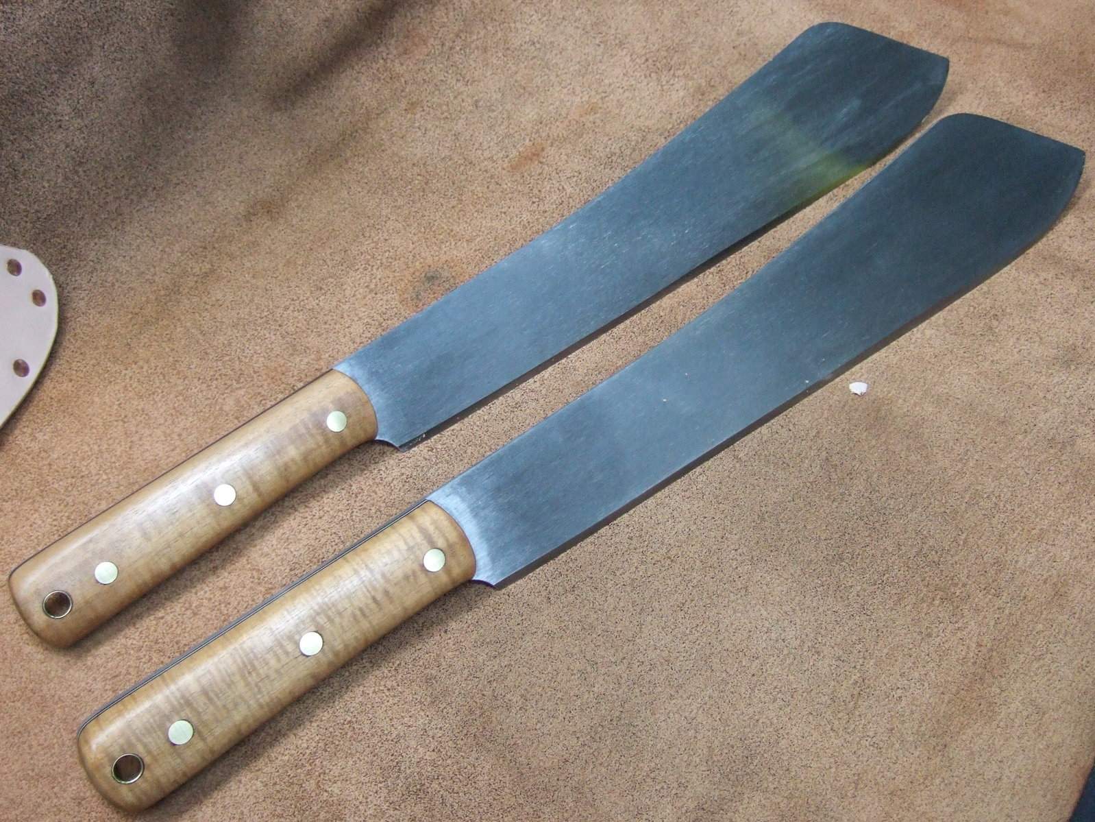

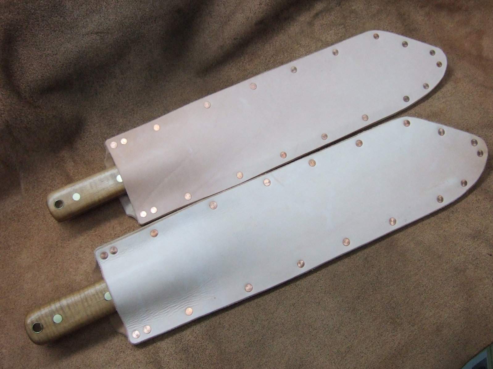

    But now that you mention them.... You mean like these that went out yesterday? 1 of 2 and 2 of 2 Limited Editions...
    @Mountainman teaser preview ;) sorry... couldn't resist...

    Teasers are always welcome. They look excellent!!! Can't wait to receive the package.

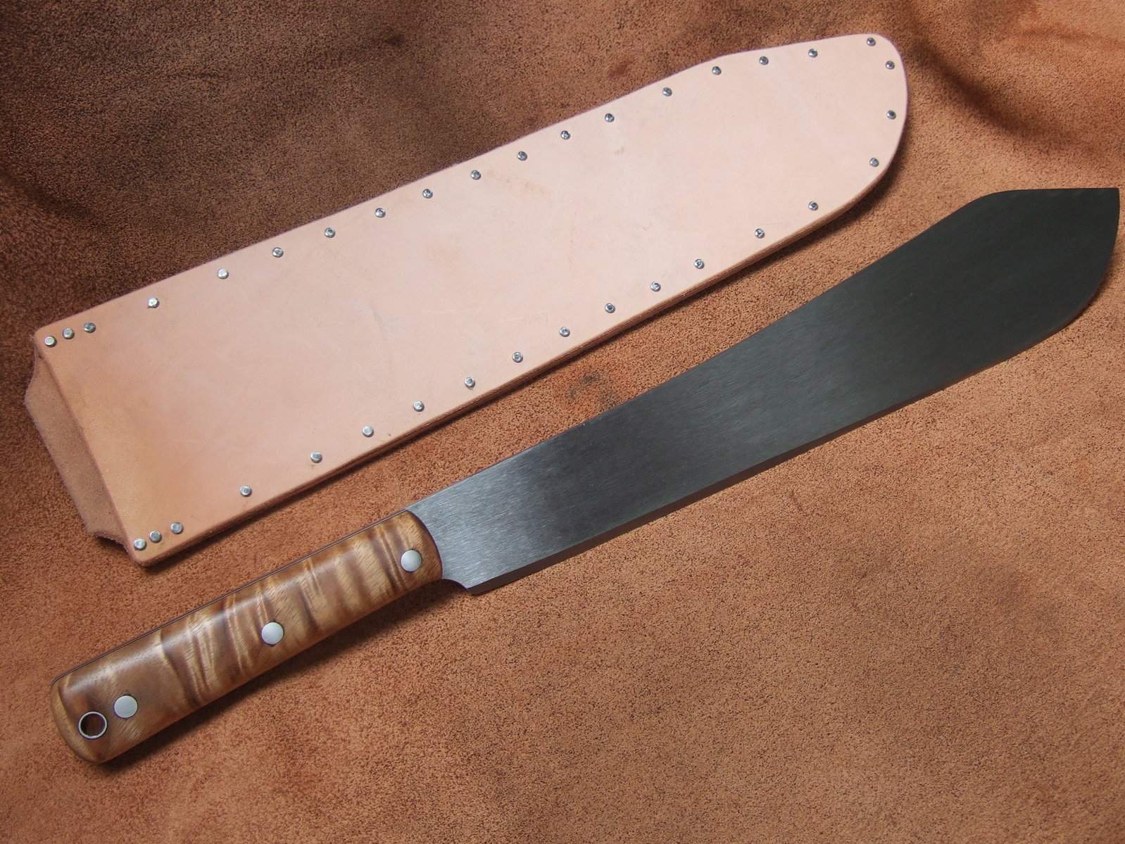

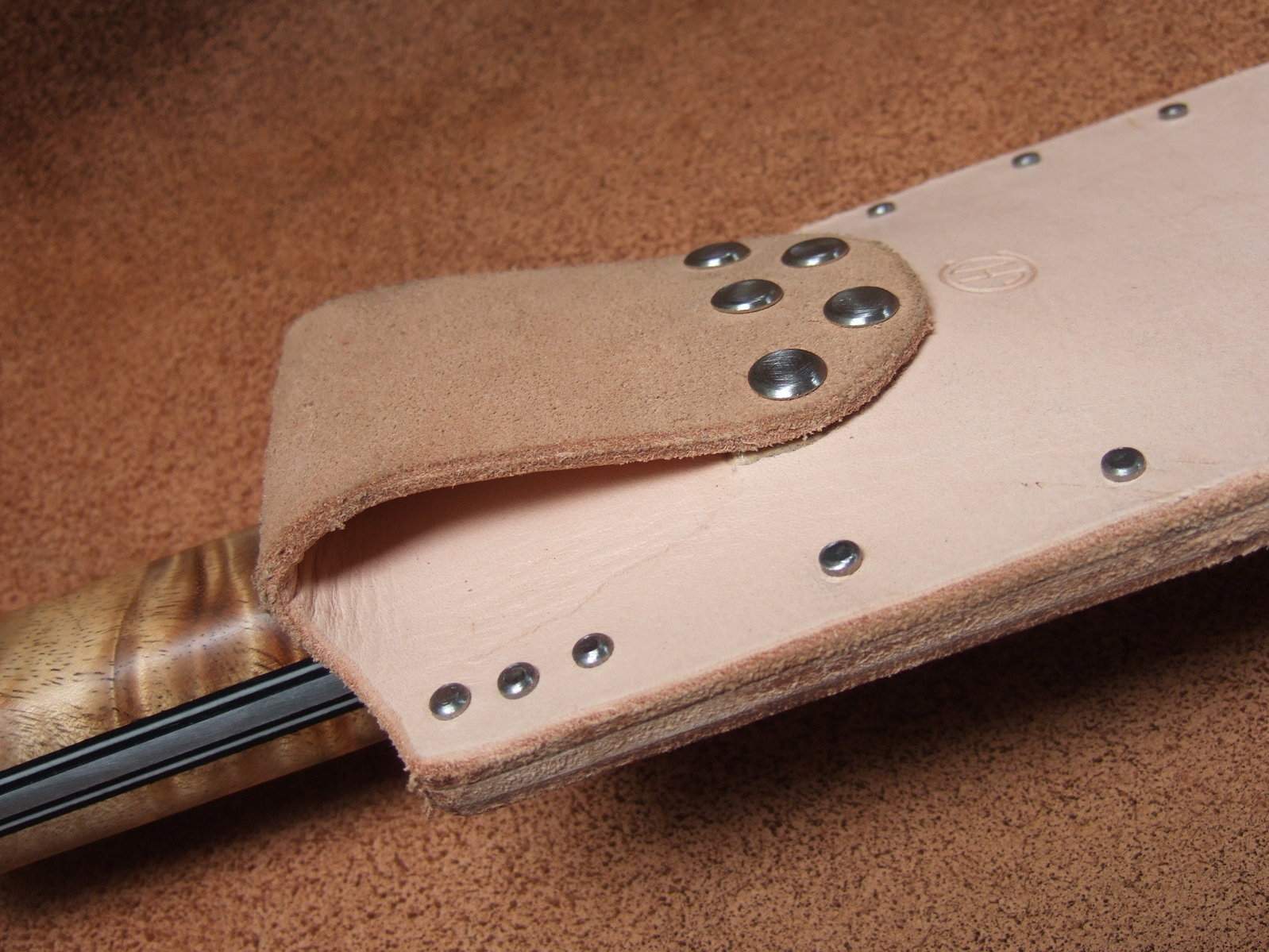

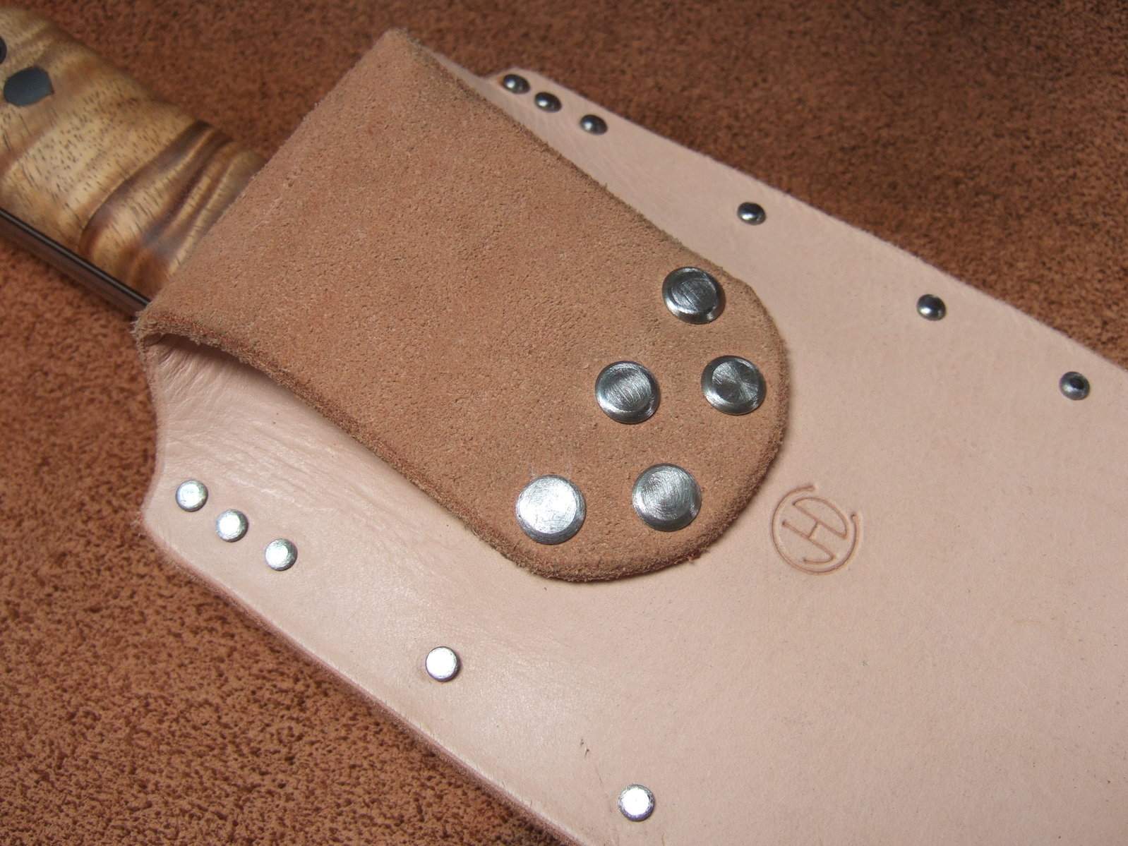

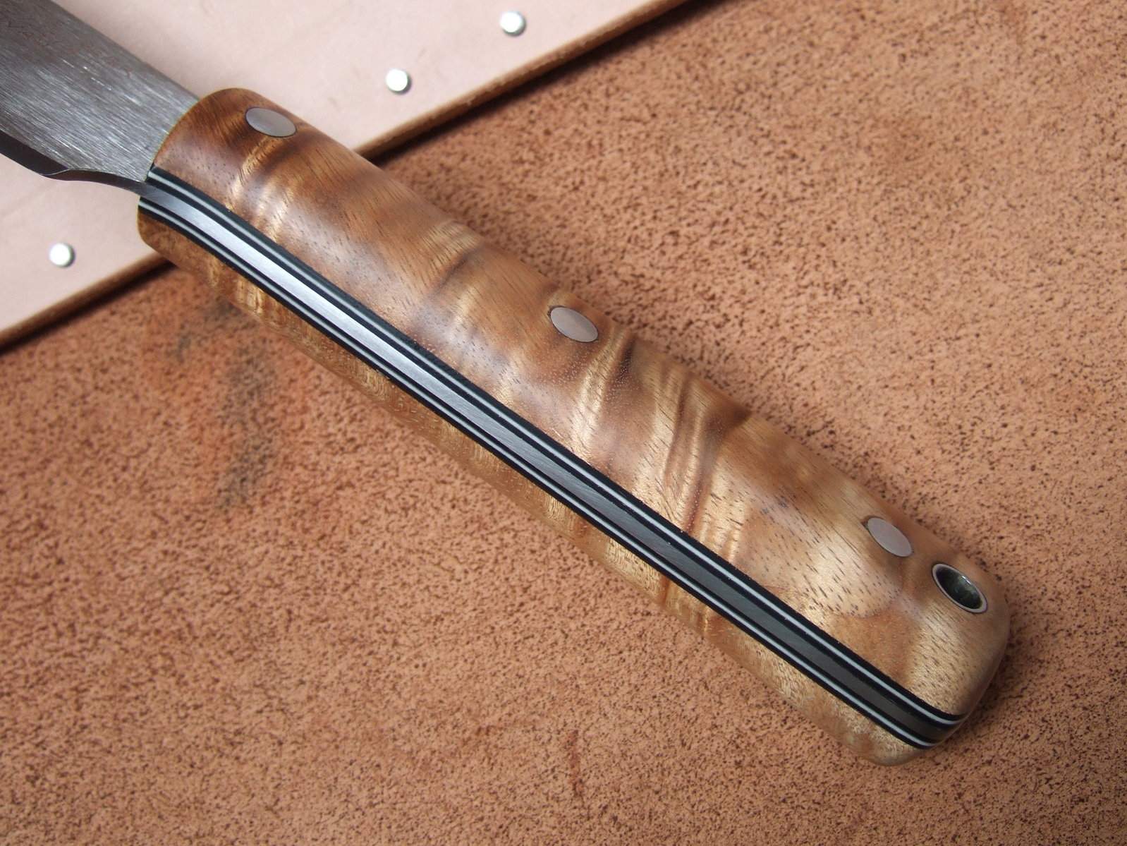

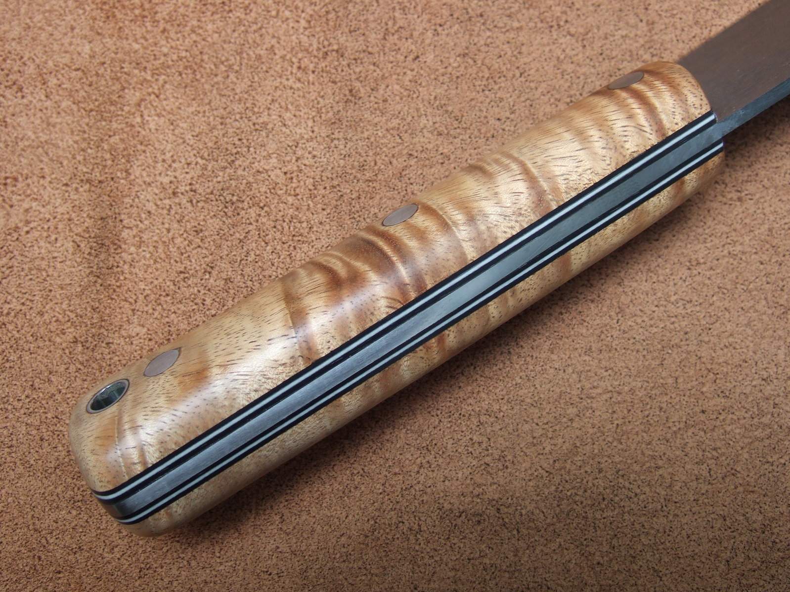

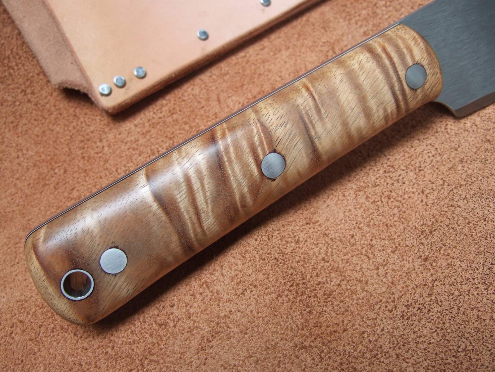

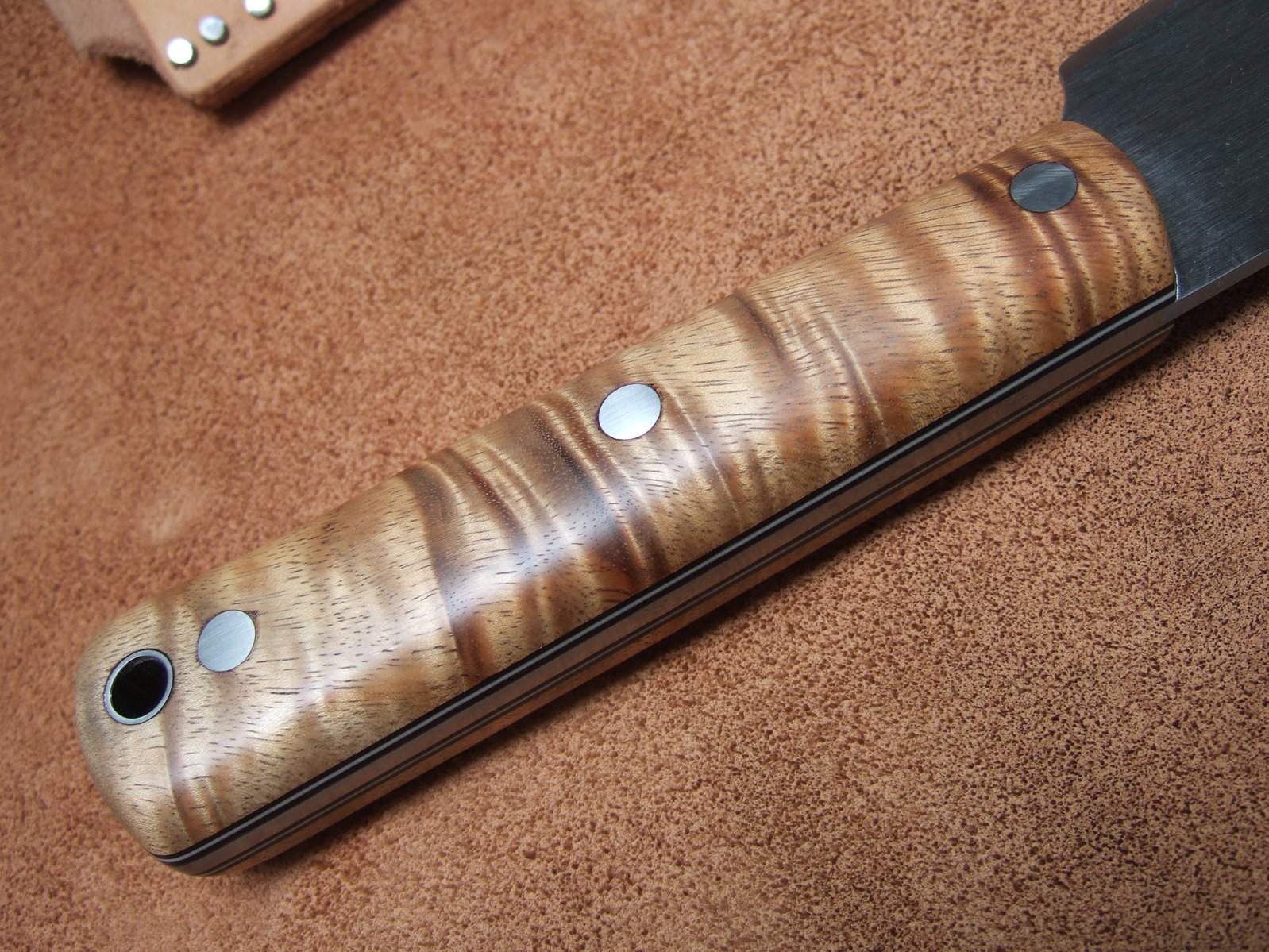

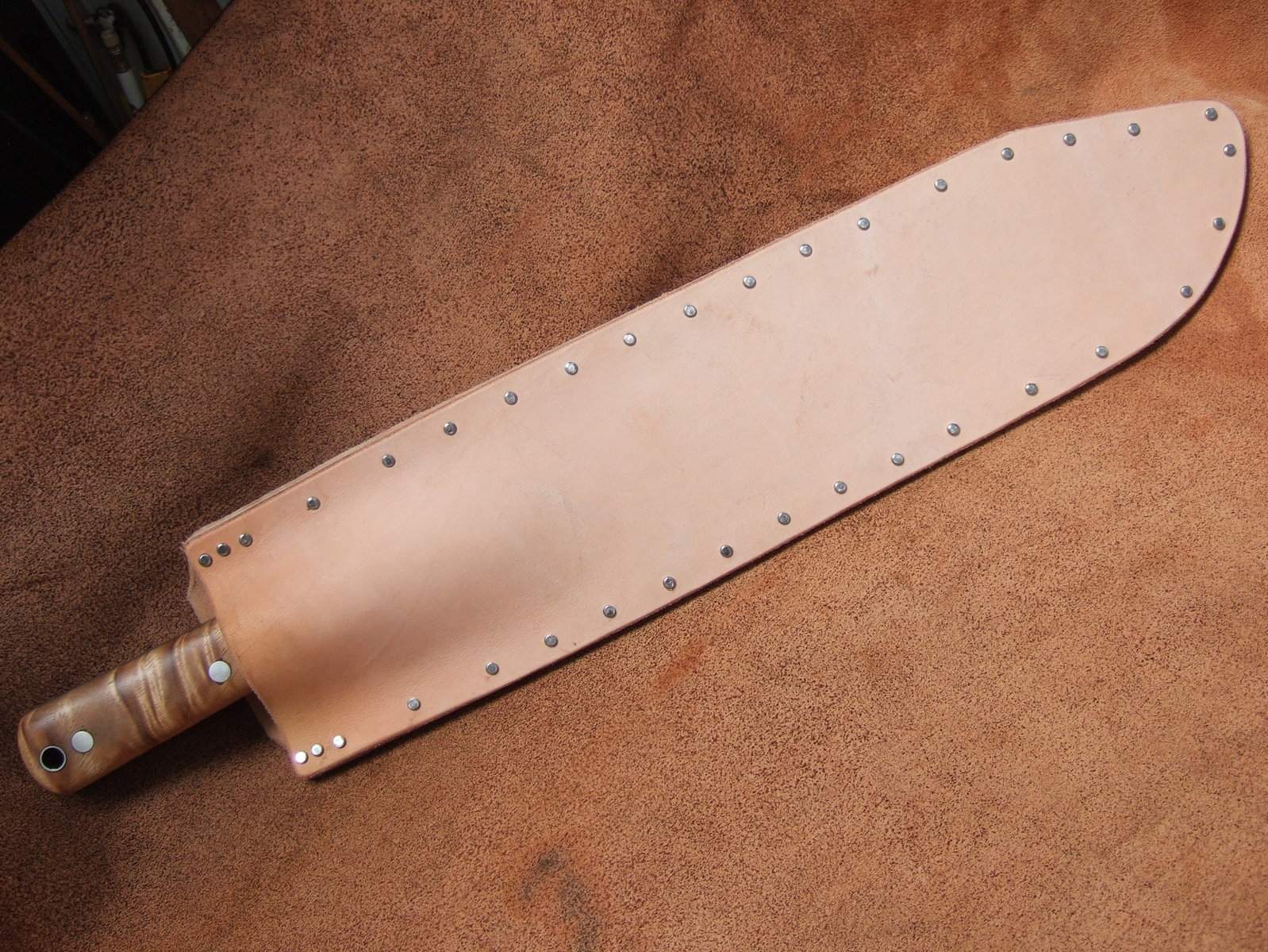

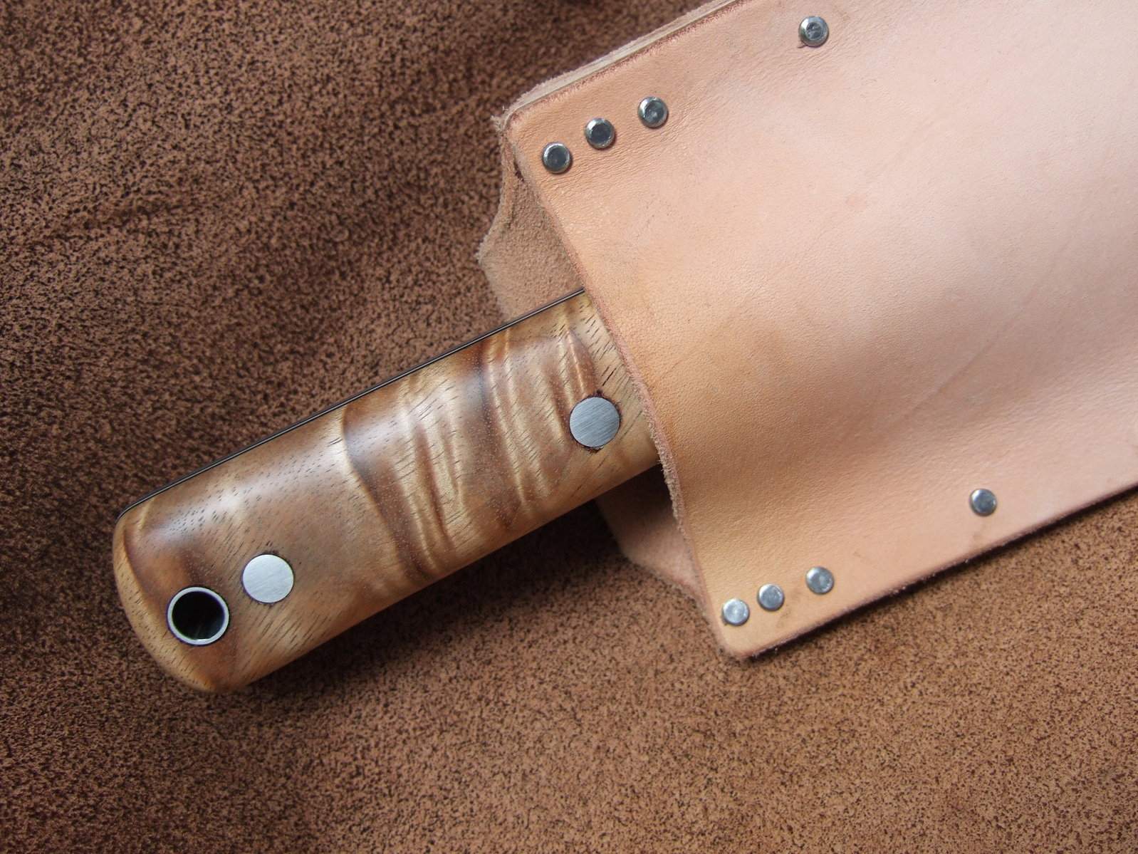

    Here is the last of Limited Edition thick blades this year... and for a long while...

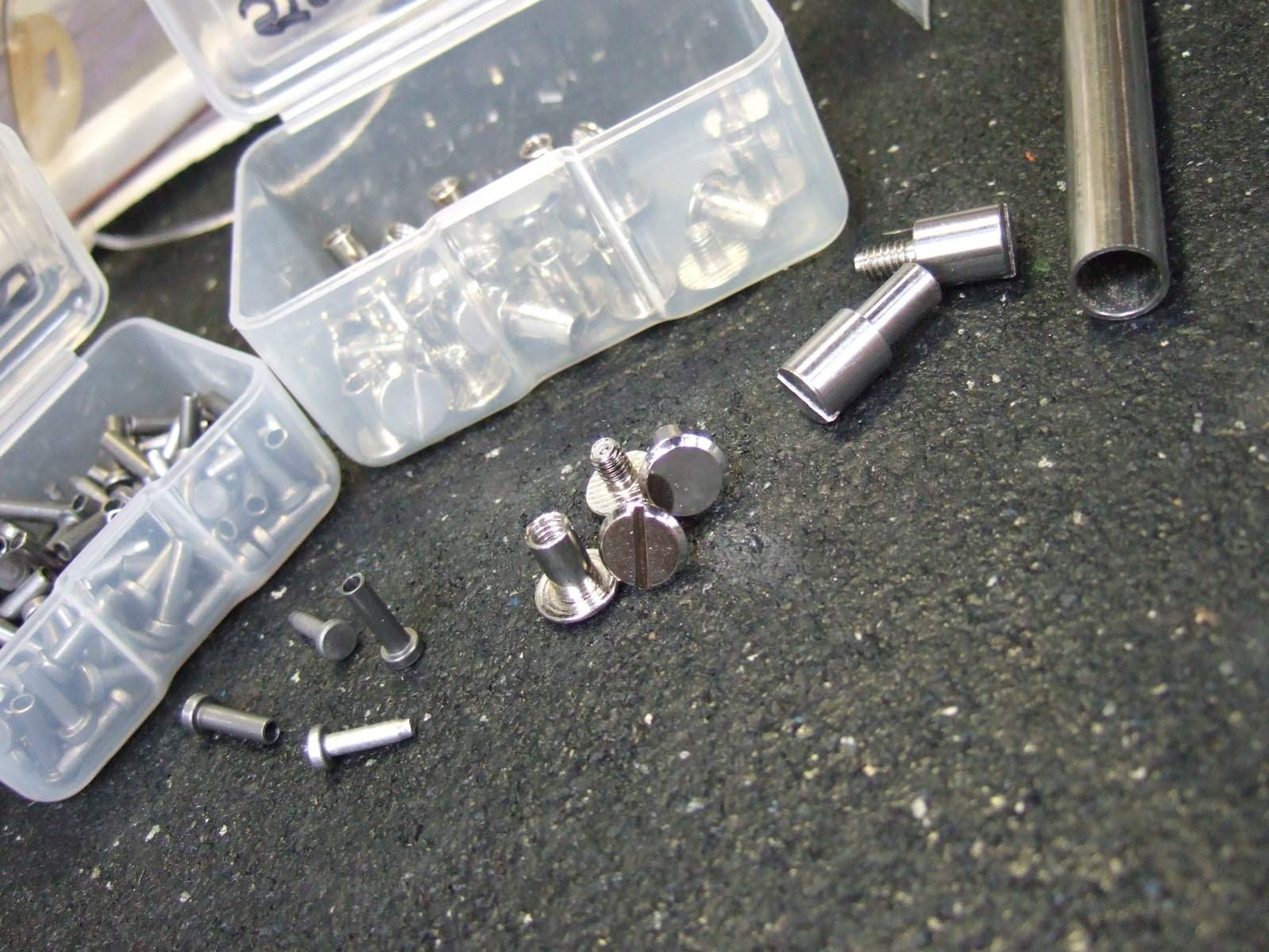

    This Monkey likes stainless... so it's all stainless fittings... down to the turned rivets and bolts on the sheaths... each of the 36 stainless cutler rivets was chucked and turned and trimmed to fit the sheath... and each of the 5 stainless chicago screws were also chucked ground so no slot and smooth and fitted with gflex epoxy for a super secure belt loop
    the rivets on the sheaths have smaller heads so there are 36 of them instead of the normal around 20 copper... and the bolts on the belt loop are oversize but still have 5... looks like the rivets on old tank, battle ship or bomber imho... lol...
    Koa is a special blond flame koa to go with the silver stainless... black white black triple liners to accent the whole package... user grade, fugly, bombproof tool... hopefully it won't stay pretty long ;)
    Enjoy @HK_User ... thanks for letting me share it... and no worries @Hanzo hasn't seen this one... yet... ;)

    Purdy!

    Purdy for sure and useful too.
    I am honered by Bear's skills.
    Nothing more I can say.
    Just thanks, Bear.

    Got a Bear package today, YES!!! The Silverback Blades for my wife and I arrived, guess I better not piss her off now. :mad:
    Great craftsmanship all around and a very heavy duty blade. The wood on the handles looks great and I like the fact that they have a thick handle to control the heavy blade.
    Great work Bear and thank you for the opportunity to own these fine blades.

    Package came in and the set of blade and sheath are excellent.
    First time in my life that a sheath is put together with STAINLESS Steel, great Job Bear and a set to use and abuse and still have for the next generations.
    As y'all can see the computer is up and running so tomorrow I can give the new tools a work out. Light weight blades are fine for fast growing woody plants such as Bananas or green Cane or even Bamboo but for tough slow growing dense wood you really need some meat to the blade. Meat a plenty with this new Bear blade and a sharp point for pesky mammals or reptiles.

    Glad the package arrived safely @HK_User ....
    Hope you like that sheath... probably the first and only one I'll ever do like that... not the prettiest puppy on the block ... but you know it won't come apart unless it get's consumed in a fire... yup... that's about it ;)
    Yeah... it's the tough version... should be easy to sharpen or put your favorite edge on ... and will hold a good edge... full flat is not for everyone or for all applications...
