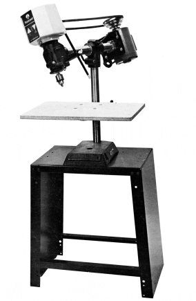

    Drill Press:
    This is probably at or near the top of the list. It is easy to think that a hand drill can suffice for a drill press, but when a degree of accuracy and hole perpendicularity is critical, a hand drill does not fill the bill. A drill press also has more power and rigidity allowing larger holes to be bored than are practical with a hand drill. And if precision and control is needed to not break bits or drill too deep, you can’t beat the press.
    A few considerations for a drill press. 1. Swing. This is a goofy metric and one to make things sound bigger and better than the really are. If you had a round disk and wanted to drill a hole in the middle of it, a drill’s “swing” is the largest diameter disk that this could be performed upon. In other words, the swing rating of a drill press is twice the distance from the center of the drill bit to the front surface of the vertical column in the back the work would bang against. So, it you are looking at a 10 inch drill press, that means you cannot drill a hole in the middle of a 2x12 board as the board will hit the column and the middle cannot be positioned under the drill chuck. I suggest don’t consider a swing less much than 12 inches. (don’t go there Kell).
    Another specification that is oft overlook is stroke or quill travel. The quill is the column like section that holds the rotating spindle with the chuck attached and when the down feed lever is pulled, extends the drill bit into the work. Beware that many small bench drill presses may have 2 inches or less of quill travel (stroke) and frankly that is often frustrating to use. Change a bit size and the table will have to be raised up or down all the time. If you want to drill a hole through two 2x4s stacked together, that can’t easily be done; you have to do it in multiple operations. 3 inch travel is tolerable and not uncommon and 4 inches is desirable and practical but pushes the upper limit for most of the larger bench top units. To find strokes of 5 inches or more you’ll have to look to larger floor models.
    Drill presses come in floor models and bench top models. Pretty self-explanatory there. Beware of bench top drill presses where the overall distance from the drill chuck to the table in its lowest position is 12 inches or less as this means the column is short. Look for more like 16-18 inches or more as you don’t want to run out of room for larger, longer drill bits with a drill vise mounted on the table.
    Angle drilling is accomplished one of two ways. 1. The table tilts side to side or 2. the head of the drill rotates. Often for the rotating head versions, there is another round column like member that is horizontal and the head can actually be moved in and out. These are often called radial drill presses. Personally, having used both conventional and radial presses extensively, I generally prefer a radial. It is easier to keep the work level and move it into position than to slide the work up a sloped table to position it correctly and clamp it in place to keep it there. Radials often also have much bigger swings and if you want to do some wood working with it, you’ll likely appreciate that extra room before running into the column. The one area where a non-radial may be desired is boring large holes in steel. The radials have more flex in the head and a more rigid platform can produce a smoother hole.
    There are some features that are generally desirable.
    A quill lock: this allows you to lower the quill to a position and then clamp or lock it in place. If doing things like using sanding drums, this is handy. You can also snug it a little and take out play if a large bit is chattering and not wanting to drill smoothly. Lasers are getting popular and while some seem to work ok, others are just gimmicks to help close the sale. I have tried them and don’t bother with them, but that was a few years back and maybe some are better now. Lamp: Some come with a lamp attached but those are generally easy to add including some magnetically mounted ones, so don’t let that be a deciding factor. Do beware that some lamps are mounted in a way that doesn’t illuminate the work very well so be sure it adds value.
    I have a Rockwell radial (like in the above picture) I purchased in 1976, it is still used with great regularity to this day and I love it.

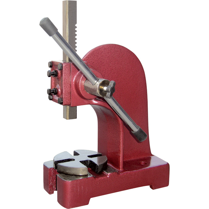

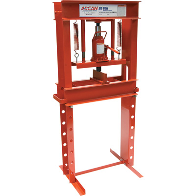

  18. Tully Mars
    I would suggest adding one of these as well. While they can be purchased starting around $500.00 I would suggest that a person make their own. I have made several over the years and as long as a person uses quality steel for the pins and the press plates you will be fine. IMO, its a great addition to your shop and a fun project to expand your shop skills. There are many plans on the net, or just to go your local harbor freight or norther tool store and take a few pictures with your phone. bring a tape measure to grab the required measurements and off to the salvage yard for the steel.
    Another handy press to have is an arbor press like the above. They usually start around $50.00 and up. Mounted to your work bench they make pressing bearings,seals, ect much easier. I've even used them to broach collars and spacers for keyed shafts. These presses can be used for straightening smaller shafts, lawn mower blades, all sorts of items as well.
    chelloveck, KAS, Bear and 4 others like this.
