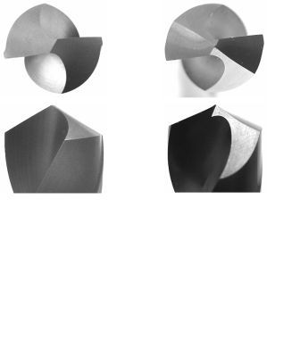

    I did some work in the shop this weekend and had to do some drilling in tough material (drilling out broken bolts). This ate up a few drill bits so when that project was done, I sat in a chair, drank some nice porter beer and sharpened a bunch of drill bits. Then it occurred to me I don’t think I had advocated this little toy for people, the Drill Doctor.
    This is a wonderful product. I have the DD750X which will sharpen twist drill bits up to 3/4 inch diameter (hence the 750 like .75 in the name). There is a bit cheaper model that is the DD500X that will sharpen up to 1/2 inch bits. There is also a model half the price of the 500 but it is limited in its capacity but if one doesn’t do much drilling, it may be adequate.
    I personally recommend the 500 or 750 machines as they possess more flexibility. These can sharpen 118 degree drills (the normal) and also 135 degree pointed drill bits and they will sharpen or create split point drills. Split points are nice and tend to drill through stuff more easily if you haven’t drilled a pilot hole first. A conventional bit is on the left and the split point on the right. The key is the web area in the middle is cut down so the bit penetrates into the material a bit easier. Split points also don't wander near as much when starting a new hole.
    Overall the machine is a bit loud and noisy and given that for the most part it is plastic, it seems questionable as to it capability. However, the critical plastic parts are glass filled engineering plastics and very stable. You will note the reviews on Amazon are very high and it is a solid product.
    I have had my Drill Doctor for about 4 years and really like it. Super easy to use and not hard to learn. I re-sharpen bits over and over and have saved a fortune not buying new ones. One of the best parts, is if I dull or break a bit in the middle of a project, can just re-sharpen in a couple minutes and get right back at it. No trips to hardware or big box store for a replacement. This could also be quite valuable for a time when going to a store for a new bit is no longer an option.
    I do recommend getting a couple additional diamond grinding wheels for it. The standard grit wheel is 160 and is fine for 3/16 up to 3/8 inch bits but for the smaller bits I kind of like a finer 220 grit wheel and for the bigger bits a courser grit saves a fair amount of time. For my biggest bits I will sharpen multiple bits with the course grit (I think its 100) then come back and touch them all up will a finer grit to get a cleaner cutting edge. Not hard to change out the grinding wheel either.
    Drill Doctor

    I learned (read a book and self taught) how to sharpen by hand as well. I too have a fixture I got 40 years ago for mounting on a bench grinder. It's very good to know hand sharpening and metal workers should learn, if for no other reason but to recognize a properly sharpened bit.
    Unfortunately, with hand sharpened bits, if you don't get the intersection of the cutting lips right in the middle of the web with the two cutting lips being exactly the same length, then the bit will tend to drill a larger diameter hole. When doing precision holes for tapping, etc. just 5-10 thousandths off can be significant and it is tedious getting super accurate with drill gages and calipers. The Doctor gets us a thousandth, maybe less, and I dont have to hardly think about it. I can drink beer and sharpen 3 dozen bits in less than an hour, including the split points. I like that.
    AT
