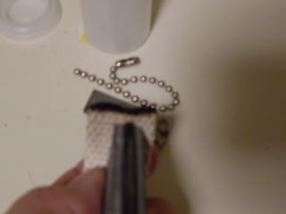

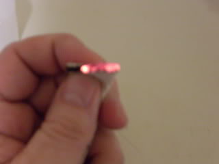

    Place a piece of lamp wick 'under' sparking bar.
    Then you'll have a glowing wick, so - no hurry for starting your tinder on fire.
    Better than char cloth, as it isn't the least bit fragile....
