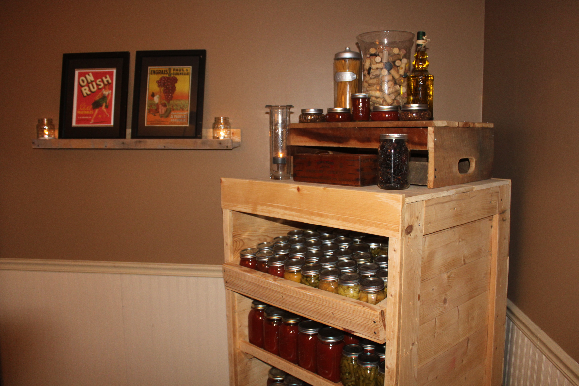

    How To: Cabinet For Storing Canned Goods or Heavy Items - Survivalist Forum
    Why is this cabinet different?
    - It really maximizes your space, able to hold nearly 500 quart jars in a very small area
    - There's Little to no wasted material
    - It can hold over 100 gallons of food by volume and probably a ton or more by weight
    - The price is fairly low for it's holding capacity (under $70)
    - It's quick and easy to build with very minimal measuring
    - You can customize it to any size or shaped items
    - It can be easily taken down and moved if you want or need to
    Rocky Road Lerp likes this.
  20. ghrit
    I like that one, but not a good choice for earthquake prone areas unless some retention is added.
