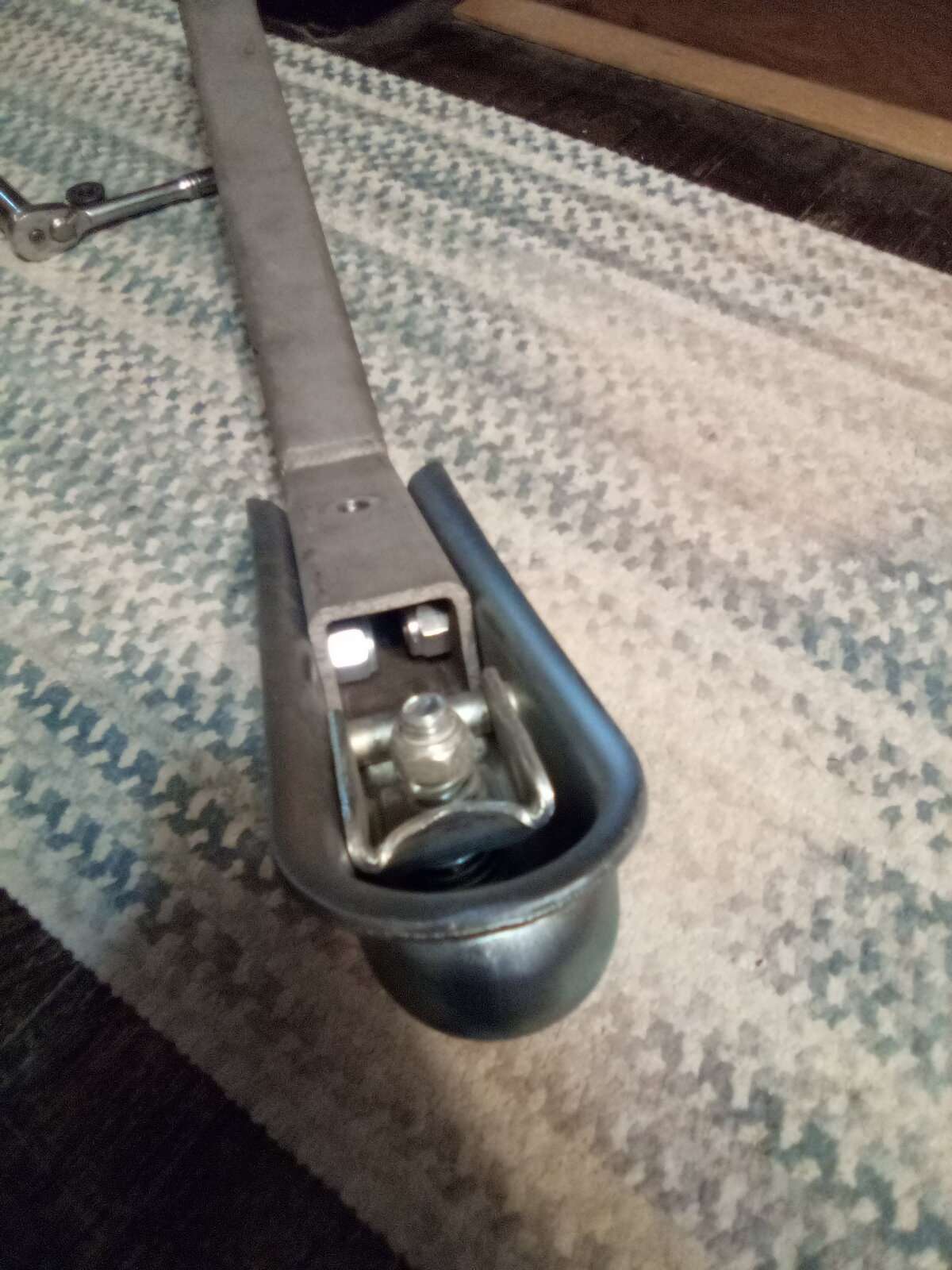

  4. oil pan 4
    Here's failed version one of the stump grinder tow bar.
    I did this around 2 years ago and I'm not even sure how I did it and I'm stilll impressed.
    That's 2 lock nuts inside of the hitch tube.
    IMG_20230929_123157_3.
