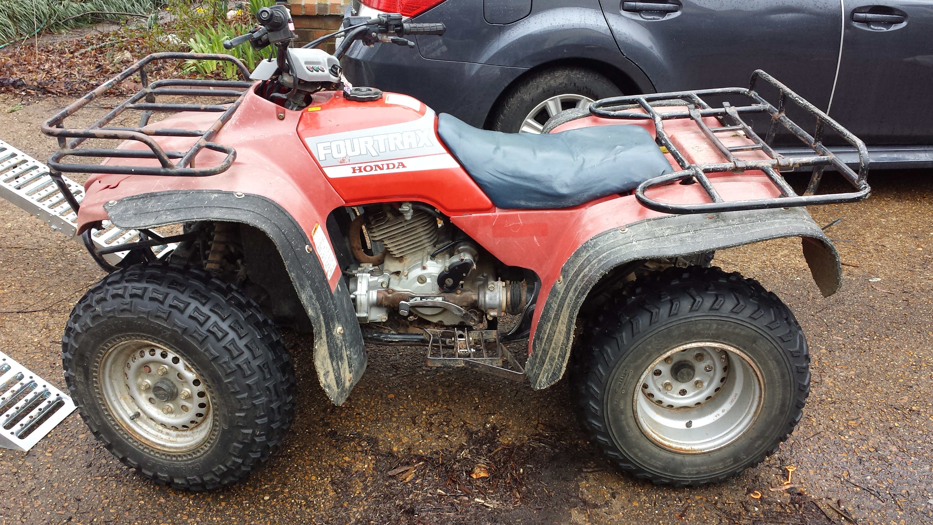

    Weekend before last I checked out a craigslist add for a "running" Honda ATV. When I got there it was suddenly "not running". Checked it out and offered an amount for it as is, not running.
    Got it home and had the engine fired up after cleaning the carb and installing a carb rebuild kit.
    The list of things wrong with this old gal is extensive, might be easier to list what is working :eek:

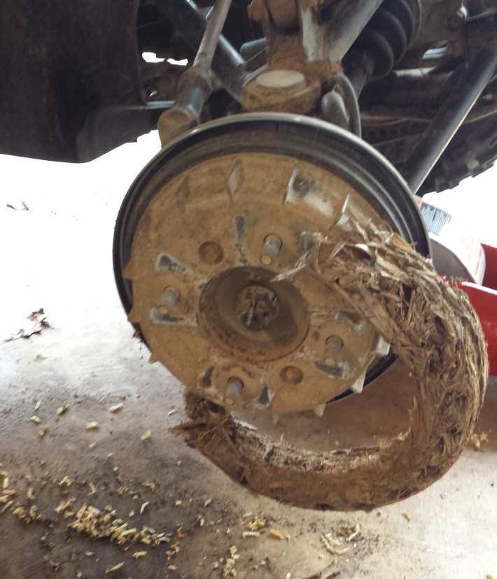

    Here's what I found when working on the front of the ATV.
    Removed the right wheel and found a matted bundle of grass

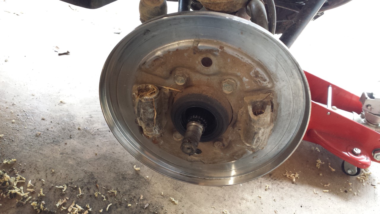

    Then I saw that the back plate for the brakes was bent (nice chuck of SS that is a pain to straighten out)

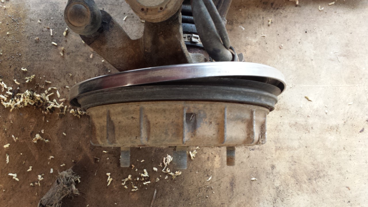

    Removed the brake drum to find, the reason why the front brakes were never "hooked back up":
    Parts are on the way to rebuild the brakes, master cylinder, replace the tie rods.
