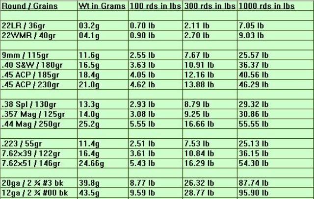

    .... and here is a handy chart for reference purposes, once you've reloaded all your ammo and you wanna know how much you can hump at once:
