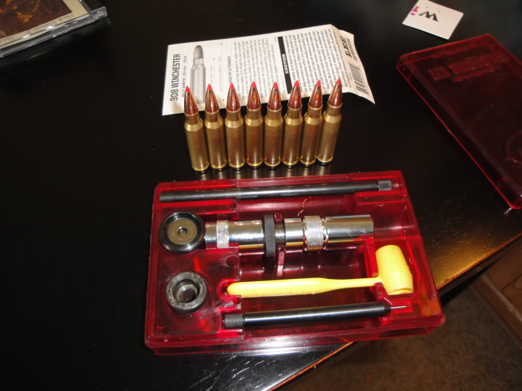

    Survival reloading? Lee classic loaders for every caliber in the compound .. actually doubles and maybe triples.
    Not chained to a reloading bench. Just need the kit, components and a hammer.
    Voila' Ammo!
