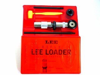

    Lee Loader, pocket size kit for loading the following calibers, and load data, powder measure and a chart for different powders for your size measure.
    Here are the instructions so you can get a sense of how to use it.
    https://leeprecision.com/cgi-data/instruct/RE1422.pdf
