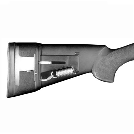

    Anyone have an idea, on HOW TO, manage to connect the recoil tube, to both the shotgun and the stock, separately?
    Otherwise, the entire thing is just a waste of time in engineering and design!
    I have seen butt plates with 2 springs separating the rear plate from the stock, and that might be something, but it is another problem with a GAP that could PINCH the daylights out of you, IF you did not have it shouldered correctly! It's always something!
