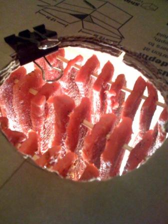

    This is a fun and easy project that you can do with the kids. I tried his recipe for the marinade but came up with my own after the first batch as Lex' recipe was a little on the bland side for me.
    [​IMG][​IMG]

  3. ghrit
    What he said. My only concern is dripping on the bulb. Let us know how your first batch comes out. It looks like something I might try, and adventurous I'm not. Usually.
  4. melbo
    There was some bulb drippage but I think that the lack of high temps kept the dripping to a minimum. No smoke either.
    I've made 3 batches (32 lbs raw) through this setup and it turns out great especially the second 2 batches with my marinade.

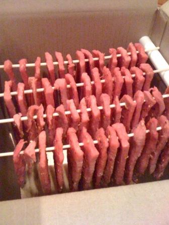

    Alright. I finally got her done and tested. Thanks again, Melbo. ;)
    Pics of the jerky maker below. I managed to locate all of the parts in the list except an exact "L" bracket, so I used what I could find. I attached the fixture to the lower side with the bolts added cardboard supports and taped reinforcement. The aluminum foil interior (also the interior roof of the box) is mostly a precaution of mine; it also serves to radiate the heat more evenly. I attached the foil with clear tape. I added an aluminum drip pan (2 spliced together to fit) to the bottom to catch the marinade. I also taped the plug wire to the outside of the box with added cardboard support so I do not yank directly on the light fixture. Another precaution.

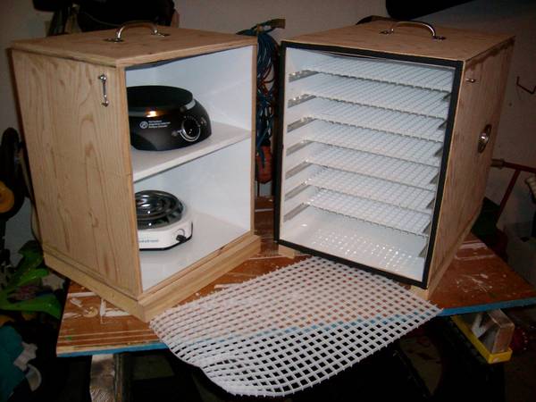

    Loved this thread...I made one a few years ago for large batches of venison jerky...it was a little more then $10, but still not the $200-300 for the big commercial ones that the chain stores charge.
    I work in an RV plant so much of this material is scrap that is thrown away. Plywood construction with aluminum lined walls. Heat source is two small electric burners and a tanning bed fan circulates the air. I can dehydrate up to 10lbs of venison at once with this set up.
    Here you can see the heating elements and the fluorescent light grids as I use as drying racks...you can also see they were a tad too long on my trial run as they melted just a bit! :shock:

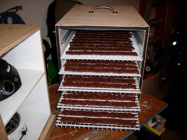

    Everything loaded and ready to go.

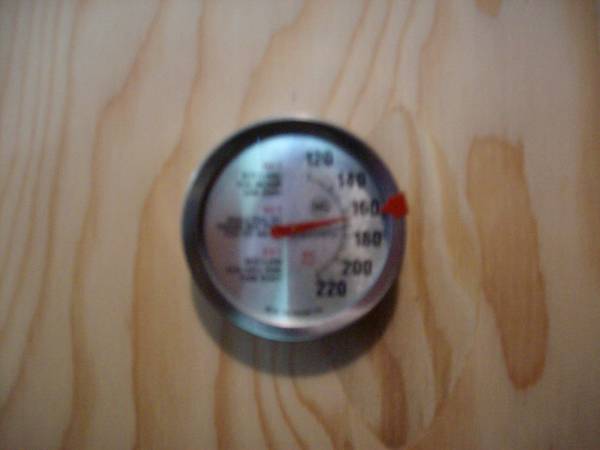

    Running about 166 here. Typically ran between this and 175. Rotated the racks after every hour and turned the meat over 1/2 way through. Ran this amount for about 5 1/2 hours total.

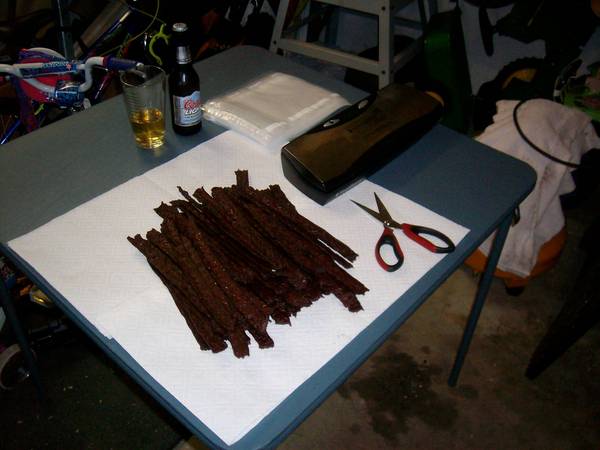

    End product, ready to be trimmed and vacuum sealed.
