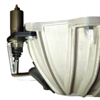

  4. HK_User
    Novak may have what you want in a mechanical linkage.
    For sure they have a Master/Slave set up.
    Shown is Novak's hydraulic slave cylinder retrofit system for Chevy, Buick and Ford bellhousings. This makes excellent use of CJ, YJ & TJ Wrangler master cylinders as well as many others. Click here for more information...
    Novak Jeep Conversions - Home

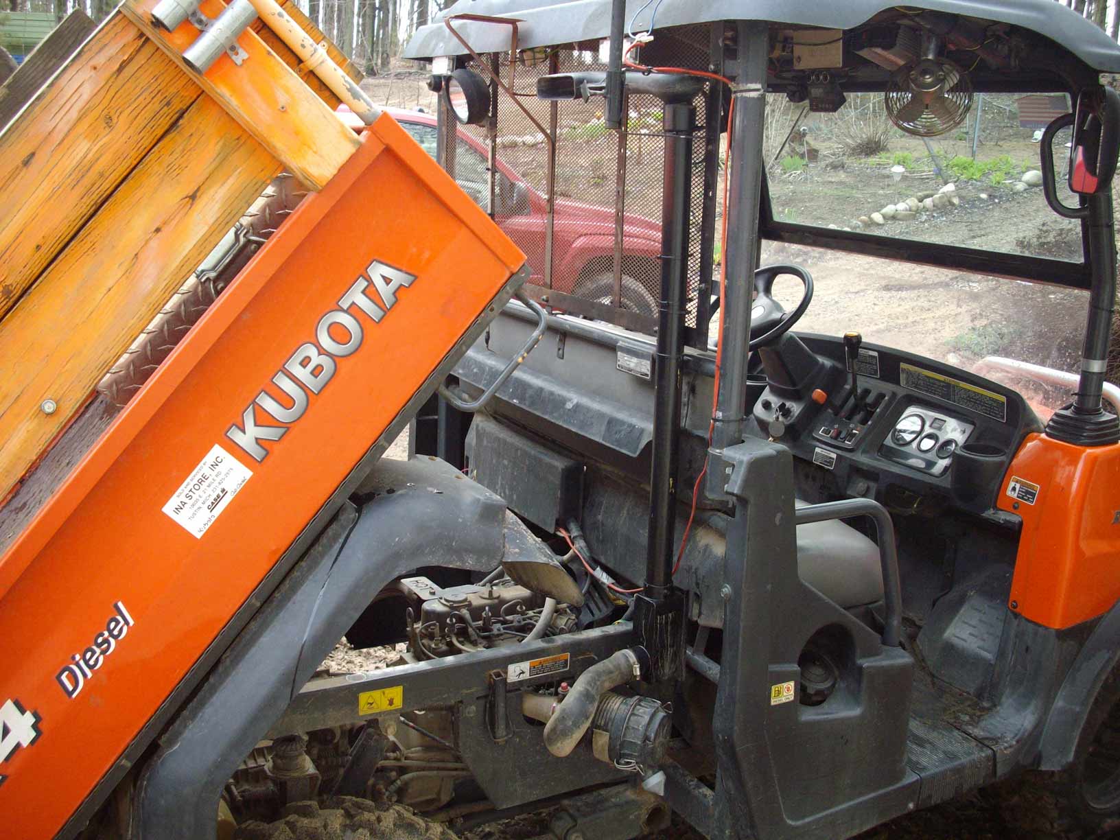

  14. HK_User
    Take a look at the KUBOTA line of RTVs, they even have a replacement for the 900 that repositions the intake higher than stock.
    Thus is a rigged set up RTV 900 High air intake - Net Tractor Talk
