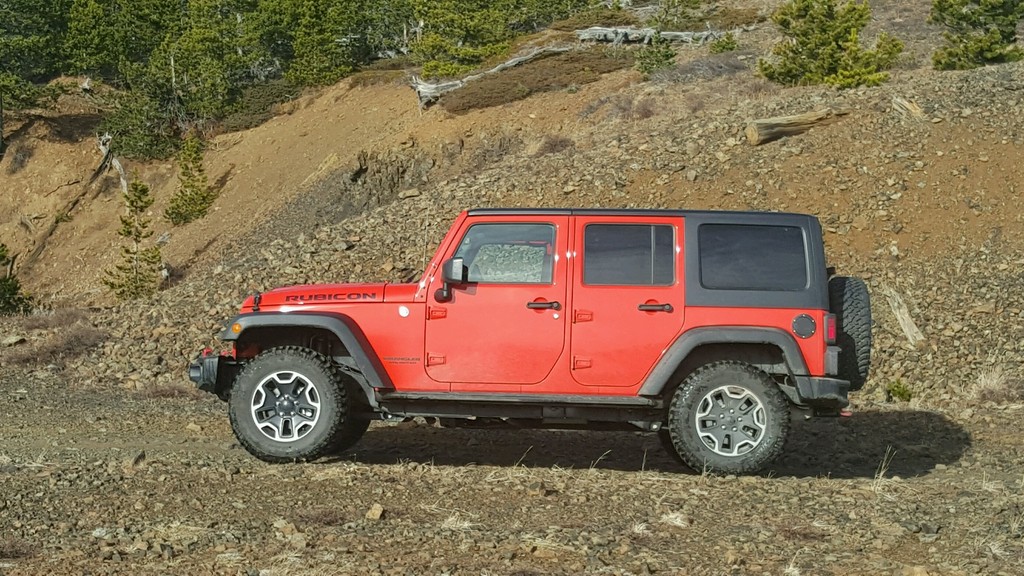

    Only pic I have...lol had to have a friend take this pic with his cell phone while we were out running Benbow Jeep Trail back on Nov 1st. It's a rocky and bouncy trail. Fairly easy with one moderately difficult water crossing if running stock ride height and tires.
    This is OJ. No not that OJ...but you can call her Juice. :ROFLMAO: Orange Jeep doncha know!~
