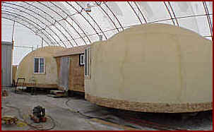

  5. DKR
    Monolithic Domes uses the Membrane as the form..
    Spray foam into the inflated membrane, add rebar, add shotcrete. Do finish coat inside - BAM, concrete home.
    I wrote an article about alternate communication shelters for the old MRT magazine. The cover photo was a Monolithic dome. The editor got so many requests for a back issue, they had to make a second print run to handle the requests.
    There was a Monolithic dome builder here in AK @ Soldatna - (down South of Anchorage) - and one of the hotter products was a 10 ft (D) dome that could be delivered to your site. Sadly, they left the State and no one took over the business. There is a major dome village still there
    with an "R"value of a bijillion or so, just the thing for cold Alaska winters.
    production line
    on site. Nice winter cabin.
