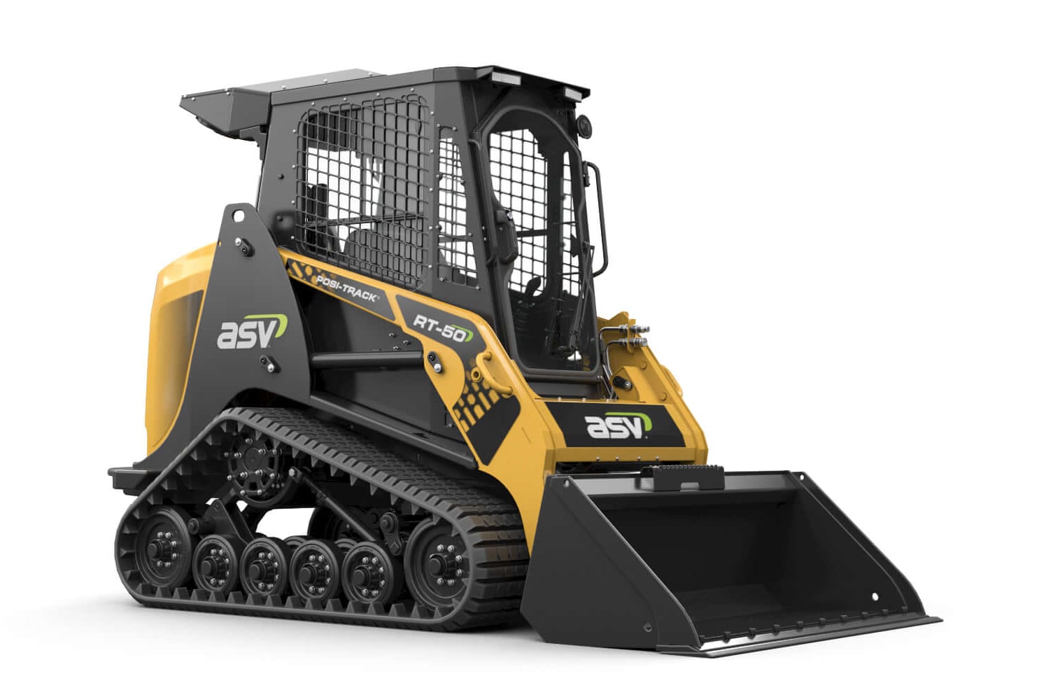

    Whoa! It appears that the first Track Loaders specifically designed for property management (instead of construction) are hitting the market, specifically ASH (RT-25/40/50) and GEHL (RT105). The one that interest me (at least its specs) is the ASH T-50 with a 50 HP motor, 5300 pounds, 14 inches of ground clearance (good or better than tractor), lift capacity of ~1400 lbs (also good or better than tractor), and with 15 inch tracks it has only 3.1 psi ground pressure - less than a person. This fits me to a 'T', exactly what is needed!
    I mean, it would do everything a tractor would do plus you have great visibility, much less chance of roll over, and its made for attachments in front. I get it that it's not as heavy-duty and can't lift as much as a standard compact track loader or skid steer but neither can a tractor. And, the damn Skid Steer, while I loved mine, simply tears up the ground too much even with gentle turns and leaves huge tire tracks/ruts everywhere...which I bitch and moan about while filling them in.
    One's maintenance would still be a bit of a bugger but transporting weight wise isn't much more or its the same as a tractor witht all the its extras on it. Wouldn't have to screw around with chains either or ballast weights or etc. and much safer.
    The majors (Bobcat, Cat, Kubota) really haven't embrace these yet but we'll see. I believe there is a huge market for these as most in my area are not farmers - but - we need something to manage our property, carry firewood, spread gravel, snow removal, etc...the normal everyday stuff of country living.
    I don't know much about ASH, guess its been around a while as it was the inventor of first posi-track and ASH was 100% bought by Yanmar in 2019. No vendors around here though... I'm going to look at this GEHL RT105 and see how it stacks up and where their vendors are located.

    ASV are Yanmar powered ( and I would reach out to the Yanmar dealers) and seem to be pretty good, though the imports are pretty slim, and there are some known issues with them, though most dealers/shops should be able to handle them! Gehl are a very well known maker in Europe, hugely popular and well supported, though your going to have to search out vendors here in the states to source things!
    As far as track loaders go, they are a lot better on the ground, but can still tear it up if you are not careful, a good set of tracks will help here, though they may not be all that good in the snow, but that's a trade off! New tracks can be found pretty reasonable, so that's not going to be an issue!

    @Ura-Ki The Gehl doesn't have enough ground clearance (think it was 7 inch) so screw it, that's a none starter.
    I thought tracks were good in snow, no? (I'm thinking military tracked vehicles). These tracks are 15 inches wide which is a good part of the reason the ground pressure is so low (3.1 psi) as compared to most the others which are 10-12 inches and about 4.9-5.0 psi. Hmm...I bet with less ground pressure it's worse in snow even though it's 5300 pounds, make sense, still given its shape and center of gravity it would be better than a tractor without chains. My old New Holland (5500 lbs) skid steer did okay in snow with new tires.
    Anyway...doubtful I will even get to try one of these even though I know this is what I and others around here really need, not tractors, these special track loaders. The closest vendor is Spokane, Washington about 1.5 hours away but its not even the time/distance, its I don't even like to go inside their state line...and this is from a guy who spent 20 years there!
    Are tracks really bad in snow? Is it because they are rubberized?
    Ura-Ki likes this.
  20. Ura-Ki
    It has to to with the tread, or in the case of what your looking at, lack of! Most of those rubber tracked rigs have tracks ment for dirt/grass and the weight is what gets them by. But in snow, you need deep well spaced lugs. There is also the low temps you are trying to operate in, I'm betting most tracks get really hard during low temps which will make traction even more difficult to find. The weight will help get you traction, but can also cause you to get stuck once the snow gets packed down. Look at the tracks on Sno-cats very wide, and lots of space between the cleats ( growsers) which is how they get around so well! Plus, instead of weight to help dig down to ground, they float ( ideally) over the snow!
    Bottom line for the tracked skid steer, you will ether need to swap to a more aggressive track as part of the purchase, or buy a pair of winter tracks and swap them over when the season starts, and save the turf tracks for when it's nice out! Or, say screw it and run what ya got till you get stuck! Lol
