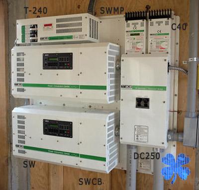

    If your just starting into RE and need to get feet wet , I'd say start with FLA Trogens , you can be mean to them , other than other styles of cells. I have pushed and ruined a few cells over time. I started with GC105s that were used and found out the water usage and time of life left in those .
    RE since Trace years .
    I have Robins stacked 4024 with the DC250 and the T240 .
    The C40s have been updated to Robins Classic's 150 here.
    I have updated to these :MidNite Solar Inc. Renewable Energy System Electrical Components and E-Panels
    I should list the units here under the for sale area.
