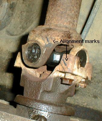

  18. ghrit
    If you had the drive shaft separated and it isn't keyed, you'll be in a trial and error situation rotating splines one by one if it isn't keyed. Look closely, it may be match marked if not keyed. The other thing is the center bearing. I had one on a Chevy that was rubber mounted, and the rubber deteriorated allowing the drive shaft to wiggle way more than it should have, and actually hit the frame with a pretty significant clunk when the clutch released. (Also shook enough to churn butter.) The 90 deg rotation might have to be repeated at the front if it doesn't work on the diff end.
  19. Quigley_Sharps
    This is the part to rotate. if you took it completly aart for the tranny too then it my need to be spun over.
    Yea Im not sure if he marked it when taking apart, but those are balanced and need to go back the same as they came off, and the carrier bearing Ghirt is talking about can cause it to, but if it didnt do before change, then im guessing the shaft was not put back the same as it came off, just a guess, been there done that.

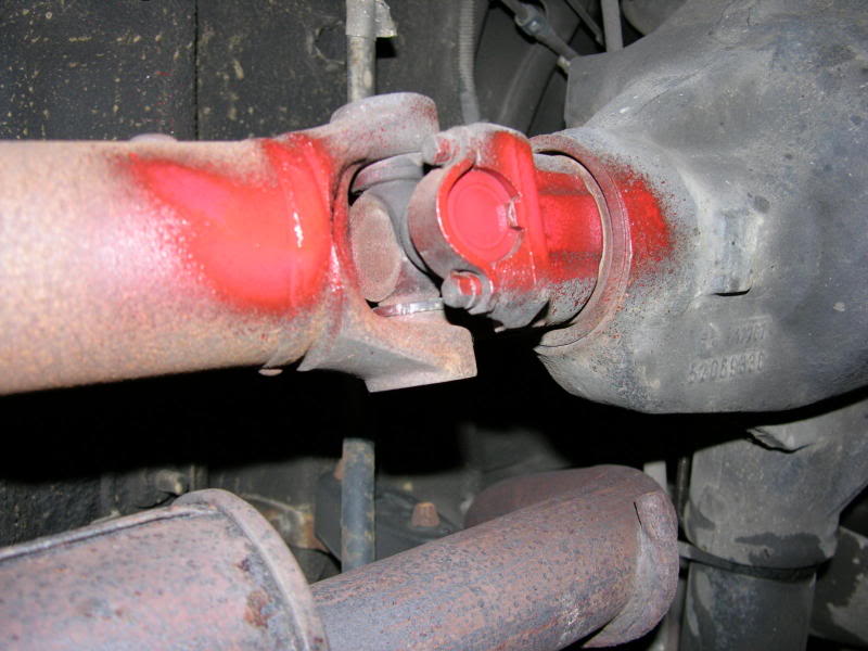

  20. Quigley_Sharps
    Another way of marking your driveshaft with paint to ensure that it gets reinstalled the way it came out as to not knock off the balance of the driveshaft.
