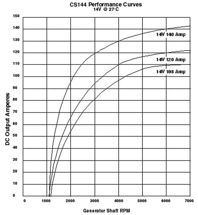

    That is not a surprise. Take a look at the output curve for a couple Delco alternators:
    Note that the pulley on the alternator is generally quite a bit smaller than the pulley on the harmonic balancer or crankshaft that drives the alternator. So the alternator will generally be turning 2-3 times the engine speed. A common idle speed is 550-600 rpms so your wife's alternator was maybe turning only 1100-1500 rpms. As you can see from the performance curve, the alternator needs to turn about double that to triple or quadruple the power output. Idle the engine a good bit higher and your results will significantly improve.
    Will the engine burn more fuel? Yeah. Interestingly many cars these days also have rev limiters built into the engine controls. While some in the past used to cut ignition to limit speed, most these days simply cut current to the fuel injector preventing injection and a combustion event. Once speed it back down below the control point it will resume injection. If the car is in neutral, I have seen these limiters kick in at just a few thousand RPMs. So, if the wife's car has a rev limiter like that, just block the accelerator pedal down and let it charge away. It will put you in a good power range on the alternator, will automatically not over rev the engine and it will cut back on fuel consumption as the battery charges and alternator load drops off. YMMV.

    Alternators generally are pulley driven to reach full charge RPM at 2200 engine RPM. As Airtime posted, 4500 rpm on the alternator is the sweet spot. Probably could have ran the engine at that speed for 15 minutes and had the battery mostly charged on less fuel.

    This specifically applies to car alternators large case heavy duty truck alternators are different. I believe the CS144 series is more of a "heavy duty" pickup and SUV alternator. I know the CS130 is smaller and was put in a lot of GM cars.
    I am sure the alternator in my wifes car is rated for at least 80 amps at full load. But if you charge a lead acid battery too fast when low it will over heat and damage it, running a light duty car alternator at full output in engine bay heat will likely damage the alternator. Trying to charge it faster seemed like a no win situation and I wasn't in a hurry.
