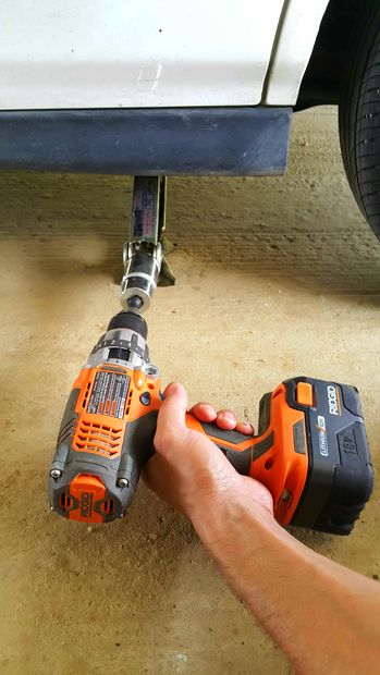

    Taking some of the elbow grease out of raising a car jack to replace tyres. Only works if the drill is sufficiently charged! :) May not be applicable to some car jack designs.

    Yes, it works. IF it is strong enough. If not, you can strip the clutch (if it has one) or overload the motor.

    I have done/do this. Hard part used to be getting a socket mated to the drill. My solution a dozen years ago was taking a socket wrench extension shaft and using an abrasive cut-off wheel (chop saw) to cut the female end off the hardened extension shaft so the remaining square drive shaft could be chucked into the drill chuck. Now I see socket drives to do this in stock at Menards, Sears and on Amazon.
    Amazon.com: 3" Impact Grade Socket Adapter Set From Ares. Turns Power Drill Into High Speed Nut Driver. 1/4", 3/8", and 1/2" Drive.: Automotive

    Yep, I have half a dozen of them in my tool satchel now.
