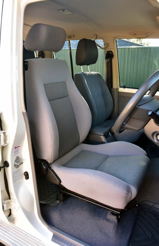

    So early in the week I dropped the truck off to my favourite workshop and handed him a list….got the call yesterday to come collect it but only if I was happy with the seat after a drive. The bulk of the jobs were done by Thursday, but the seat adaptor bracket held it up. So I shall start at the seat…
    ….it will take just a little getting use to but it has a bit extra rear travel on the runners (along with being about 200% more comfortable then the OEM one) and given my height and that the 70s are known to be a little short on leg room for some (for me with the seat fully rearward it was fine, but only just). Have a set of custom canvas seat covers on the way from the guy I got the seat from. They normally come as a set of two for specific vehicles but the maker did one for those seats he was selling so he ordered up a set with one to suit the OEM passenger side and one for the new drivers side.

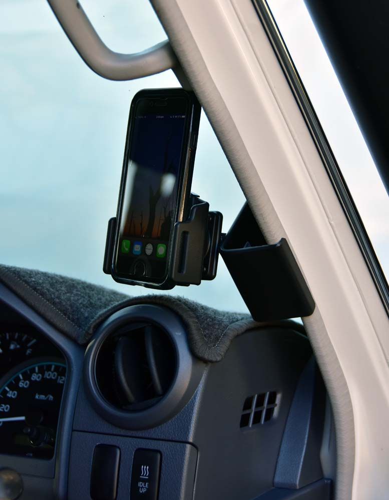

    As sad a fact as it is, a phone is a part of my life and I was sick to death of the suction attached one I had in the old truck detaching regularly, so I ordered a purpose built one for this vehicle and phone. I have used the same brand and design products in my work cars for the last 5yrs and have been happy with them so it was an easy choice..

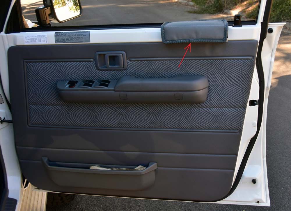

    One of the smallest mods with the greatest return so far was the arm rest mounted on the drivers door !!!! Saw them in South Africa and have been meaning to get one since I got home (they made them for my old 80 Series as well as they were big in South Africa too), the maker there would not ship to me here but I found a local guy who specialises in 70 Series trucks who did an almost identical (better executed I think) product in stainless steel and with a pad that match my interior….

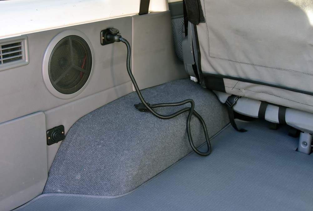

    In the Cargo Bay..
    …..a couple of things here, the old sockets were replaced just to be safe and they were swapped around, the lower was on heavier wire with a relay and the top a simple 12v lighter type wiring. Simply swapped the heavier line up high and added a switch for it on the dash, this is to run my fridge, my guy made me a short adaptor cable for my particular fridge. I think the socket style and adaptor will need to change but I will give it a run. Swapped these two around as I will build a split deck/false floor in this one like I had in the other, it will basically cover ½ of that rear speaker height wise so I wanted the switched fridge outlet high. What is also visible here is the cargo bay flooring, I removed the carpet and replaced it with a made to order vinyl floor with a sound and waterproof underlay. I wasn’t going to do the wheel arches but probably will now. I was disappointed with the underlay as I assumed (mistake one) that it would be cut to shape of the bay but it wasn’t. one long piece I had to cut it in at the font when I was making the incisions for the rear seat bases. I need to add a little more each side at the back to level it. I will express my displeasure about this to them Monday.

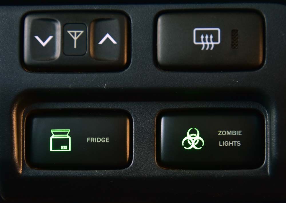

    Talking of switches….
    ….custom fridge and driving light (Zombie) switches in the dash. They only illuminate when on. I do laugh at myself every time I look at the Zombie Light one…!!!

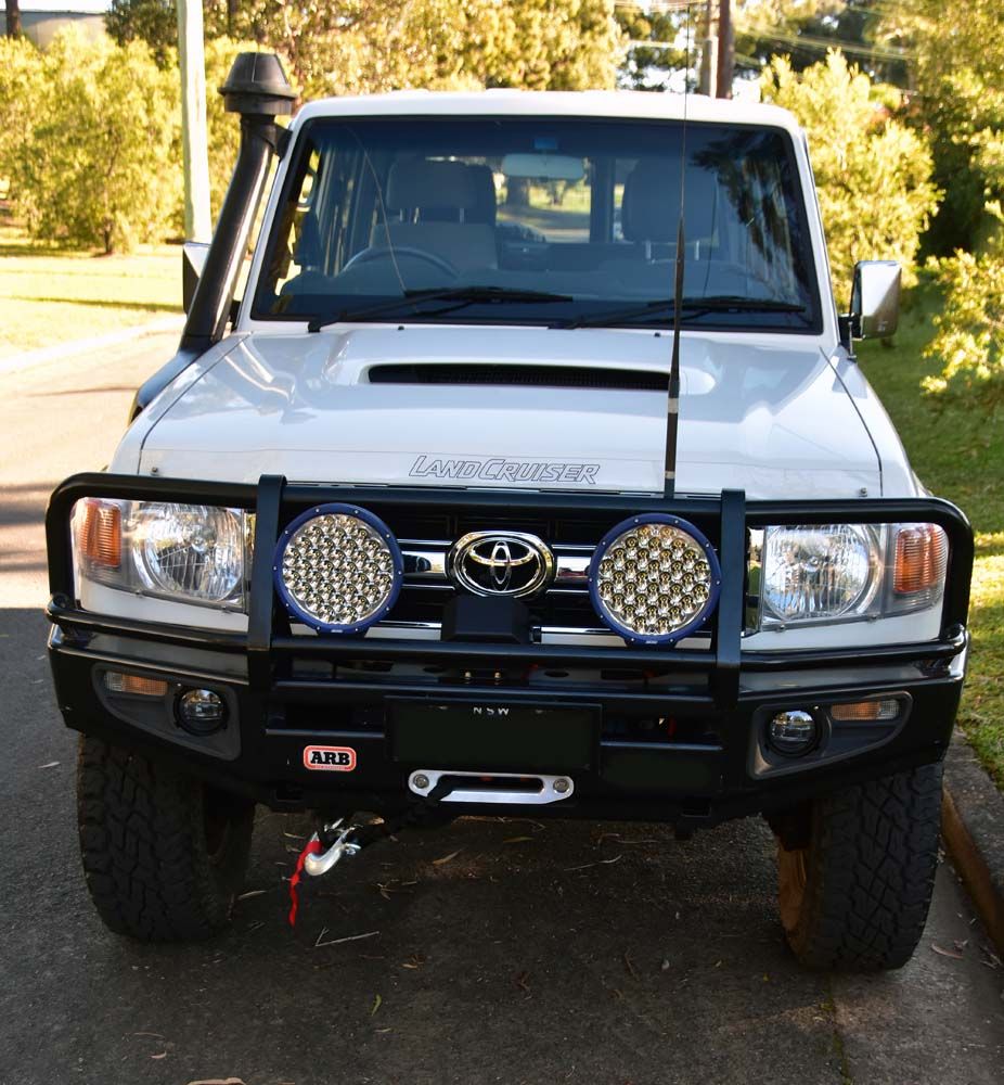

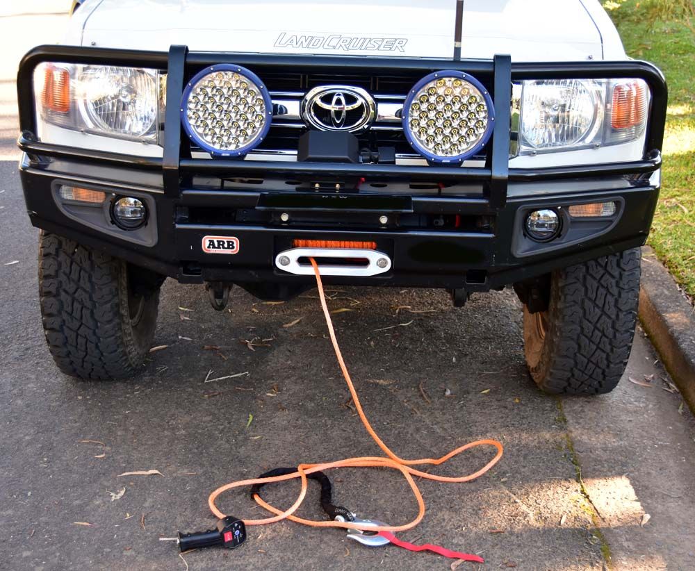

    …..installed the pair of Koala cooking LED driving lights, the winch and controller and he hooked up he LED fog lights while he had it.
    Toying with the winch…
    …it has both a cable and wireless controller, I need to test if the hand unit will work on cable with a flat batter, I suspect the battery is just for the wireless function but need to find out, I forgot to do so today. That hook will be gone the moment the Factor 55 flat link shows up !!

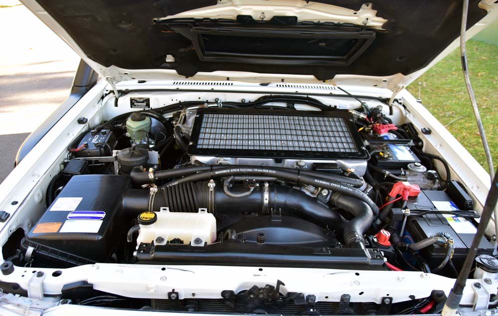

    And under the bonnet…
    ….hard to tell the differences here but there is an oil catch can added (with a tapped drain line routed down under the vehicle) and a heavy duty power cut-off switch for the winch. I was going to go with an illuminated one like the others but I was advised against it. Also can’t see the return to centre steering damper.

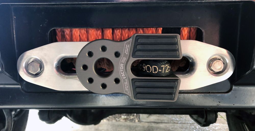

    Just received a Factor55 Flat Link in the post....what an improvement over the standard winch hook that is !!!!!
  14. Andy the Aussie
    Got a chance to fit the Factor55 jobbie over the weekend...

    I need to do something because it is a horrible design and one rock could do some damage.
    Also @Andy the Aussie have you driven your vehicle much? That is the cleanest engine. Can you splash some mud on there or something. I looked at that picture of your engine and think I should go home and power wash mine.
