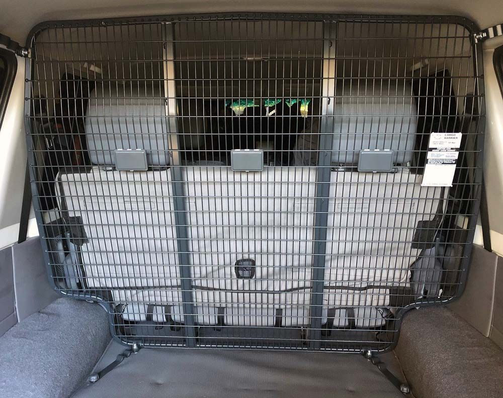

  4. Andy the Aussie
    Just got the truck back from Toyota having had the cargo barrier fitted.

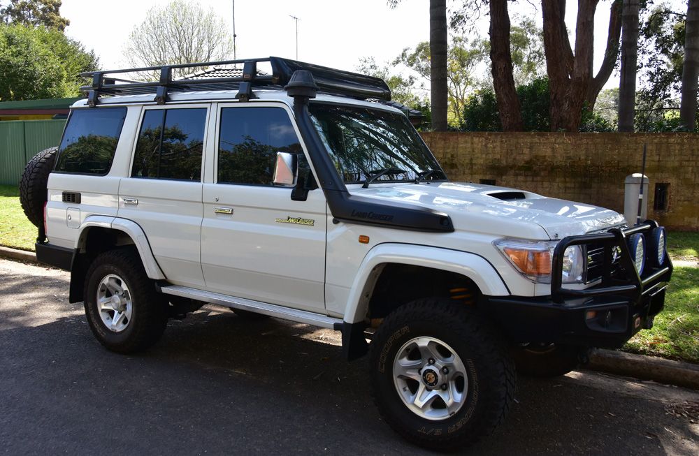

  5. Andy the Aussie
    Been busy as hell and some of the projects on the new truck got put on hold as a result…..!!! That and they are bloody expensive so I had to work my street corner hard to raise the $$s.

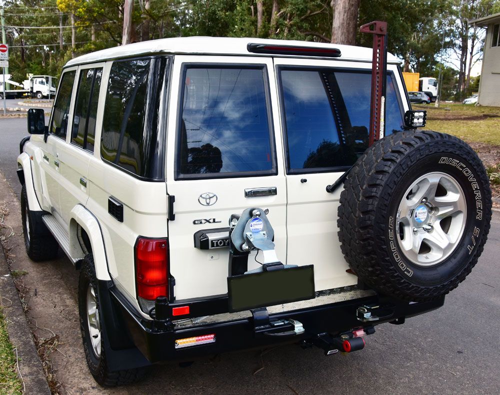

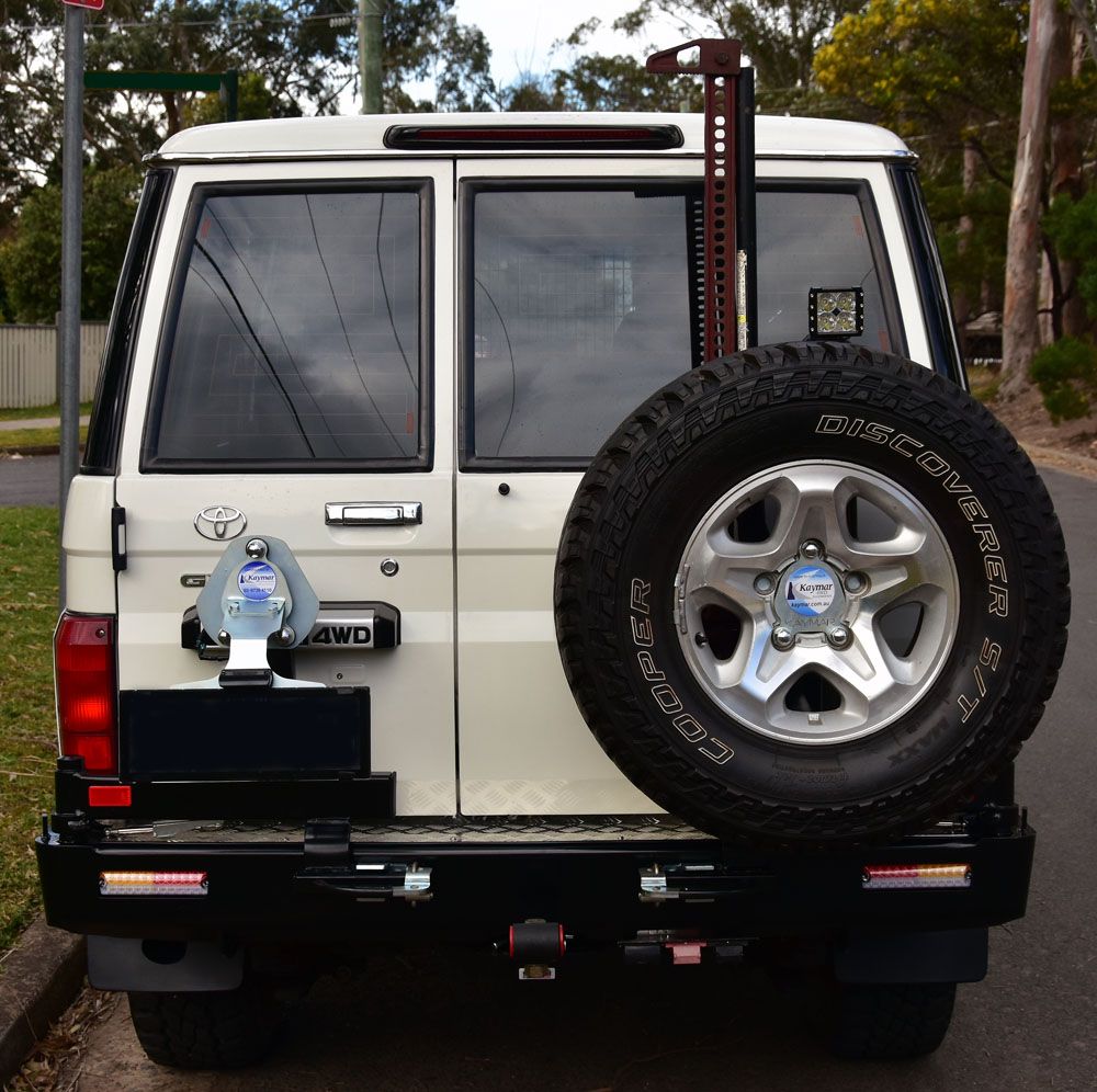

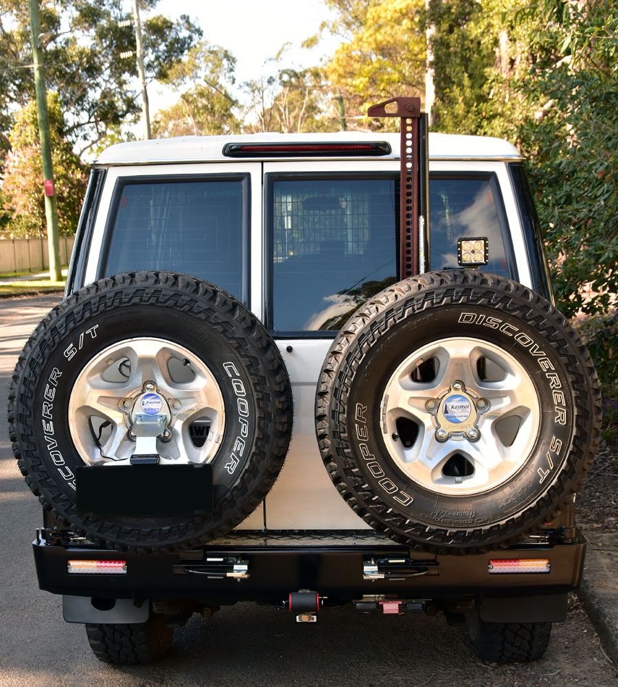

    Last week I got my truck back having had the back bar/dual wheel carriers fitted up, probably the single most expensive job I will do !! Still only wearing one spare as I am going to change the alloy pretty rims out for some black steel jobs, but when I do I need to buy eight of them (six for the truck and two for the trailer), so it is a little away. Till then the registration plate (blacked out) is hanging out the back like a fin on a 50s Caddy.

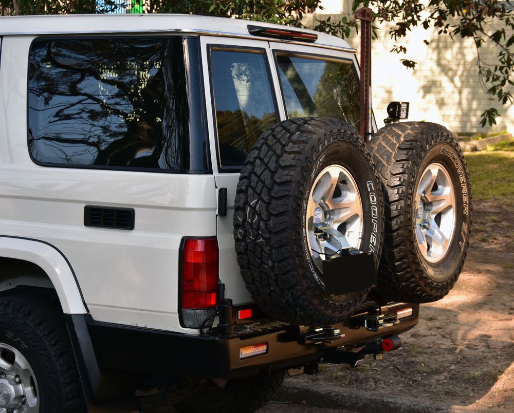

    Rear on..
    [​IMG][/URL

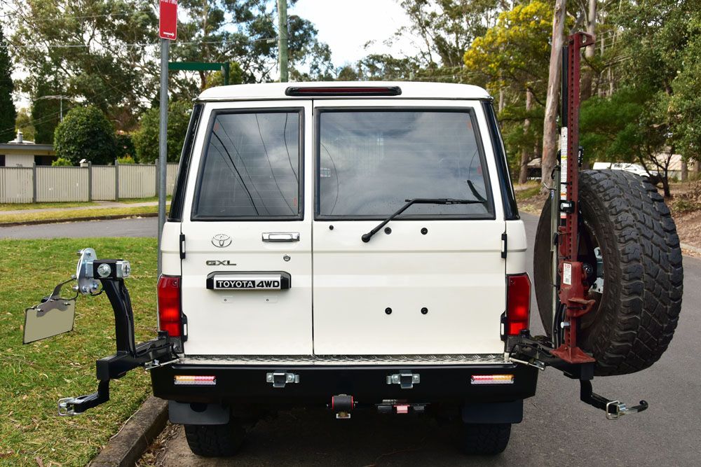

    Driver’s side
    [​IMG][/URL
    Passenger side …
    [​IMG][/URL

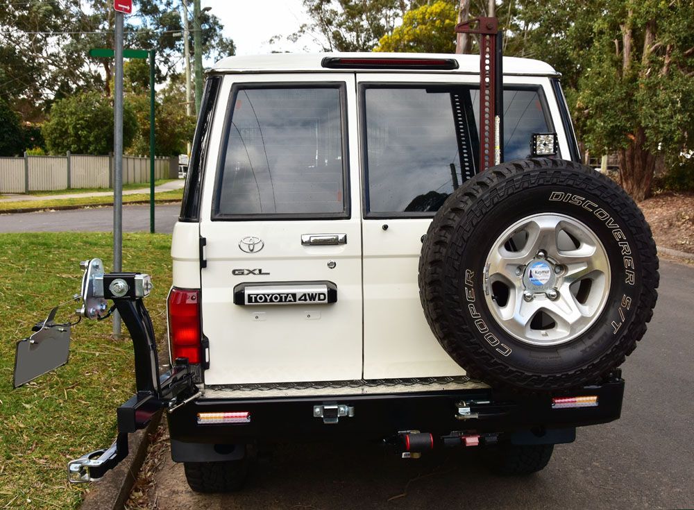

    Passenger side open…
    [​IMG][/URL
    Both open ….
    [​IMG][/URL

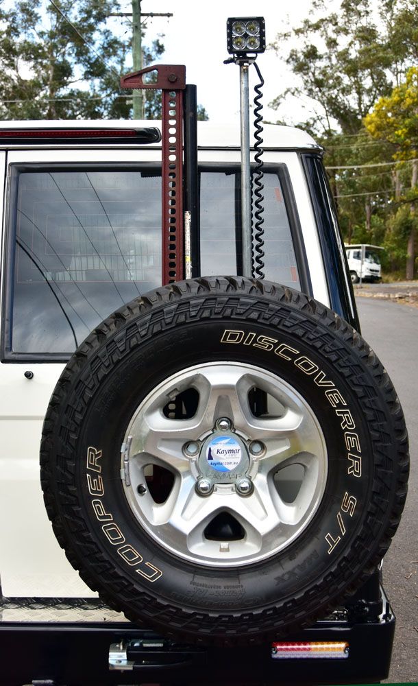

    Lamp extended up (it turns as well)…
    [​IMG][/URL

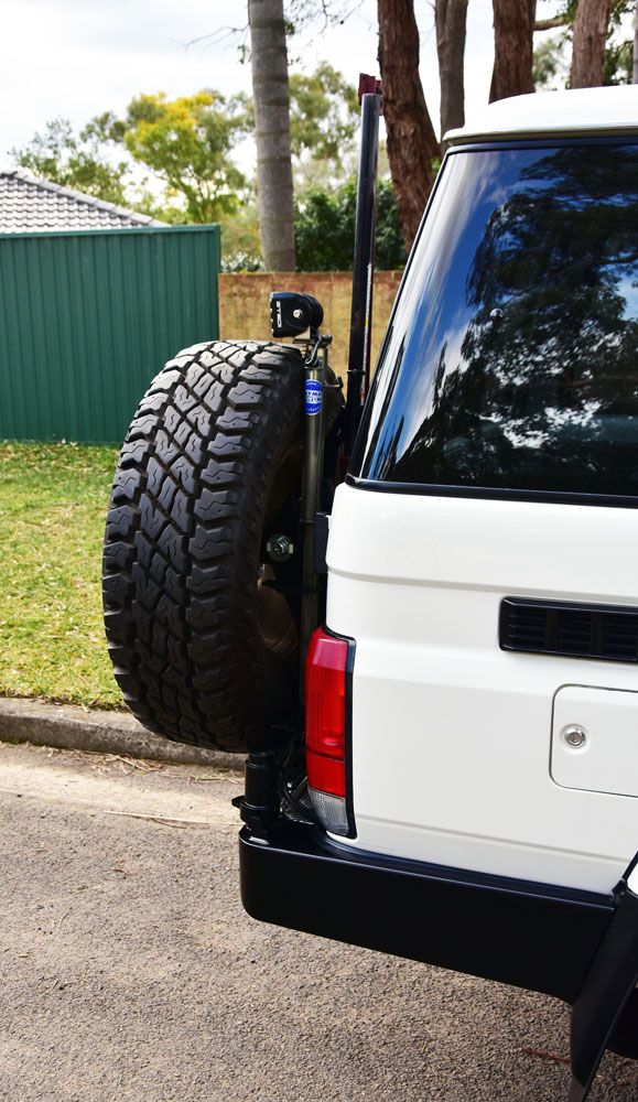

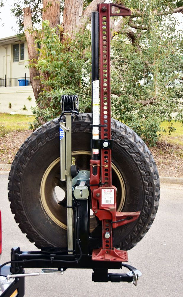

    Back of the driver’s side carrier showing the jack mount etc (added some cable ties to the jack to reduce some rattle)…
    [​IMG][/URL
    I am about 90% happy with this now. I still want to do some tidying up of the wiring for the LED lamp, the bracket for this came from my old truck and I replaced the wiring/switches and lamp unit (old one was about 12 and while LED, was only about ½ as bright at this for around the same size). The lamp is available to turn on from a waterproof switch behind the wheel or a dash switch.
    I also need to tidy up the mounts for the trailer plug and 12V power outlets under the back. They all work well but I can get them further under and better presented with not much effort. A job for another weekend however.
    Both swing arms are on gas struts that open them once you release the over-centre levers, they are strong enough to swing that driver’s side one out and slightly uphill even with the additional weight it carries, there are also manual lock to hold them in the open position.

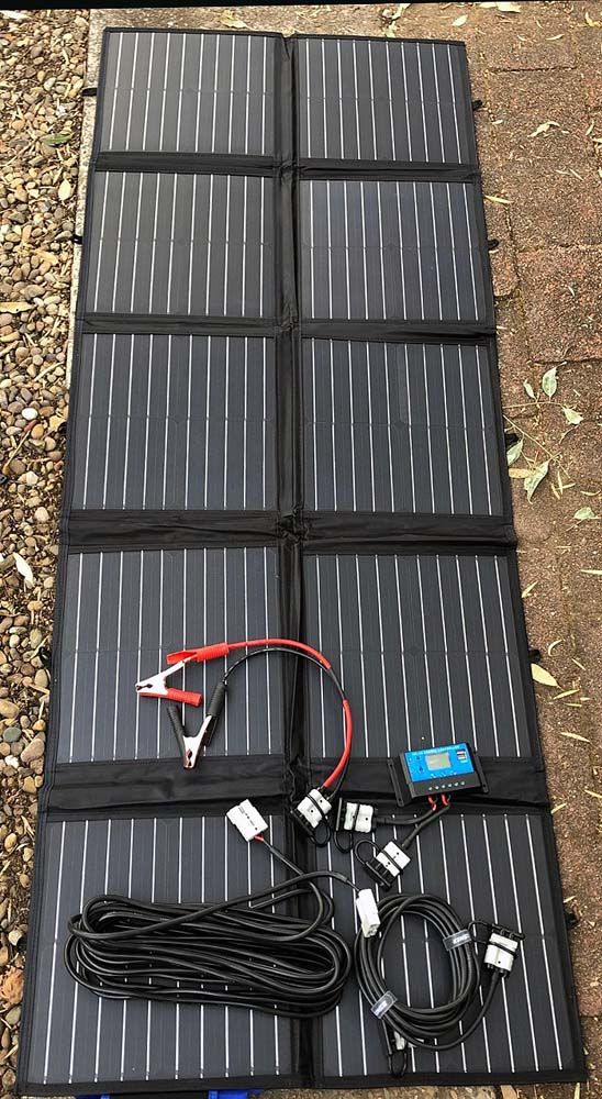

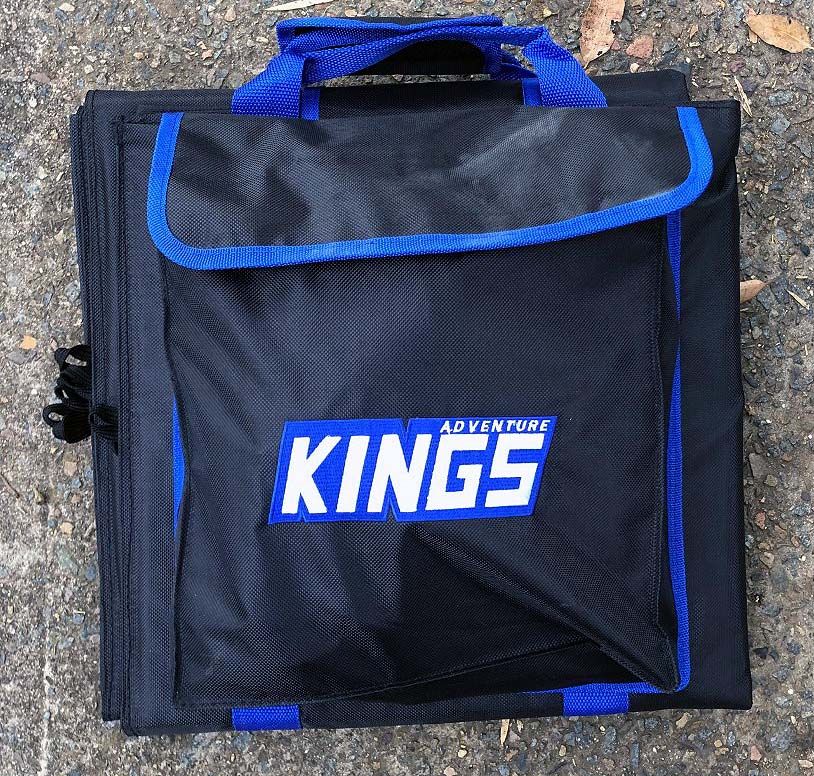

    Also grabbed a 200w folding solar blanket that I can set up to plug directly into the battery controller so if I am parked up and using 12v power (fridge/lighting etc) it will keep both batteries at capacity ...:D
    duane, 3M-TA3, Motomom34 and 4 others like this.

  8. Motomom34
    Have you used this yet? Does it perform as a expected? I looked and this specific solar blanket seems to be an Australian product. I could not find it for sale in the US. I did find some solar blankets but they were pricey. I do like how it folds into a small pouch
  9. Andy the Aussie
    I set it up and charged a small lead acid battery I had in the garage that use to be in my dirt bike (went over lithium in that). It took it from nothing to having a charge but it was a highly nontechnical test. I have not done the wiring to my truck yet to make it a direct plug and play and probably wont till late in the year (time issues). Most of the reviews on these are "OK", a solid higher quality panel will work better but a a cost of weight and space. This is purely for my mobile needs. You do need to chase the sun with them (angle them to get direct sunlight). Folding blankets are quite common here.
    Gator 45/70 and Motomom34 like this.

    Those spare tires would attract attention here. Can't see the brake lights ---- (Maybe those auxiliaries in the bumper would pass inspection, dunno.)
    Witch Doctor 01 and Gator 45/70 like this.
  13. Andy the Aussie
    .....here the LED lights in the bumper make this fully compliant with ADR, Factory turn and reverse lights are in almost the same spot, simply adding the brake lights as well. Also if you look above the rear doors you can see an additional red light bar there, that is also a brake light.
