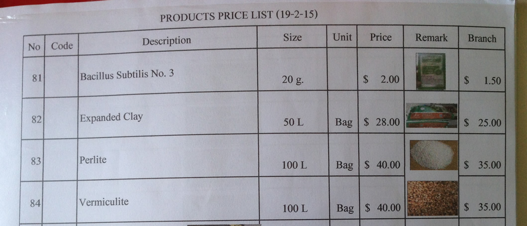

A couple months back, I got prices on both. They aren't cheap. But, both are less costly than the clay! (Prices are in USD.)
