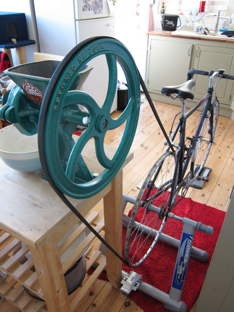

    @Motomom34 Here are some ideas to consider...no need to reinvent the grain milling wheel....;)
    upload_2017-8-2_2-10-18. [​IMG][​IMG][​IMG]
    Motomom34, Bishop and Ura-Ki like this.
  4. oil pan 4
    Or just start with a grinder that has a pulley already on it like in the above pictures.
    That right there solves most of your problems.
    chelloveck and Motomom34 like this.
