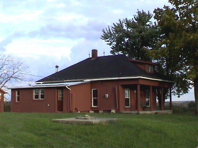

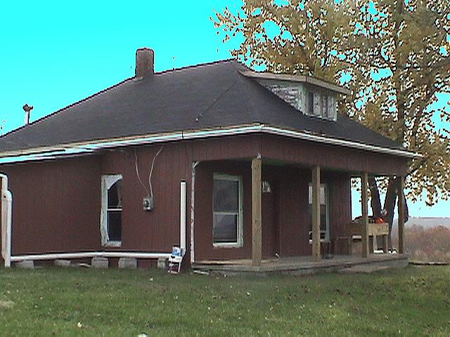

    Here's a picture of my roof washer. I used 4 inch PVC and built a U that fills with the first 55 gallons of water after that fills, the remainder of the rain goes to the cistern. If you dig on the Internet, you'll see a formula for calculating the size of the roof washer needed for a given square footage of roof.
    Here's how it looks all done:
    I have a spigot epoxied into the lowest point of the roof washer and I hooked up a garden hose to that. The water leaks out the hose such that the roof washer empties in 24 hours and resets.
  4. shaman
    shaman Monkey++
    . . . handy tips I learned the hard way
    1) Bypass the roof washer during the winter. Here in the Trans-Bluegrass, I only use it from April to November. The 4" PVC freezes and explodes. I have a second fitting that goes from the downspout straight to the cistern pipe for winter. I put coffee cans over the two ends so rain and snow don't get in.
    2) Make the U easy to detach and upend. About once a month I have to disconnect it from the downspout and tip it over. It does it's job, but by doing so it becomes filled with nasty muck.
    3) Jam some screen in the off-side end so skeeters down get in.

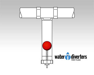

  5. kellory
    ....or. You could drill a half inch hole near the top of the roof washer, insert a half inch hose, and run that almost to the bottom of the inside, then run the other end where ever you want the water to go. It will then self-siphon every time the level reaches the top of the hose, and will stop when it reaches the bottom of the hose, without any valve that can get plugged up.:)
  6. shaman
    shaman Monkey++
    This is the touchiest part of the whole idea. I added the spigot after the original plan called for a 1/8" hole drilled at the lowest point. That clogged. The spigot and hose clogs, but I just use a pancake air compressor and blow it out. When it really clogs, I tip the whole thing over. The problem is how much gunk gets in there and how quickly it accumulates.
    Kellory: I like your idea except that siphon is going to get clogged every bit as fast as the spigot. The big problem for me is that I've got trees near the house. Spring and fall they drop gunk on the roof. Summer and Winter, it isn't a problem.
    However you end up doing it, the trick is to get the roof washer drained withing 24 hours of each rain event. This past weekend, it was clogged with maple samaras. I tipped it over and got everything out and put it back before I left camp for the week.
  7. kellory
    It will only clog, if the tank end of the hose is down in the gunk. Keep it above the sludge level.
  8. shaman
    shaman Monkey++
    Remember: the purpose of the roofwasher is to catch gunk. Even with your method, it is only a matter of time before the sludge fills the roof washer. The trick with this is having a good way to purge the water and the gunk.
  9. kellory
    Yes, but you are already dumping the gunk by pivoting it. My method gets rid of the easy to plug valve.
