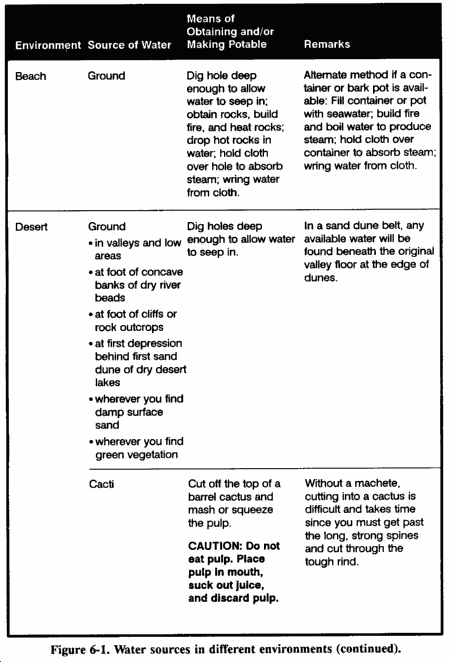

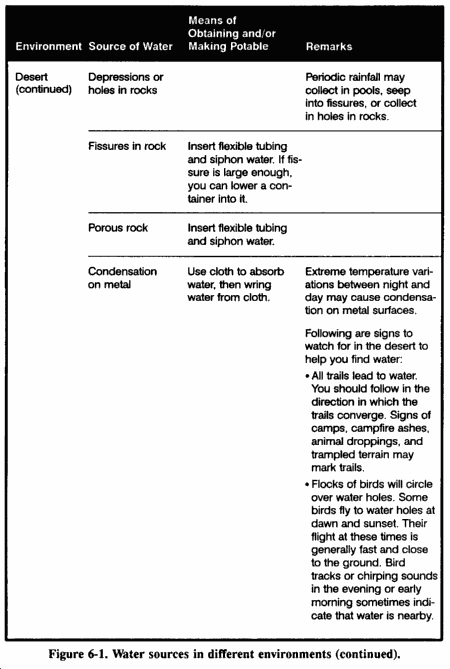

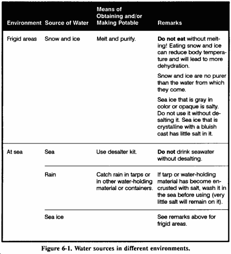

    WATER SOURCES
    WATER SOURCES
    Almost any environment has water present to some degree. Figure 6-1 lists possible sources of water in various environments. It also provides information on how to make the water potable.
    Note: If you do not have a canteen, a cup, a can, or other type of container, improvise one from plastic or water-resistant cloth. Shape the plastic or cloth into a bowl by pleating it. Use pins or other suitable items--even your hands--to hold the pleats.
    If you do not have a reliable source to replenish your water supply, stay alert for ways in which your environment can help you.

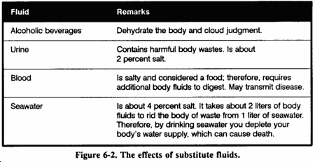

    CAUTION
    Do not substitute the fluids listed in Figure 6-2 for water.​

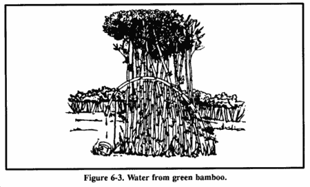

    Green bamboo thickets are an excellent source of fresh water. Water from green bamboo is clear and odorless. To get the water, bend a green bamboo stalk, tie it down, and cut off the top (Figure 6-3). The water will drip freely during the night. Old, cracked bamboo may contain water.
    CAUTION
    Purify the water before drinking it.​

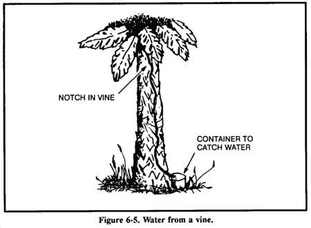

    Some tropical vines can give you water. Cut a notch in the vine as high as you can reach, then cut the vine off close to the ground. Catch the dropping liquid in a container or in your mouth (Figure 6-5).
    CAUTION
    Do not drink the liquid if it is sticky, milky, or bitter tasting.​
