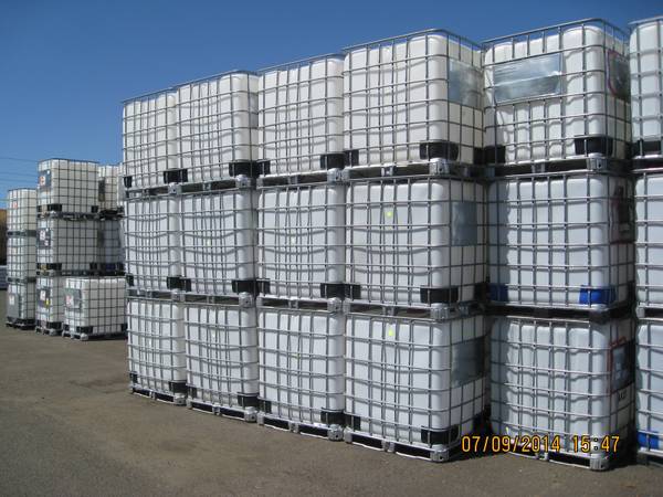

    Those are EXACTLY, what I have been "Giving Away" to my locals, for a few years, now.... They are Food Grade Plastic, with Aluminum Cages, and a Hard Plastic, or Aluminum Base. I have 30 of them in the North 40, right now, but a local Outfit has committed to come pick them ALL up, and haul them away, later this month.... These make GREAT Water Storage Systems, and the Outlet Pipe, after then Valve is 1 1/2" NPT and can be connected up with a simple Coupling, or Union....
  4. 3M-TA3
    Since you can't physically access the inside, how do you clean them out to prepare them for potable water storage?

    Ours come filled with a Dextrose Solution we use in the Fish Egg (Caviar) Production... So we just wash them out with water, and then let the folks that want them, deal with any other stuff that they think they need. I usually just tell them to fill them with Hi Chlorine Concentration Water a few times, and drain.... That seems to be good enough for us....

    You can get a 275 gallon tote for about the price of three waterBOB, so if you have the room this is probably a better way to go. Properly cleaned and shaded you should be able to store water up to 10 years. For apartment and townhouse owners, the waterBOB may be the only option.

    I have four IBC containers, 275 gallons each, daisy-chained in my basement to the water supply. The IBC's cost me around $125 each, I picked them up with my pickup truck so no delivery. I did have to clean them out, which wasn't hard.
    Having them gives me 1100 gallons of water extra storage in my home.
    I also have one in the guest house and two in the shop.

    I have 2 IBC containers sitting in my back yard right now. They will be used for rain water collection (as soon as I install my gutters). I plan on making a cement pad then building a deck to raise the containers up a few feet. I will plumb them together to use the water for my garden, non-potable uses, and potable after filtering/cleaning.
    I can get 3 or 4 more totes as well. My wife works for a yeast making plant and the totes contained HFC (High Fructose Corn Syrup) and/or "defoaming" agents. I also got 2 metal barrels that had HFC to use as burn barrels.
