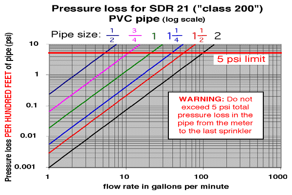

    We need to first understand the fundamental requirements before leaping to solutions.
    You have only a 55 gallon storage tank. Sounds like the water is for washing so consumption is low, say 5 gal a day, that reasonable? Would spending 15-20 min once a week to refill the tank be acceptable to you? If those assumptions are in the ballpark, then you need a pump to flow 2-3 gallon per minute.
    Let's now estimate the pressure needed from that pump. The lift is 10-15 feet, let's use worst case and say 15, that equates to about 7 psi. Let's estimate pressure drop over 150 feet to get from stream to cabin. Consult the flow curves for say 1 inch ID pipe/tubing:
    So for 2.5 gal/min we have about .1 psi pressure drop and that would be about .15 for 150 feet, not much.
    So, just figure 8 psi for fittings, elbows, setting the tank a bit higher etc.
    Now we know we need a pump that can flow 2-3 gal/min at a pressure of 8 psi or better. If we can spread the filling over hours, we can use a much smaller pump. If we use more water than 5 gals per day, then we need to fill more often.

    This will hopefully provide some guidance as to just what is needed and you can redo the math for differing assumptions or situations. Have fun.
    AT
