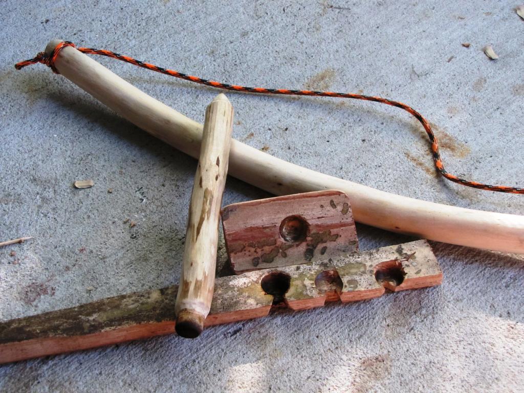

    Two weeks ago my son Nick and I ventured into the Florida scrub with the intent of producing an ember using material from the Florida state tree The Sabal palm. We watched a video of Gundog5 entitled "Bow Drill fire-All Sabal Palm Success". My son said "hey that looks easy I wanna try that" I looked at him and thought to myself "easy my a$$".
    Now you see I have never been successful in making fire with the bow drill cause i never really persued it. It always seemed to me like a waste of energy and it was easier to use a Flint & steel, ferro rod, matches or my favorite a Bic lighter. Well, my attitude changed after seeing my son struggle with the bow drill three weeks ago. I felt that I needed to learn this after my son failed and became angry that it didn't work and that it was useless and a waste of time.
    I recall that it was a very humid day 'cause it had rained the day before. So I deduced that everthing we found had some moisture content in it. I went back and researched the web at all the bow drill instructions and videos till I was practically blind lol. There's alot of good info out there BTW.

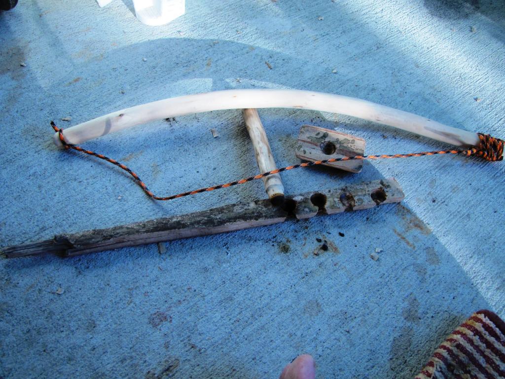

    Well I went out and found some really dry Sabal palm fronds and some dried Brazilian Pepper tree limbs. My plan was to use the Brazilian pepper as a drill and Bow & sabal palm for the hearth and handhold. I found a piece of Brazilian pepper with a nice shallow bend and fashioned it using 550 paracord for the bow string. A straight piece of it became the spindle.
    I made a handhold of dry Sabal palm boot and the hearth was a piece of really dry palm frond. My first attempt was a failure after numerous attempts. I took a breather (I was breathless and my old knees were cramped up).
    After a 20 min respite I made another divot and notch and gave it a go. I cranked that bow till I almost collapsed and Viola there was a waft of smoke coming from that pile of dust. I almost passed out...I could'nt believe it! MY FIRST EMBER WITH A BOW DRILL!! ESTATIC isn't the word, Happy, Happy, Happy is more like it! At 61 years of age I felt like a youngster with his first real knife!

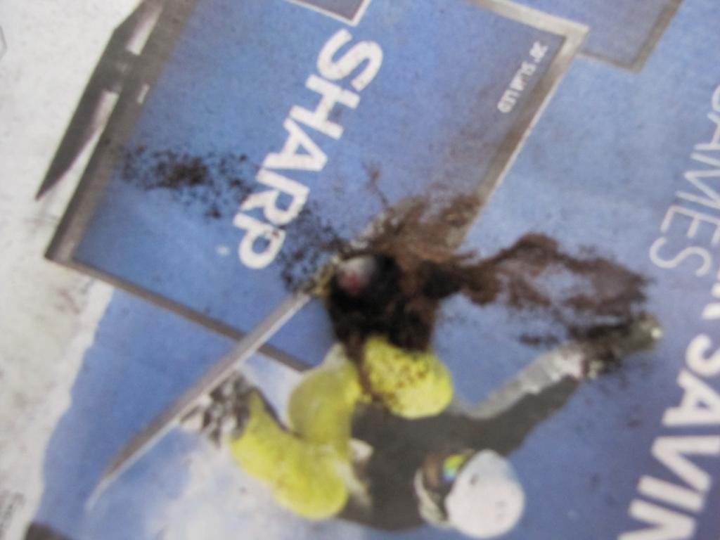

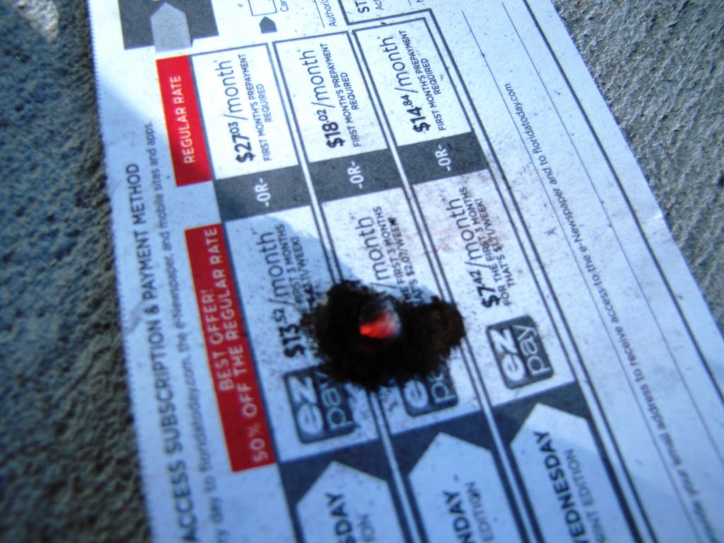

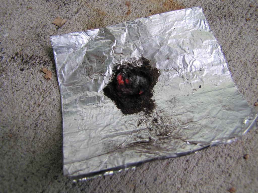

    So far I've been successful at 3 attempts after that first intial success! I have some pix to share...sorry I was solo so I have no pix showing the actual work, only pix of the embers (3 different ones)... some are blurry as I had noodle arms after generating tremendous energy, whew!
    [​IMG] My first ember.
    [​IMG] My second ember.
    [​IMG] My third ember.
    [​IMG] My Drill set.
    Definitely not a preferred method but nonetheless a method good to know...I can scratch this off my Bucket List now. But I will practice it the rest of my life!
    Thanx for looking!
    Dom
