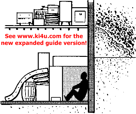

    What stops radiation, and thus shields your family, is simply putting mass between them and the radiation source. Like police body armor stopping bullets, mass stops (absorbs) radiation. The thicker and heavier the mass, the more radiation it stops, and the more effective it is with every inch more you add to your fallout shelter. The thickness in inches needed to cut the radiation down to only 1/10th of its initial intensity for different common materials is: Steel 3.3", concrete 11", earth 16", water 24", wood 38". The thickness required to stop 99% of the radiation is: 5" of steel, 16" of solid brick or hollow concrete blocks filled with mortar or sand, 2 feet of packed earth or 3 feet if loose, 3 feet of water. (BTW, lead is nothing special, same as anything else pound for pound.) You may not have enough steel available, but anything you do have will have mass and can be used to add to your shielding - it just takes more thickness of lighter wood or books, for example, than heavier earth, to absorb and stop the same amount of radiation. Increasing the distance between your family inside and the radiation outside also reduces the radiation intensity.
    The goals of your family fallout shelter are:
      • To maximize the distance away from the fallout 'dusting' outside on the ground, roof and trees.
      • To place sufficient mass between your family and the fallout to absorb the deadly radiation
      • To make the shelter tolerable to stay in while the radiation subsides with every passing hour

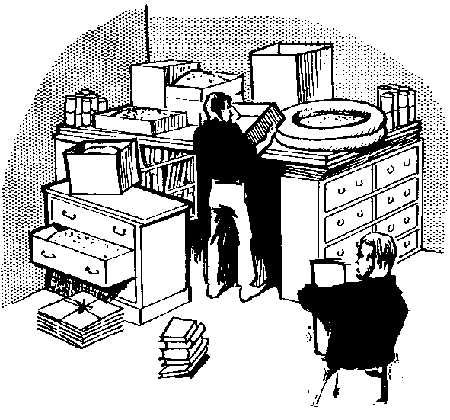

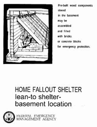

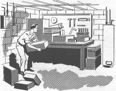

    If you have a basement in your home, or at a nearby relatives' or friends' house that you can use, your best option is probably to fortify and use it, unless you have ready access to a better structure nearby.
    For an expedient last-minute basement shelter, push a heavy table that you can get under into the corner that has the soil highest on the outside. The ground level outside ideally needs to be above the top of the table shelter inside. If no heavy table is available, you can take internal doors off their hinges and lay them on supports to create your 'table'. Then pile any available mass atop and around the other two open sides such as books, cordwood, bricks, sandbags, heavy appliances, full file cabinets, full water containers, your food stocks, even boxes and pillow cases full of anything heavy, like earth. Everything you can pile up and around it has mass that will help absorb and stop more radiation from penetrating inside - the heavier the better. However, be sure to reinforce your table and supports so you do not overload it and risk collapse.
    Leave a small crawl-through entrance and more mass there that can be easily pulled in after you, but with a gap at the top to allow exhaust air out. Have another gap of 4-6" square low at the other end for incoming fresh air. Make bigger if crowded and/or hotter climate. A small piece of cardboard can help fan fresh air in if the natural rising warmer air convection current needs an assist moving the air along. This incoming air won't need to be filtered if the basement has been reasonably sealed up, however any windows or other openings will require some solid mass coverage to assure they stay sealed and to provide additional shielding protection for the basement. More details on this in the next (#6) section.
    With more time, materials, and carpentry or masonry skills, you could even construct a more formal fallout shelter, such as the FEMA lean-to on the right, but you will need to assure structural integrity is achieved and adequate mass is utilized.
    An effective fallout shelter constructed in a basement may reduce your radiation exposure 100-200+ fold. Thus, if the initial radiation intensity outside was 500 R/hr (fatal in one hour), the basement shelter occupants might only experience 5 R/hr or even less, which is survivable, as the radiation intensity will be decreasing with every passing hour.
    Adding mass on the floor above your chosen basement corner, and outside against the walls opposite your shelter, will also increase your shielding protection. Every inch thicker adds up to more effective life-saving radiation shielding.
    As cramped as that table space fallout shelter might seem, the vital shielding provided by simply moving some mass into place could be the difference between exposure to a lethal dose of radiation and the survival of your family.
