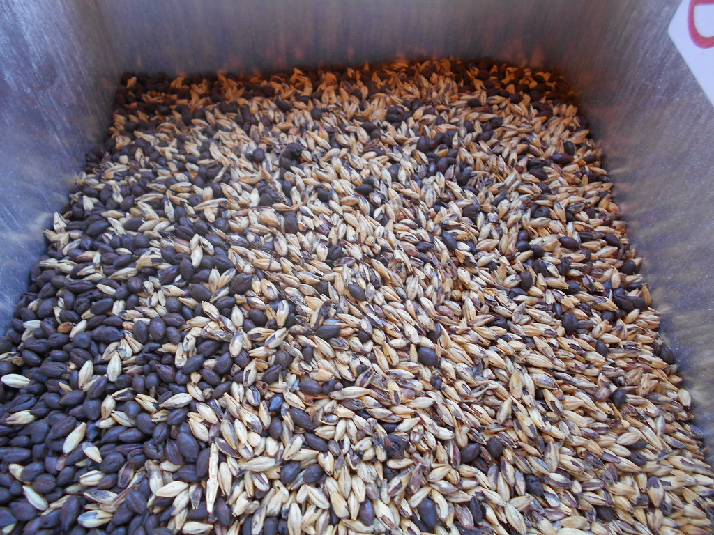

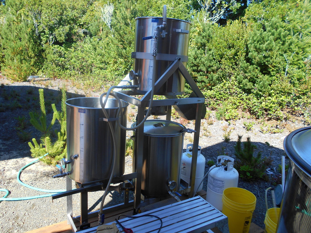

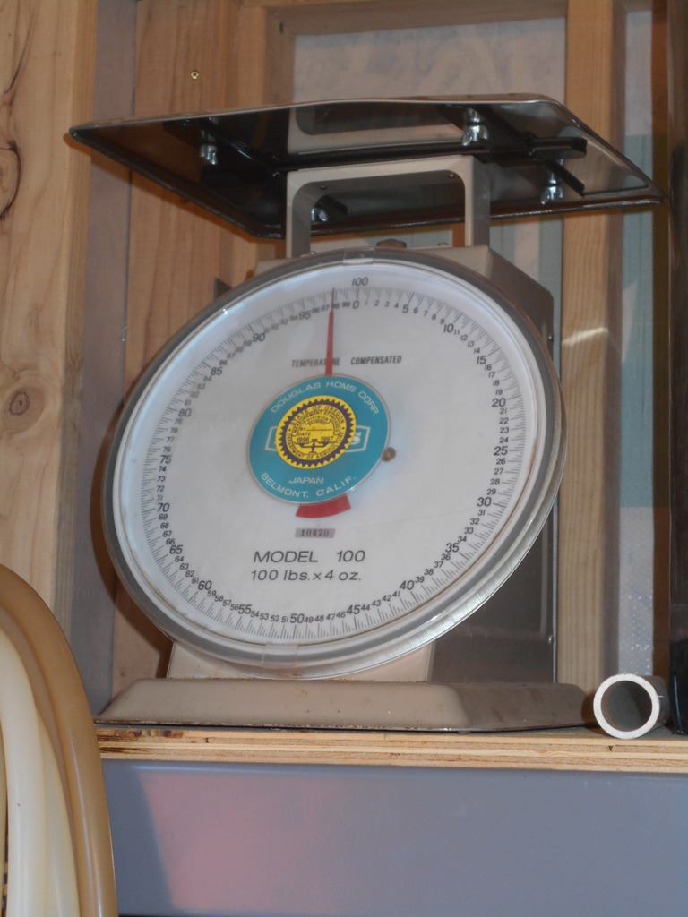

    Here we go.... Heated 7 gallons of water in the mash tun (that is the upper most kettle) to 168 degrees and filled the hot liquor tank (lower right kettle) and heated to 180.

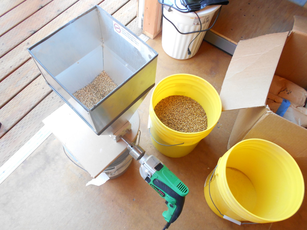

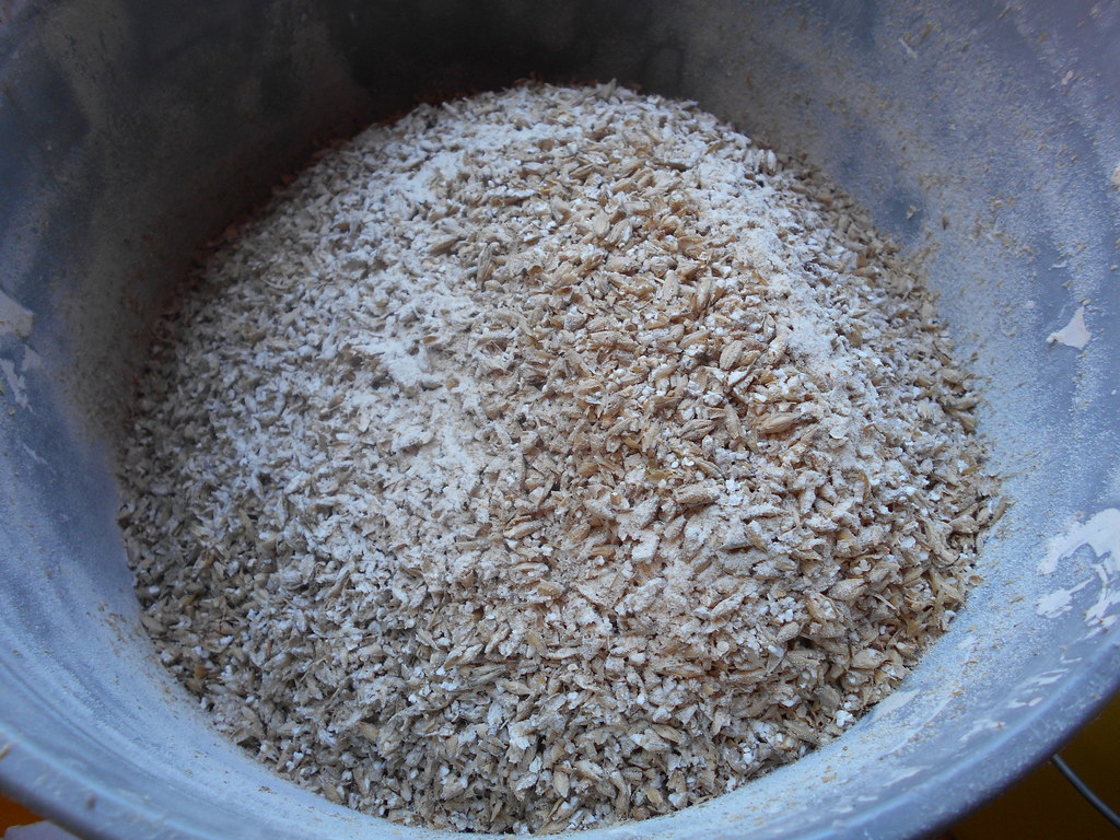

    weighed the grains according to the grain bill...
    then began crushing the malts...

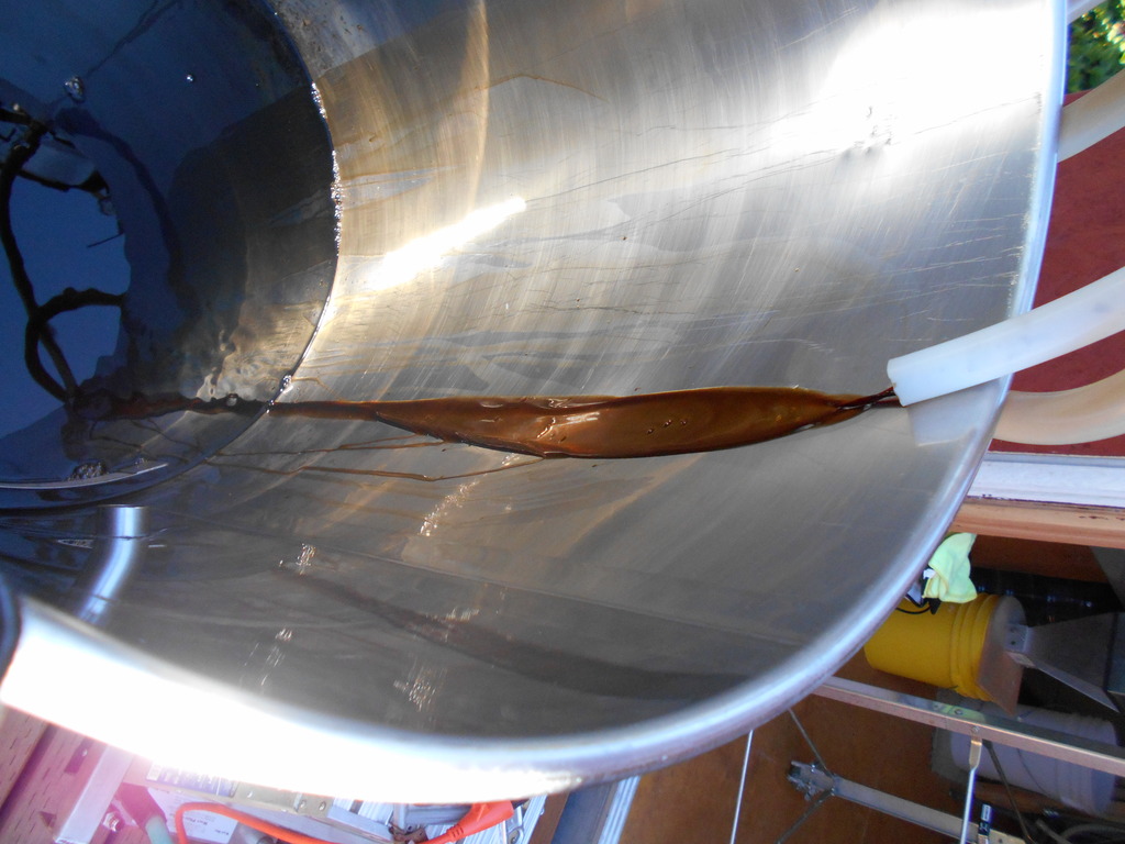

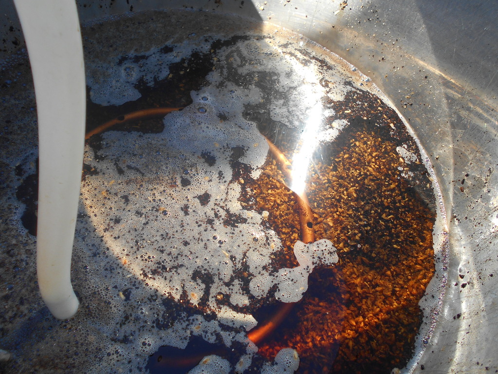

  8. Dunerunner

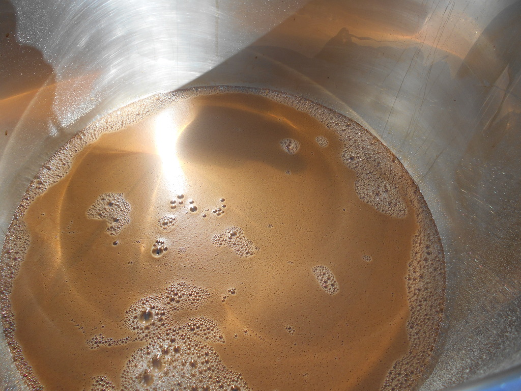

    Mash at 150 degrees for an hour...
    Sparge (rinse the sugars out of the grains).. runoff goes into the boil kettle. It looked like motor oil but smelled of roasted malt.

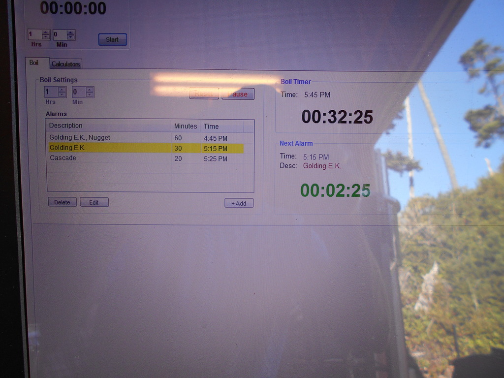

    After the sparge, we boil for an hour, during which hops are added at specific intervals..

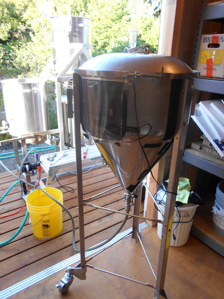

    Very slow airlock activity this morning, fermenter at 68 degrees, so I raised the temperature controller to 70. that brought on the heater instead of the air conditioner....
    As big as this beer is, I expected some lag in fermentation.

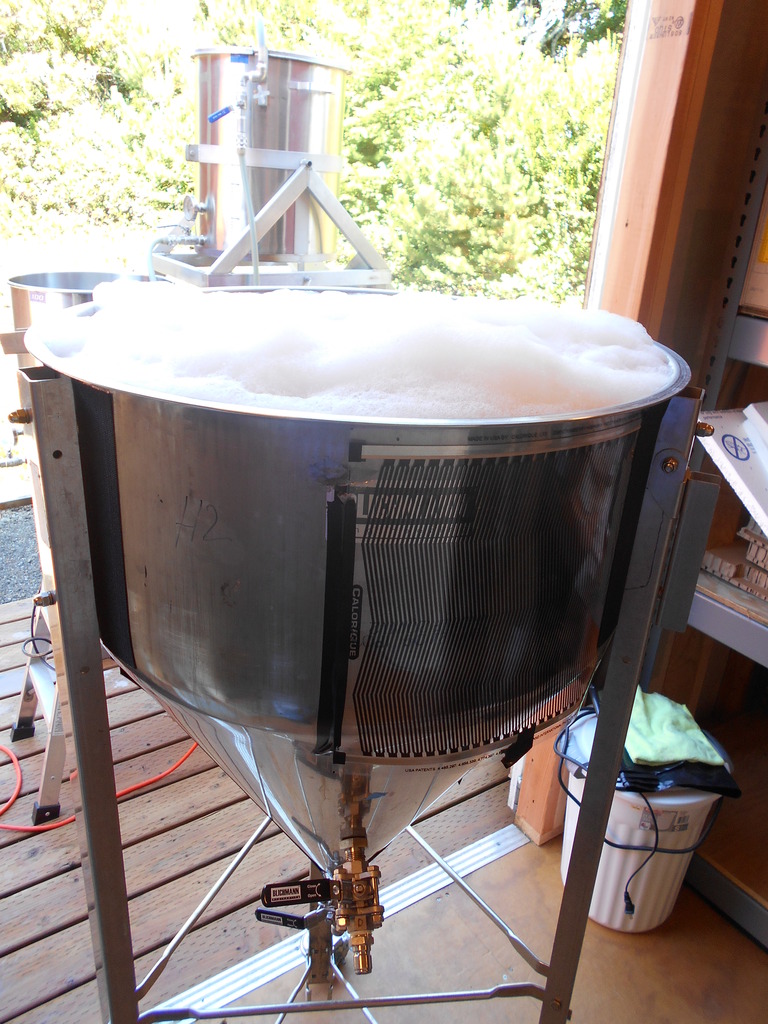

  14. Dunerunner
    so, here we are a few days into fermentation and it is time for me to start thinking about what to do with this beer. It has gone from being a Sweet Stout (by style) to an Imperial Stout due to the 10+% estimated FG (Final Gravity). I have a 10 gallon whiskey barrel.... Maybe I'll flush it with some 170 degree water and let the beer sit in the barrel for a few months and age.
    Then, what to do after that....
    Carb and Bottle it?
    Rack to a carboy and add vanilla and coco nibs? (done this before with amazing results)
    Rack to a carboy and add cold pressed espresso? (which will lower the ABV)
  15. Dunerunner
    So I just checked on fermentation and the Nottingham yeast has quit. This happens with high gravity beers. I boosted the fermentation room to 75 degrees and pitched a vile of WLP-099, a high gravity yeast with a high alcohol tolerance. We'll see if that gets things going tomorrow morning and if so, I'll back off the FV temperature to 68. The 75 isn't going to hurt the cider three days into fermentation, so I'm not worried about esters from the yeast there, nor in the Stout as there it won't even be noticed.

  20. Dunerunner
    Just got out of the brew shed, and there is moderate activity at the airlock this morning. Leaving the temp at 75 until I check it again this afternoon. The vile of WLP-099 is intended to inoculate 5 gallons of beer, and I dumped it into 10 or 12. We'll have to see what happens.
    Thank God this is a 10 gallon batch and not a commercial 10 barrel (310 gallon) batch....
