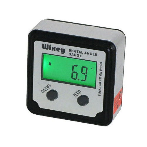

    Next is to adjust the angle of the guides. There are etched angles on the base, but these are only approximate since they depend on the knife width and the actual blade height. I use a digital gauge by Wixey ($25 on Amazon) for this instead. I zero it to the base and then measure with the angle on the stone. When I have the angle set where I want it I simply tighten doen the base.

    Forgot to add to the original post, The Wixey WR300. Inexpensive (about $25 on Amazon) and easy to use. Turn it on, set it on a reference surface and press zero. You are all set to measure angles. The magnetic base sticks to the WE stones making angle adjustment a snap. Also very useful for other purposes!
