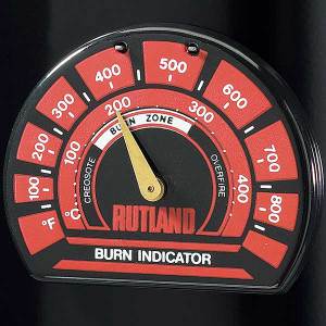

    I have a bi-metallic Weksler thermometer that will read to 550, so I held it in contact with the top of the unit after a stable burn was happening, it hit just over 400, and yes, the accuracy is debatable. Later, after throttling back on the overfire air, I was able to hold 350 pretty well. And, no, top of stove temp is not related very well to the stack temps. Which brings up the question: Once upon a time, I was told that one should hold at least 350 in the chimney to keep creosote from non-existent to minimal. I had fire in the stove long enough to get the stack to equilibrium, but have no idea what the actual temp was in the lining nor the smoke pipe above the stove. Opinion requested, fpg.

    You need one of these with a magnetic base on the pipe

  8. ghrit
    Got one today.
