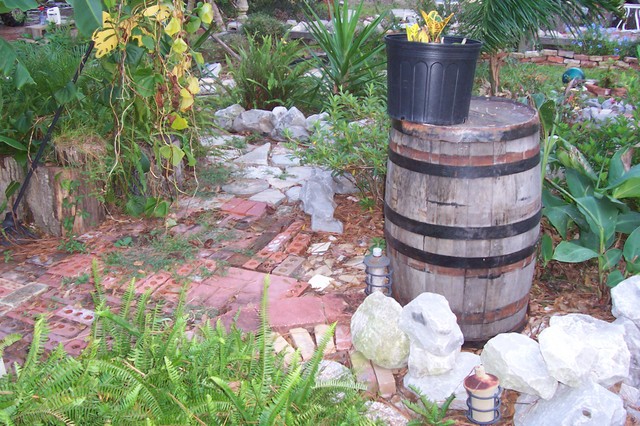

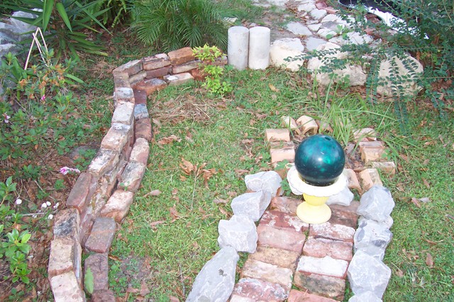

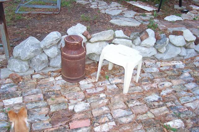

    i don't really know .i know i have a few diferent types of fire bricks in my yard. some are so old they are like a shale type of rock and they are very light in weight . let me up load some pictures these bricks came from chimenies out of houses way before they came out with that ceramic stuff. these bricks are the real thing. i know the stuff your talking about though. i got all these bricks out the dump from people taking down them old slave houses and 150 year old shot gun houses.
    any ways here's the pictures .these bricks are antiques i have alot of money laying around in my yard. there is alot more i have a 1/2 acre yard and 90% is bricked. i got all my land scapeing stuff from the dump.lol

    Those bricks look indentical to a kiln I tore apart. They were the outside brick of the kiln. The inside of the kiln was lined with the actual fire bricks which were extremely light and fragile.
    I know one can buy fire brick still...spendy stuff.

    your right but very few of them are the outside bricks most are the inside bricks they are very light compared to a regular brick and if you drop them forget it they will splinter up. they are good to walk on but they can't take any kinda force impact.i have about 3000 of the fire bricks for the inside and a few hundre for the outside.i'll snap a picture of the two side by side.
