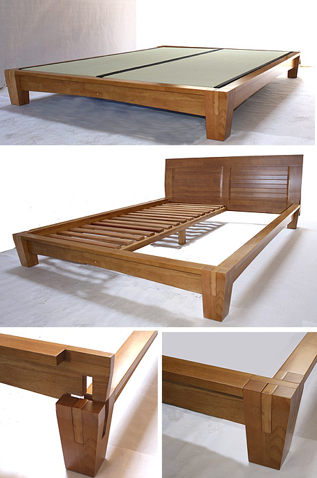

    Below is the simple version of the above Japanese bedframe made using no nails.
    I'm wondering if this simpler style below could be adapted for a move able compost pile app 4' x 4'
    If I did the Same thing on the bottom will it make the main posts too weak?
    My goal is to just move the compost pile every year so I'm moving it around the garden in my planting rotation.
    If I can't get this to work I may have to add more key hole gardens.
    Right now I just nail the boards up and move the pile each year but if I can get something that slides together it would make composting easier.
    Any thoughts or ideas?
    Any ideas or thoughts

    You do not need a solid wall, correct? Slats would do?
  3. kellory
    Leave the thinner cross pieces raised slightly, and add a corresponding crossed notch to the bottom of the square posts. This will allow them to be stacked securely. Like leggos.
  4. kellory
    [​IMG] This will not have a lot of strength, though. Keep this in mind. The hooked pieces are thin, and will break with the grain. It is designed to have strength straight down.
    I would suggest more of a split rail fence design.
    With four corner posts bypass cut like this corner post. It could remain mobile.

    I would say yes, it will make it weaker especially when you start putting lateral pressure on it from the compost. As Kellory stated above, the posts will split along that vertical line as you add more compost and it gets wetter. Add sun/rain/weather/bugs and you won't get that many seasons out of it.
    Now what you could do is miter out the bottom boards to 45 degrees and attach hinges to two of them to connect them. Attach a hasp and lock at opposite ends of the exterior boards to where you latch them together. You would have two halves of your square that would connect and lock. Leave the top as it's pictured, but place the bottom boards on the outside of the post. You would have a gap, but not much to mention.
    Just an idea
  6. kellory
    What I use for puppies is similar in concept to what you just described. I have several board sections all connected with hinges. Pull the pins. And they fall apart. Reassembly is just dropping hinge pins in holes.use as many sections or as few as you need.
