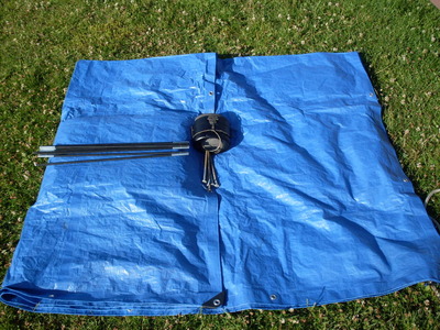

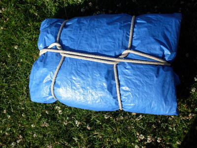

    Items seen in Capstone project images -
    Tarp, blue, 8 x 10
    Blanket, 100% wool *5.5 pound surplus blanket)
    Long John, polypro, 1 set
    Nylon wind suit - 1 set
    Ground cover - trash bags and windshield sunscreen
    (Not seen - cap, gloves, wool socks)

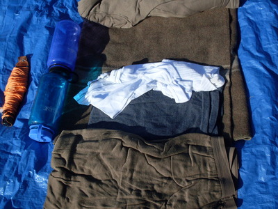

    [​IMG] [​IMG]
    Ground cover on the cheap >>>>>>>>>>>>>>>>>>>>> This tarp is big enough for an adult!

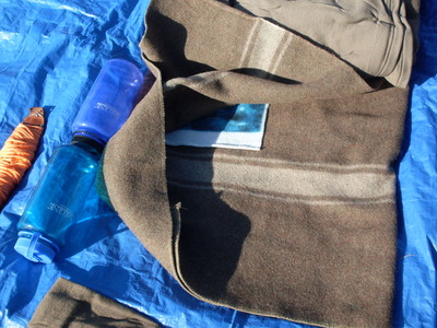

    [​IMG] [​IMG]
    Ground cover stowed >>>>>>>>>>>>>>>>>>>>>>>>>wool blanket with polypro panel

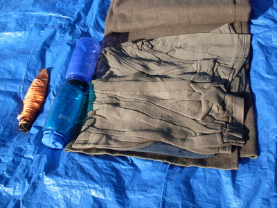

    [​IMG] [​IMG]
    Clothing (drawers) inside of blanket >>>>>>>>>>>>>>>>>>>>>>>>>>>>>>polypro layer

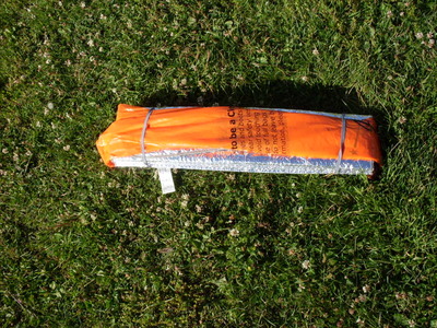

    [​IMG] [​IMG]
    partly wrapped up >>>>>>>>>>>>>>>>>>>>>>>>>>>>>>>>> chow kit, this is covered much more a bit later
    Yukon ruck disaster kit rolled up and ready for the closet.

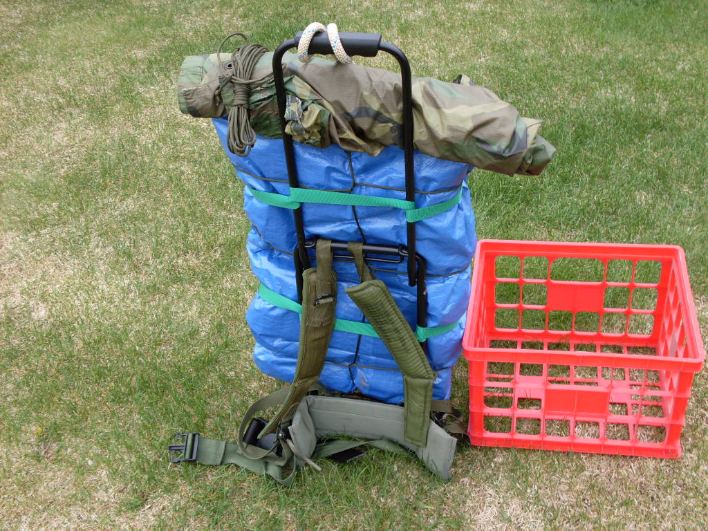

  10. DKR
    std shower curtain under a USgi poncho
    Carry that Yukon ruck on a cheap $2 GROJ sale luggage cart. The doggie straps from an LC-2 ALICE frame fit like they were made for it. Find the box. Ignore it and think Outside of it.....

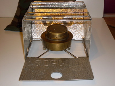

    For this DIY kit, I will first recommend a Sterno brand folding stove. It folds flat, will easily support a large pot and is easy to light and snuff. Because it burns gelled alcohol, may be used safely indoors with minimal care taken for ventilation. One large (7 oz) can of fuel is rated by the vendor to burn for two hours. The small can (2.6 oz) burns for 45 minutes. At ten minutes to boil two cups of water indoors, you should be able to produce (about) 24 cups of hot water before the first can is used up.
    The shelf life of this canned fuel is phenomenal. Years ago, a friend gave me a can of Sterno fuel dated 1947 - I've burned it several times since to demonstrate that properly stored, the shelf life of this product is outstanding.
    Another good choice for cooking is a Trangia brand alcohol stove (burner). Heat output is the same or slightly hotter than the Sterno brand product. The Trangia burner may be used with the Sterno stove as shown above. Trangia sells engineered cook kits incorporating the burner, but these can be costly to buy as a system.
    Alcohol burners are safe to use indoors with proper ventilation, the only caution I have is that alcohol burns with an almost invisible blue flame. A fuel spill is a concern, the alcohol may still be burning, yet the flame unseen. If any fuel is spilled, absent an ignition source, it will evaporate quickly and leave no residue or offensive order. Fuel may be obtained at the local gas station in the form of the yellow bottle of HEET brand fuel antifreeze. Alcohol sold as a paint thinner is also a good stove fuel.

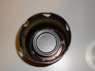

    Tin can stove
    Don't want to spend money on a stove that will sit in a kit unused? Okay, a Sterno folding stove does sell for 5 to 9 US dollars, the fuel, about four US dollars for a large can. Any food can of a diameter large enough to hold the fuel container may be pressed into service as a pot holder for your fuel. (See photo at end of document)
    The holes in the sides were made with a common can opener, the cooking cup is held by two short sections of coat hanger wire. The holes for the wires were made with a small drill bit.
    The only critical measurement is to ensure the top of the fuel can is 32mm to 38mm (1.25 to 1.5 inches) from the top edge of your pot support. DO NOT use gasoline or kerosene in this or any alcohol stove. This stove can be used with regular pots by setting the fuel can on top of the support wires.

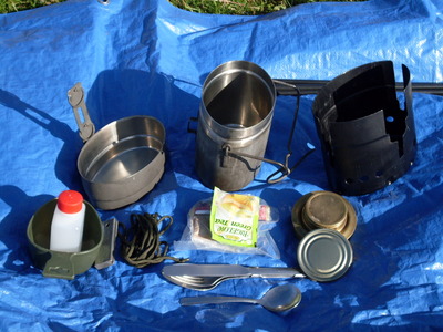

    [​IMG] [​IMG]
    Tin can stove - small Sterno on bottom, tin cup on top.
    Folding Sterno stove with military Trangia burner.
    Close up of modified Esbit Stove - the spokes and side plates allow use of nearly any pot or cup
    Swede stainless steel cook kit with Trangia burner. You know you want one. I have Bund utensil set plus a soup spoon. The soup can top is a snuffer for the alcohol stove. The fuel bottle sitting in the cup hold ~3 oz.
    Pretty slick.

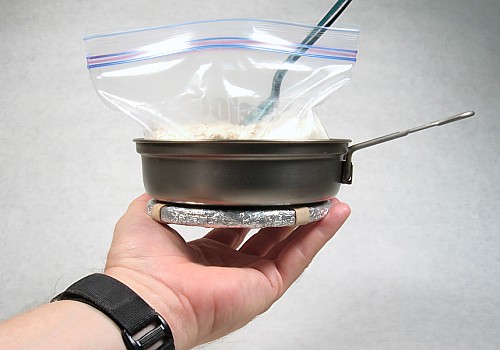

    To reduce clean up, wet items can be both heated in a water bath and served in a Ziplock sandwich bag used as a liner. This bag can then be can be held by a bowl or a cardboard ring. Doing this will reduce your clean up tasks. Parboiled rice and oatmeal only need hot water, stews and other canned food may be (carefully) heated in the opened can using a water bath, the water being saved for washing up after your meal.

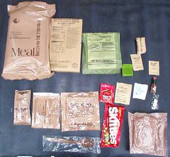

    Why no MREs? Those are good enough for the Army!
    You are correct. Each MRE retails for about 8 dollars, or about 25 dollars a day. You can do better - cost wise. You can certainly plan the evening meal around a single MRE and know you will go to bed with a full tummy and likely have some leftovers to eat the next day.
    (H/T to MREInfo.com, for all knowledge for MREs.)
    Canned food? That stuff weighs a ton! Why would you suggest canned food?
    This is a DIY disaster kit, not something you would use for crossing the high Sierras on foot. Canned food makes sense if you will be traveling by automobile - I'm sure most of us would prefer that over walking. Canned food (also called wet pack) normally doesn't require additional water to cook, is normally part of everyone's diet and are lower cost than MREs or freeze dry foods.
    Why would I pick an MRE over a nice freeze dried meal?
    Rarely is a back-packer 'meal' a full meal, normally FD food is sold as an 'entree'. A popular brand of FD food, like Beef Stroganoff, is lightweight and tasty. Add two cups of boiling water and you have -- a bit over two cups of beef stroganoff. You gain a mere 500 calories.
    With a single MRE, you get a lot more - for a couple of dollars above the cost of that freeze dried entree, if that much more. Open that funky brown plastic bag and you'll find:
    Entree - the main course, such as meatloaf
    Side dish - lots of choices here, rice, corn, fruit, or mashed potatoes, etc. These are available separately of you wish to build your own custom menus.
    Cracker or Bread choice - tortillas even!
    Spread - peanut butter, jelly, or cheese spread. Yum.
    Dessert - a cake or cookie choice.
    Candy - normally a commercial product, in some cases, not even repackaged.
    Beverages - coffee, tea, sport drinks and so on.
    Hot sauce or seasoning are found in some menu choices
    Flameless Ration Heater - if you don't have a stove or don't want the hassle of a stove, these work pretty well, with MRE packaged items.
    Accessories - spoon, matches, creamer, sugar, salt, chewing gum, toilet paper, etc.
