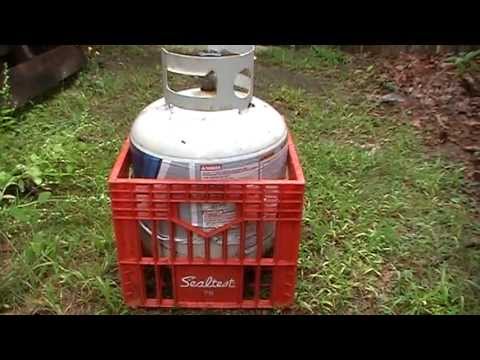

  10. stg58
    And by the way we transport and use our 20&30# tanks like this the crate adds a lot of stability and are easy to secure in the trucks.
    Cheap also:)
