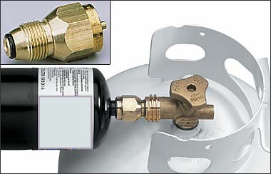

    [​IMG] First thing, though, you need to purchase one of these little adapters from Mr. Heater or one of their distributors.
    I got mine at Joe’s (which was G.I. Joe’s when I was a kid, and actually sold military surplus gear, but I digress). Cabela’s sells a similar item called the Mac Coupler, and it’s worthwhile to read the negative reviews on their site.
    The negative reviews, which are by far the minority, describe some of the difficulties people experience using this adapter. This can be helpful, because there are a few tricks to refilling these cylinders. To obtain the best results, it helps to understand a little bit about how propane works.

    First you will need a propane tank refill adapter from Mr.Heater also called Mac Coupler. They are easy available on the Internet on Ebay or on the Cabela's Web Site.

    #1 Plug the refill adapter on the big tank FIRST
    #2 Screw the little thank on the adapter.
    #3 Flip the tank over like on the picture.
    #4 Open the valve. The instruction say to let in open for 1 minute but you will hear the flow of propane stop after 30-40 seconds. When the sound of the flow stop, close the valve.
    #5 Flip over again the big tank and remove the little one of the adapter. Some propane will escape from the adapter during this process.
