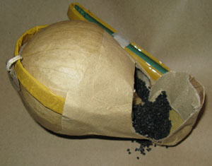

    Have you ever taken the covering off of the bottom of an aerial shell and observed the black granules which are used as the shell's "lift powder?"
    [​IMG] Black Powder Used As Shell Lift Powder

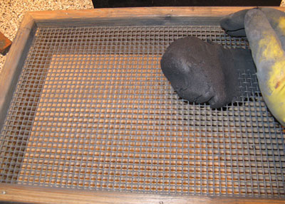

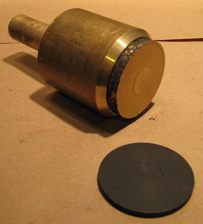

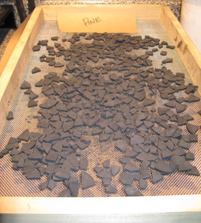

    I take 16 ounces of the pine charcoal mill-dust, add 1.6 ounces of water (10%) to it, and thoroughly incorporate the water into the powder with my gloved hands. Then I further incorporate the water with a screen colander. I press 1/8" thick pucks with that powder. I have found that if I apply about 1600 psi of pressure on the pucks when I press them, that they are as solidly consolidated as they are going to get. I put the finished pucks into the drying chamber to dry.
    I do the same with 16 ounces of the commercial charcoal mill-dust.
    (I have found that it is quite easy to break the pucks up a bit by hand while they are still damp. This makes it easier to granulate them later on.)

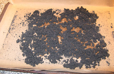

    <table> <tbody><tr> <td> [​IMG] </td> <td> [​IMG] </td> </tr> </tbody></table> Plain and Black Powder Coated Rice Hulls

    Processing black powder pucks (see how to granulate black powder pucks in Fireworks Tips #93.)
    With the pine charcoal pucks, I end up with 10.7 ounces of the 2FA, and 1.75 ounces of the 3FA. (In reality, commercial 2FA powder contains grains from 4 to 12 mesh, but my 2FA consists of only the coarser grains.)
    With the commercial charcoal pucks, I ended up with 10.15 oz. of 2FA powder, and 2.05 ounces of 3FA.

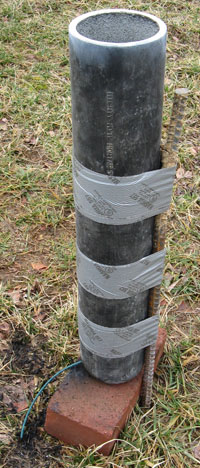

    I have my 12 different types of black powder sitting in front of me. Now I'll test them in various amounts, lifting dummy shells, to compare their relative performances, and to find out exactly how much of each of them to use when lifting an actual fireworks shell.

    For my tests, I'm using a one-piece, HDPE (high-density polyethylene) "gun." Whichever gun you use, it is a good idea to use the same mortar for all of the comparison shots. This will minimize variations from one test to another.
    On page 140 of The Best of AFN II (BAFN II) are some charts showing recommended BP lift amounts for various types and sizes of shells. Table 1 indicates that, for lifting a 3" ball shell, 0.6 oz. of FFg, or 0.75 oz. of 2FA would be appropriate amounts of commercial lift powder.
    And, on Page 17 of the PGI's Display Fireworks Operator Certification Study Guide, one can find a nifty table that shows the typical (desired) heights that various size fireworks shells ascend to before bursting. This table shows that a 3" fireworks shell would rise to about 300 feet and then burst.
    That's good information to have. Using about 0.6 to 0.75 ounces of my Wano BP ought to send one of my baseballs up to about 300 feet. I can weigh that amount, drop it down into the bottom of a 3" mortar, insert 4" of visco into the fuse hole at the bottom, drop a baseball into the gun, and light 'er up.
    [​IMG] 3" Mortar Loaded and Ready for "Bear"
    But, how do I know if the ball actually ascends to 300 feet before it peaks out (at apogee) and starts to descend? One simple physics equation is all that is necessary to figger that out. If you drop an object and time its descent to the ground, the distance the object has fallen, in feet, is given by the equation, Distance = 16 x time x time (16 x time squared), when the time is measured in seconds.
    For example, if I fire my baseball, and start a stopwatch when its flight peaks out at apogee, and then stop the stopwatch when the ball hits the ground, I'll be able to read the time it took the ball to fall to the ground from that peak. Let's say that my stopwatch indicates a time-of-fall of 4.18 seconds.
    [​IMG] Timing the Fall of a Dummy Shell
    To see how high the baseball was when it started to fall (at apogee), all I have to do is multiply 16 x 4.18 x 4.18 and I get a height of 279.55 feet. That's pretty close to my desired 300 feet. So I know that using the amount of lift powder that I used, or maybe just a tad more, would be a good quantity of that BP to use in the future for this size and weight shell.
    This is what I'll be attempting to determine with each of the 12 experimental powders. Once I know those amounts for each powder, I'll then be able to compare their relative powers with each other. I'll tabulate that info and have some very useful results and conclusions. Just what I was looking for to begin with.

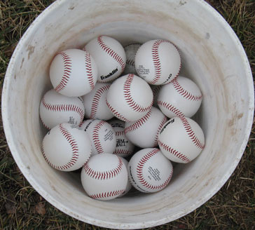

    So, I go out to my shoot site with my lovely assistant and all my testing materials: BP's, scale, spoon, paper cups, notebook, pen, baseballs, mortars, visco, anvil-cutter (I never cut fuses with scissors, only with razor blade anvil-cutters), chairs, table, stopwatches, sunglasses, camera, re-bar, and duct tape.
    <table> <tbody><tr> <td> [​IMG] </td> <td> [​IMG] </td> </tr> </tbody></table> My Lovely Assistant, Ready to Take the Field, and the Ammo
    No, she didn't really try to catch the balls. She had to man (woman) one of the stopwatches instead.
    The mortar was taped to a piece of rebar driven into the ground, angled away from us, and the ammunition was prepared. I had previously drilled a small fuse hole near the bottom of the mortar.

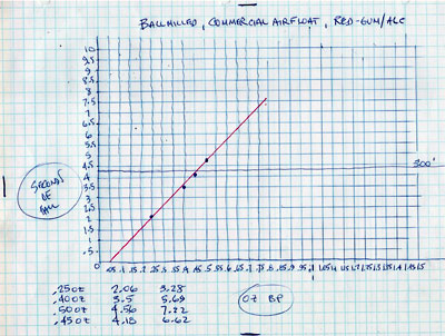

    I had prepared some charts in advance to take notes for each powder test. The vertical axis represents the time of fall in seconds, and the horizontal axis represents ounces of black powder in 0.05 ounce increments. I drew a horizontal line at 4.33 seconds since that time of fall represents a height of 300 ft., which is what I'm shootin' for.
    [​IMG] One of My Hand-Plotted Graphs
    Then, it was just a matter of starting to fire baseballs with measured amounts of one of the experimental BP's, such as the one in the above chart: ball-milled, commercial charcoal, alcohol/red-gum granulated. We used two stopwatches, recording the total time of flight, and the time of fall from the apogee to the ground.
    Judging the exact apex of the flight can be a bit tricky, since there is a second before the apogee where the flight up really slows down, and there is also a bit of time after the apogee before the ball really starts to pick up speed. But, we just did the best we could. It's probably a bit more accurate to use a time that is 2/3 of the total flight time, from lift to landing.
    [​IMG] Baseballs After Being Fired From the Mortar
    Warning: After each baseball firing, there may be hot sparks remaining in the mortar. I am careful to wait a bit before reloading. Then I insert the visco fuse, drop the next portion of BP in, and then carefully drop the baseball in. I avoid getting any body part over the mouth of the gun when doing this, regardless of whether I know the fuse is lit. A baseball fired at this speed could easily kill a person or remove a hand or arm.
    I wanted to start with a small amount of the powder, gradually increasing it until I started to get flights that were a bit too high. I figured that would give me the spread of data which I could use to determine the right amount of powder for a 300’ high flight. The following is a listing of the amounts of this one particular powder that I used, and the resulting flight times that we recorded.
    Ball milled, commercial charcoal, red-gum/alcohol granulation
    <table colspan="0"> <tbody><tr> <td style="border-bottom: 1px solid rgb(0, 0, 0);">Amount of BP </td> <td style="border-bottom: 1px solid rgb(0, 0, 0);">Time from apogee to ground </td> <td style="border-bottom: 1px solid rgb(0, 0, 0);">Total flight time</td> </tr> <tr> <td>0.25 oz.</td> <td>2.06 seconds</td> <td>3.28 seconds</td> </tr> <tr> <td>0.40 oz.</td> <td>3.50 seconds</td> <td>5.69 seconds</td> </tr> <tr> <td>0.50 oz.</td> <td>4.56 seconds</td> <td>7.22 seconds</td> </tr> <tr> <td>0.45 oz.</td> <td>4.18 seconds</td> <td>6.62 seconds</td> </tr> </tbody></table>

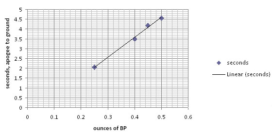

    Below is a computer-generated graph of the data above.
    [​IMG] Ball-Milled, Commercial Charcoal BP, Red-Gum/Alcohol Granulation
    When these coordinates were entered into the graph, a couple of things became obvious. There is a linear relationship between the amount of lift powder that is used, and the corresponding flight time.
    This graphed line, if extended down to the bottom of the chart, points to an amount of BP which would not even get the ball out of the gun, about 0.05 ounce in this case.
    That graphed line crosses the 4.33 seconds/300' line, between 0.45 and 0.5 ounces of the BP.
    Indeed, when the average time from apogee to the ground, is divided by the average total flight-time, the time from apogee to ground is about 2/3 of the total flight time from lift to landing.
    With this powder, I'd use 0.5 oz. to reliably lift a 3" ball to 300'.

    To me, the simply-screened, red-gum/alcohol method looks like the method-of-choice for simple, field-expedient, very functional black powder, and it can be produced without any complex or expensive machinery. This method is ideal for the beginning fireworker.
