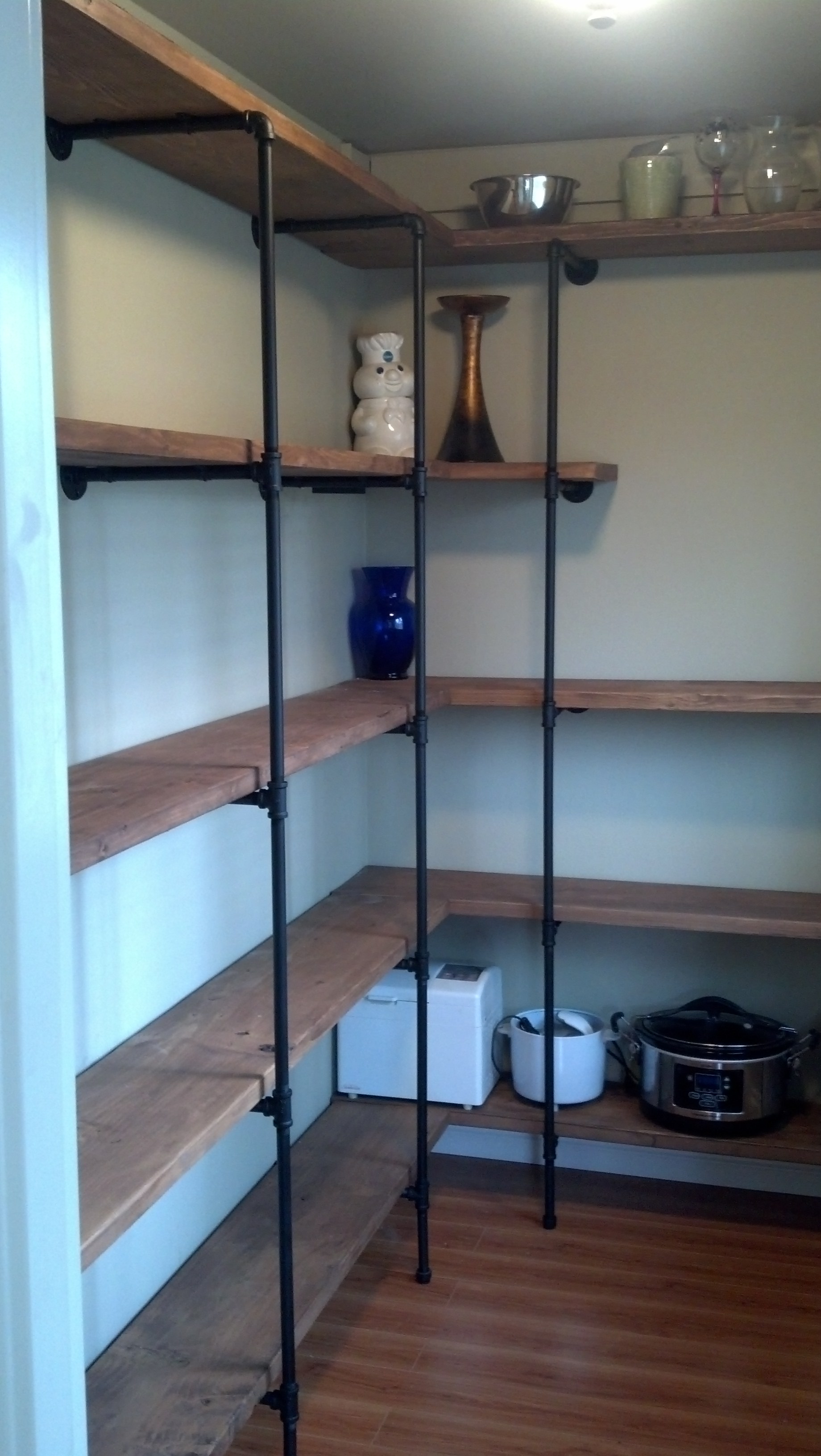

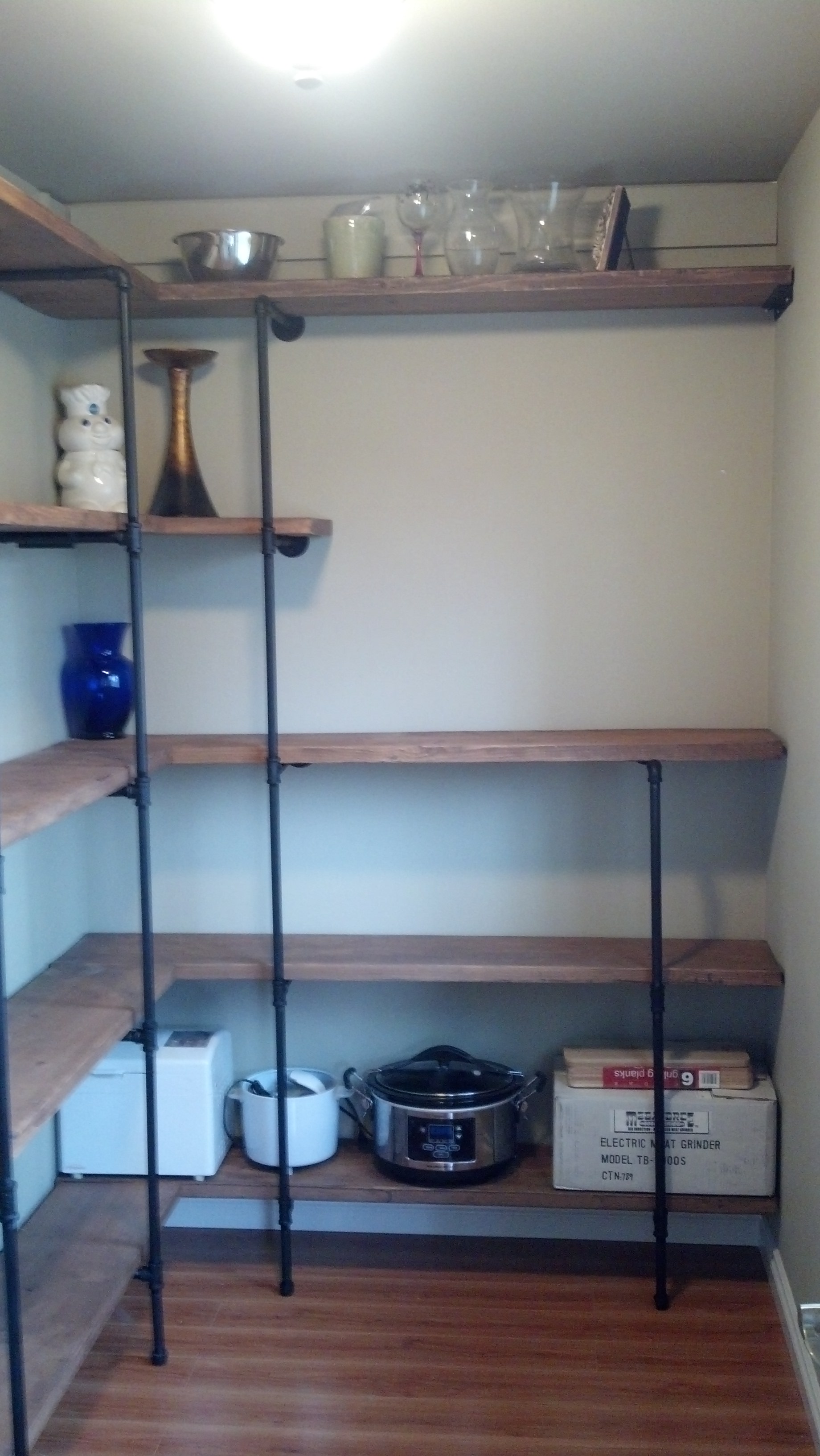

    Last year I remodeled our pantry based off of some pic the Mrs handed me. Built with 2X10's and threaded half inch rigid pipe. I stripped and painted all of the pipe and we stained the boards. The pipe pieces add up in cost and may not fall in line with the threads "cheap" aspect, but easy yes, when you have a plan.

    I have to say, I have never seen anything like that before @Yard Dart
    Very interesting.

    When you have pipe, what a great way to use it!

    very nice clean look,yard dart.....strong too....i also use 2x12's

    I love those shelves YD. Saw some similar on Pinterest but I think I like yours better.
    I'm so glad you posted that yard dart. I've been looking at those for a year wondering how they would hold can goods. They seem sturdy how are they working?

    They look GREAT DW. Hell of an idea that I plan on shamelessly bogarting:D
    Yeah well, that's what guys do-take advantage of ya whenever we can-at least that's what I keep telling my 3 daughters;)
    VERY NICELY DONE DW!
    Very nice YD! I've seen this done in a couple of different shops over the years, but none of them looked nearly as nice as yours.:)

    If I did it over, I would have added shorter vertical segments.... but I was a little concerned about the weight of two or three extra shelves plus product. The unit is solid as a rock though and anchored to the wall properly. I had to remove the bottom leg pieces last week to change the floor out and the whole unit remained fixed in place with just the horizontal members for a few days.
    Just as a side note, this is not my primary storage area but the main pantry for our general house foods and other storage.... I have some heavy duty shelving stuff elsewhere for the can storage and so on.... ;)

    Thank you.... I used 12-inch horizontal sections and with the flange and tee-section... it only allowed for a 10 inch wide board to seat properly.
