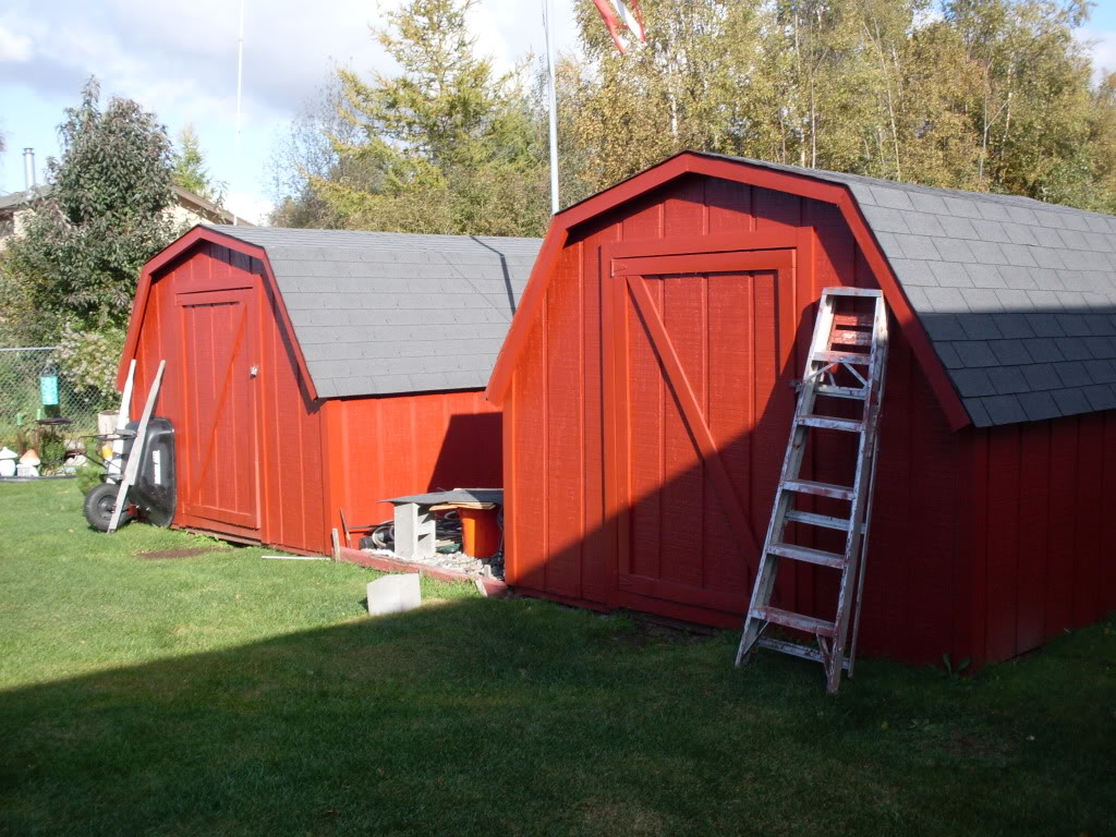

    How about this instead -
    (found a better image)
    10 wide by 12 deep with a loft of about 100 sq ft and standing headroom top and bottom. The loft nearly doubles the inside space with the same footprint (and property tax free status). Sleeping on top, living space below.
    A smaller version w/o loft will use less material -[​IMG]
    These have over 6 feet of standing headroom @120 sq ft. 4 foot side walls and gambled roof.
    Lets begin
    The platform is 10 x 12 made of 2x6 pressure treated lumber. The floor is 3/4 plywood over a layer of...3/4 plywood deck. It hits -20F quite often, so a thick floor can keep things warmer. Walls are straight 2x4, with top plate, skinned with cedar siding.
    from the photo - observe:
    The roof seems to the hard part for a lot of folks. You will need a chalk string, tape measure, a chop saw (best) or a Carpenter's triangle. Use string to mark center of deck; place a base 2x4 even with the 'front (right side in image) .
    Decide how 'tall you want the roof.
    Take one 2x4 stud and cut the bottom at 23 degrees.
    Cut other end at 23 degrees at the length you picked for hieght. Make a matching piece for the opposite side..
    Place first pieces on deck., second on 'top' of first. This will cross the line you marked with chalk line.
    Measure from top of first piece to chalk line.
    Now you have your measurements.
    With your first set of pieces cut, lay out out the rafter on the desk. Once it fits from outside edge to outside edge, use some scrap to build a template as shown.
    Here's the math - 2 x 23Degres = 45 degrees. And so 2 x 45 = 90. The pieces meet at the top @ 90 degrees. This takes a bit of a fiddle, but we hit the sweet spot 1st time around.
    On top of the now skinned walls, add your top plate to tie walls together
    Toe nail (or use screws like we did) put up the first rafter. We also added so-called hurricane ties.
    We put up a plywood sheet - the first part of the roof, and as we added more rafters, tied them into the ply.
    We added Masonite over R-19 fiberglass insulation, then tied the two long walls back together which makes the floor of the loft. Because we had the wood, each crosspiece was a pair of 2x4s. This allowed me to not have a lot of cross-ties on the rafters (1 x-tie at each end and one in the middle) so open, standing headroom in the loft.
    After this we put tar-paper (30 lb) and shingles.
    Loft deck is 2/4 in plywood again.
    Door was a commercial steel door, the door frames are doubled up 2x4s. Hinges are held by 3 in deck screws. No windows right now, what with long, cold nights, not much use.
    The main floor deck has a square of ceramic tiles to hold a kero heater should we have to move in.
    Hopefully this will give you some ideas - if you go to build a dual use shed (storage for now, shelter in case of need)
    Or you could buy a Costco 'garage' and set it up in case of need.
    enjoy

  9. DKR
    Tool list for shed building.
    Fairly basic --
    Tape measure
    Square
    carpenter's triangle
    chalk line
    chop saw (OMG, does this ever save time)
    Skill saw
    staple hammer (for tar-paper)
    Nail gun!!!!
    The shed posted here was screwed together. I built the the platform solo in one weekend - in between BBQ. Next weekend had all the boys (2 sons & a SIL) over and we had the shed framed (with loft floor) and skinned with the rafters up in one day. Finished the roofing (plywood, tar paper and shingles the next.
    The inside - insulation and Masonite the next Saturday.
    Helped my SIL put up his shed - 10 x 12, but we put up the chip plywood for walls, covered with tar paper then added lapstrake siding made from salvaged cedar fencing.
    The cost of a nail gun is repaid with the massive amount of time saved.
    We looked at forming a 'business' where we would help a homeowner / DIY type to plan and build a shed for themselves. After talking with a lawyer and insurance agent, we dropped those plans.

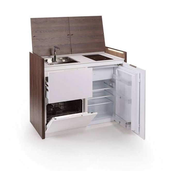

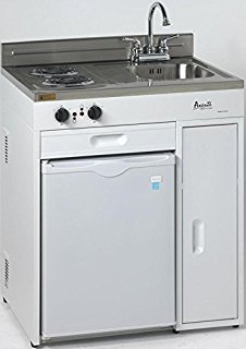

  15. DKR
    there are several version of an all-in-one compact kitchen, some have a washer/driyer combo at the cost of a very small fridge.
